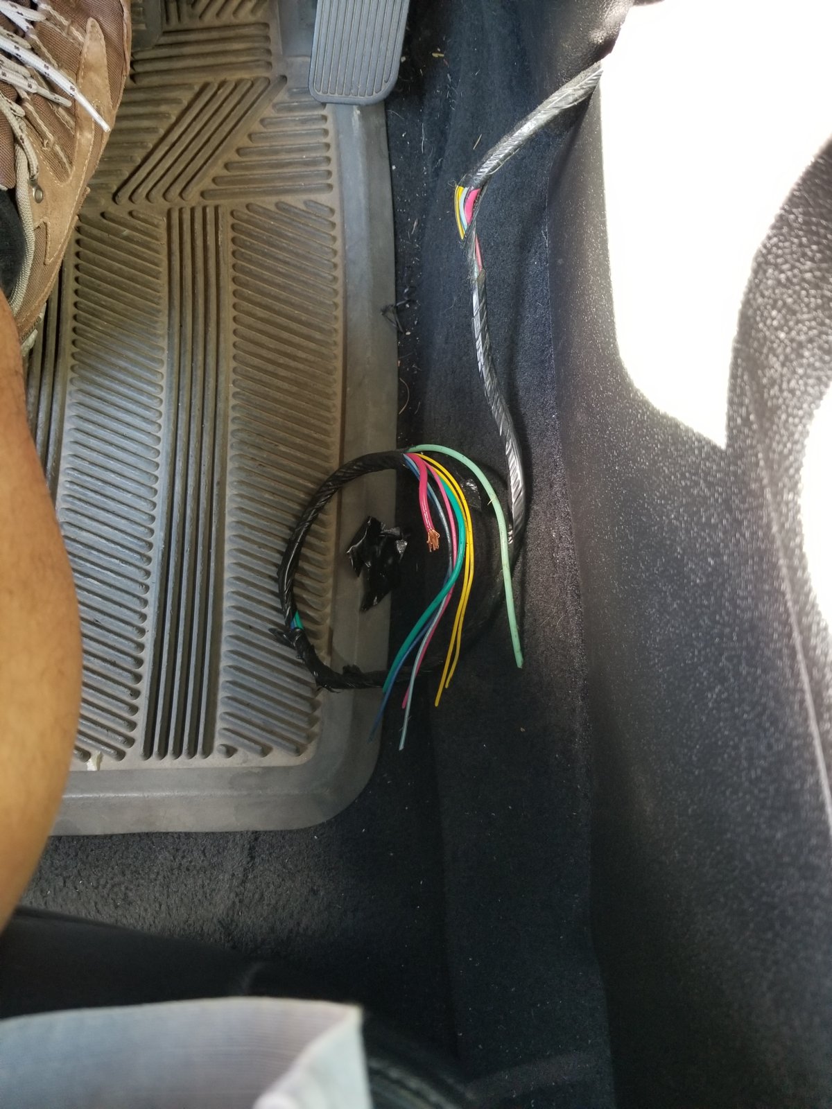

Hmm ok I guess I'll have another look am I looking for another bundle or just a single wire? Does the pic I took look familiar for what these exact wires are for as there's no label on these ones?

Oh and this pic I took was on the driver's side as well..
Those are for the speakers I believe. Just dig around the same place those wires are coming from. It’s probably taped up there

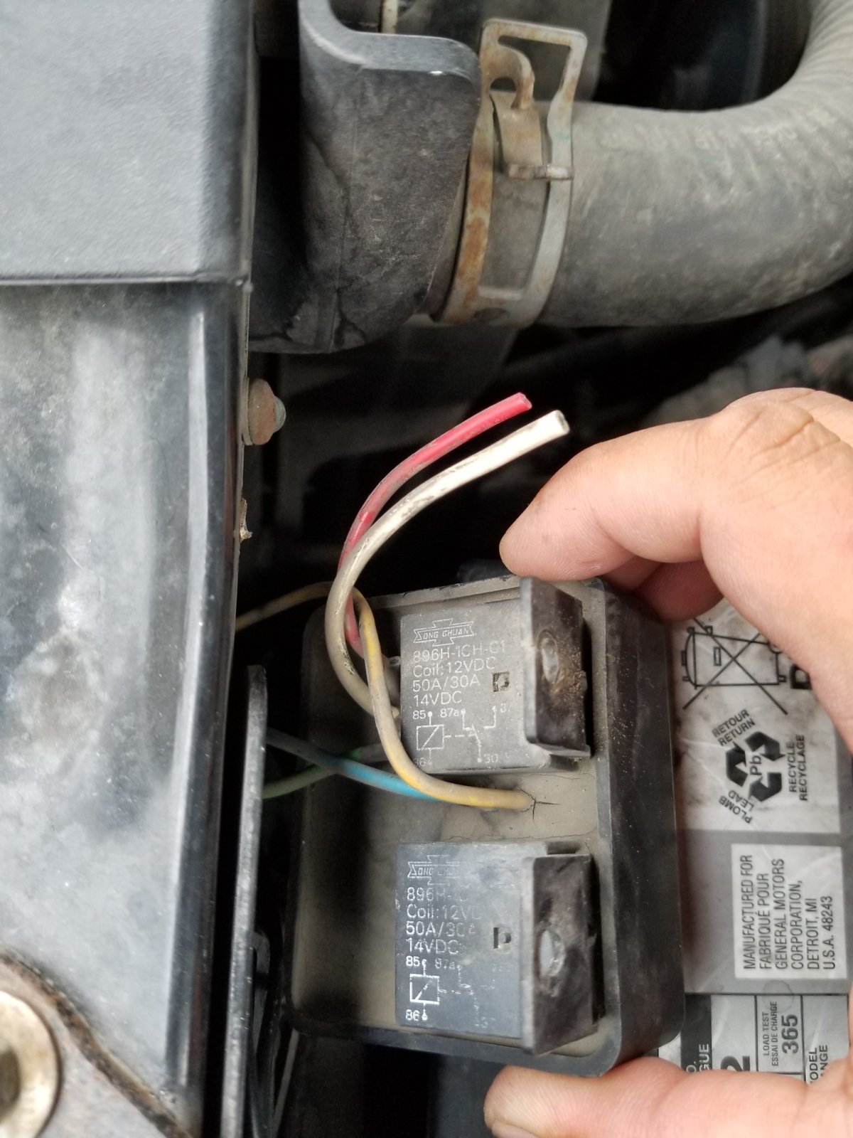

So I have an update, I found the green/red wire It was in the 6j3 harness. So I put 12v to it and it didn't do anything keys on as well. But then I looked up front drivers side by the top corner of the radiator and found an external soundoff signal etrr00-p headlight flasher.... So I reconnected the wires to power and it controls the high beam wig wags.
Why would this have an aftermarket flasher if I have the SEO 6j7 provision? Anyways I'm just going to wire a switch to this and I'll have front wig wags for now but no rear tail flash..

must of been an upfitter installing his complete package. For ***** and giggles look under your right front fender forward of the tire, you hafta look real hard but that is where the factory wig wag flasher is mounted.
Now, just curious, does your flasher flash the rear lights as well?

The flasher I found doesn't flash the rears only the fronts.. And when I put 12v to the green/red lead for the stock flasher nothing worked ..
