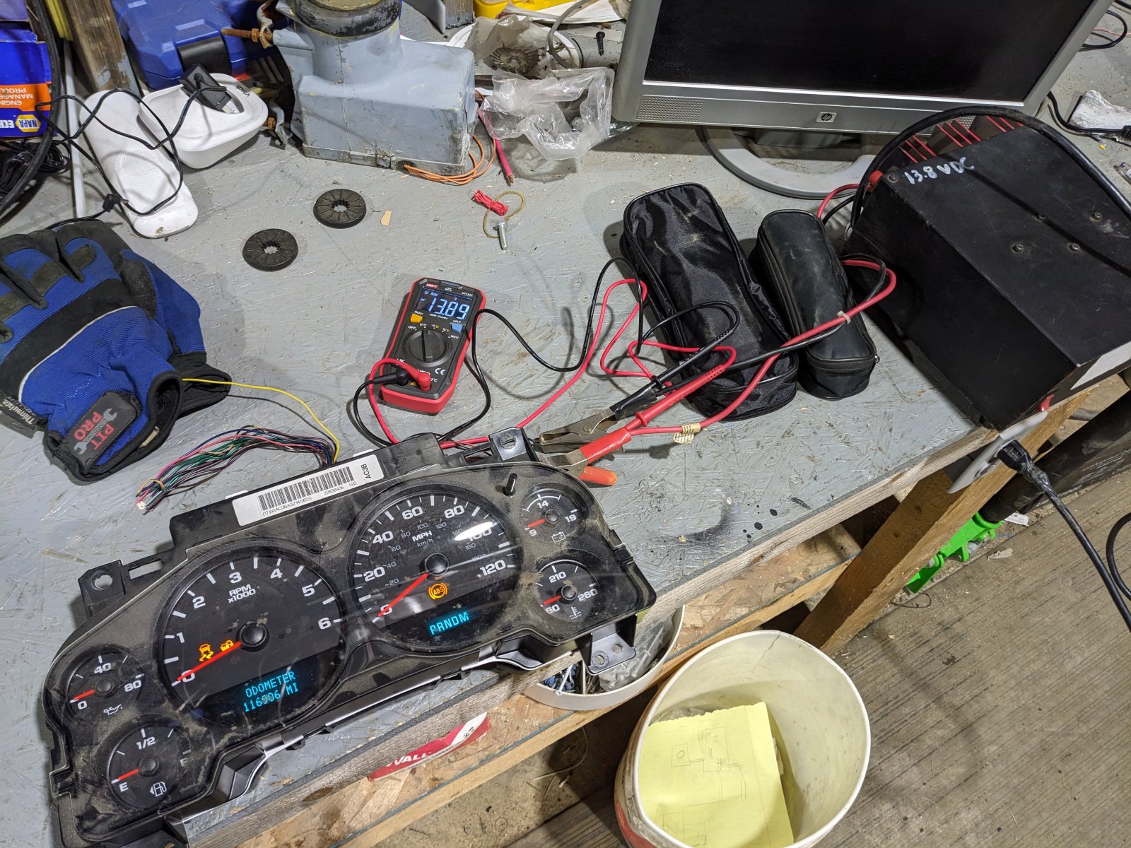

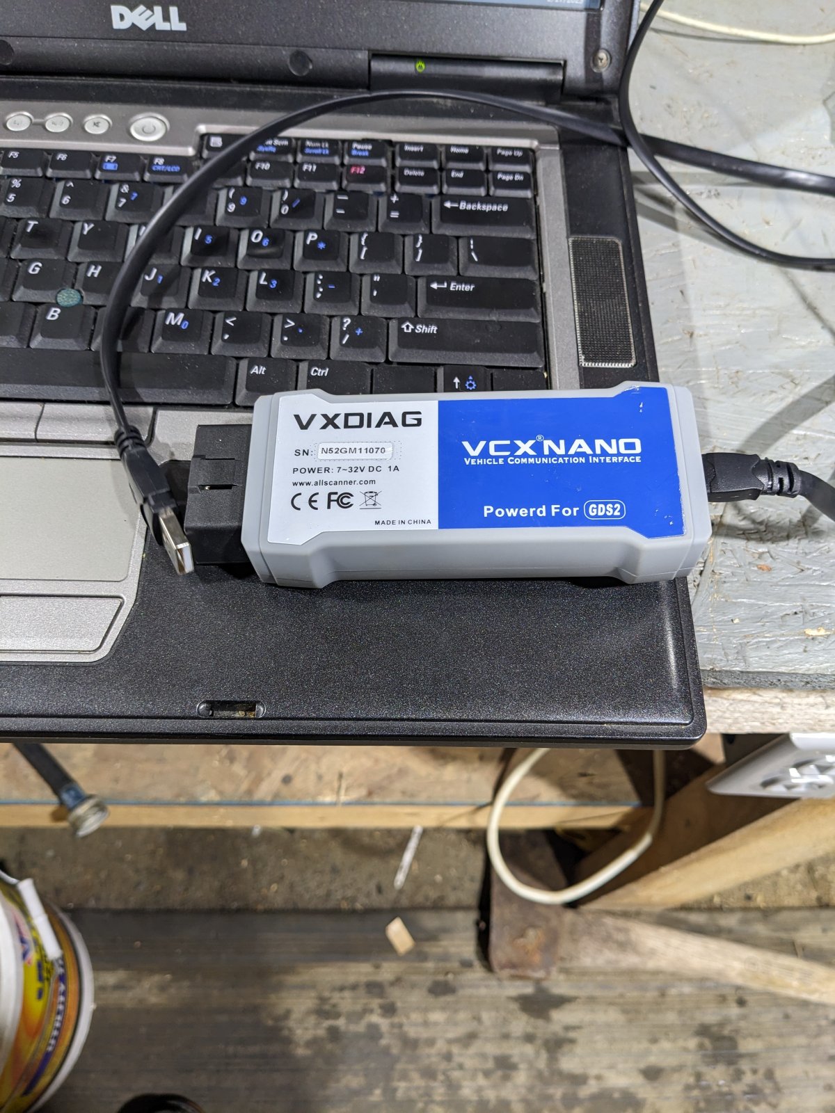

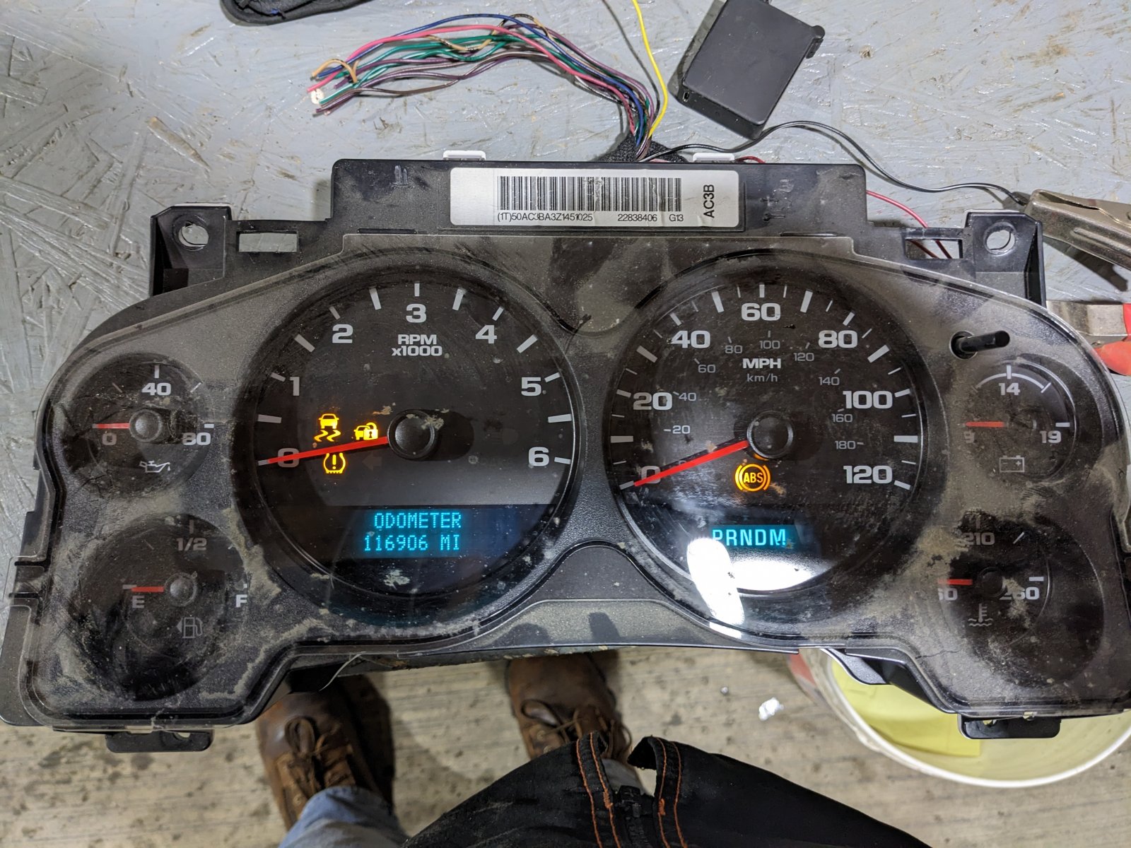

Well I learned something new today. The mileage is stored in the cluster not the ECM, who woulda thunk it. I figured the ECM would store it so you couldn't change the cluster and reset the mileage. Makes me wonder if my Tahoe has 199k or if its really more.....
Edit: this is the '13 sierra cluster

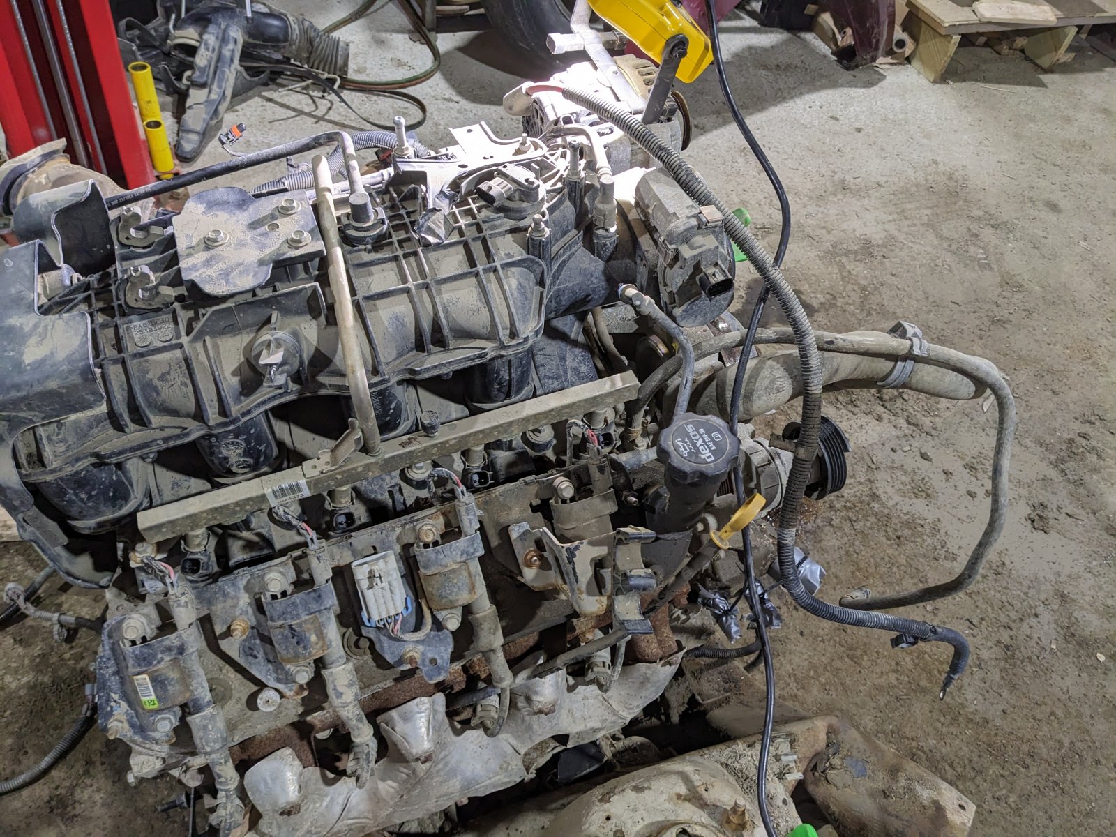

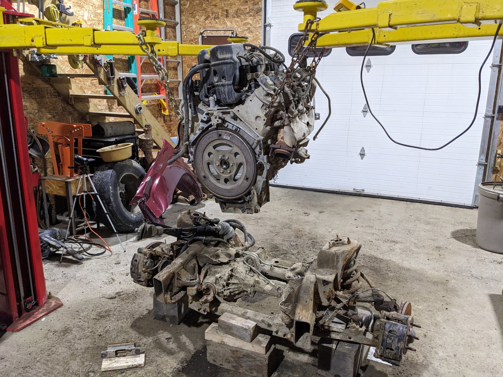

She's free! Scored harbor freight engine stand on sale for 80 bucks.
