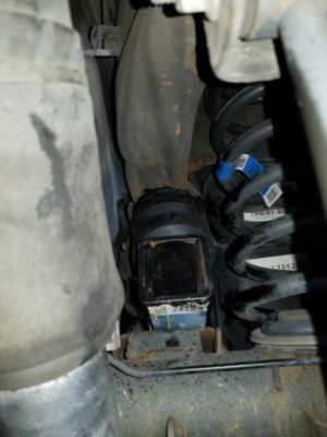

If you look under the rear at this point you will probably see the stock bump stops sitting on the axel.

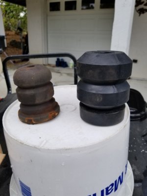

Here are the Timbrens compared to the stock
The stock one only took a slight tug to pull out here is it in the stock location. With a floor jack under the truck and the rear wheel still on the ground.
The only tricky thing was using a piece of square metal tubing to press them up into the seats. I inserted this between the axel and the stop and then lowered the truck back down using the weight of the vehicle to press the stop in. See below
These now sit only about 1 1/2 in off the axel thus they engage a lot sooner than the stock ones.... This is a picture from in front of the rear wheel so you can see how much beefier they are compared to the stock ones
I would start with these you can do it in less than an hour for around $220 shipped.
