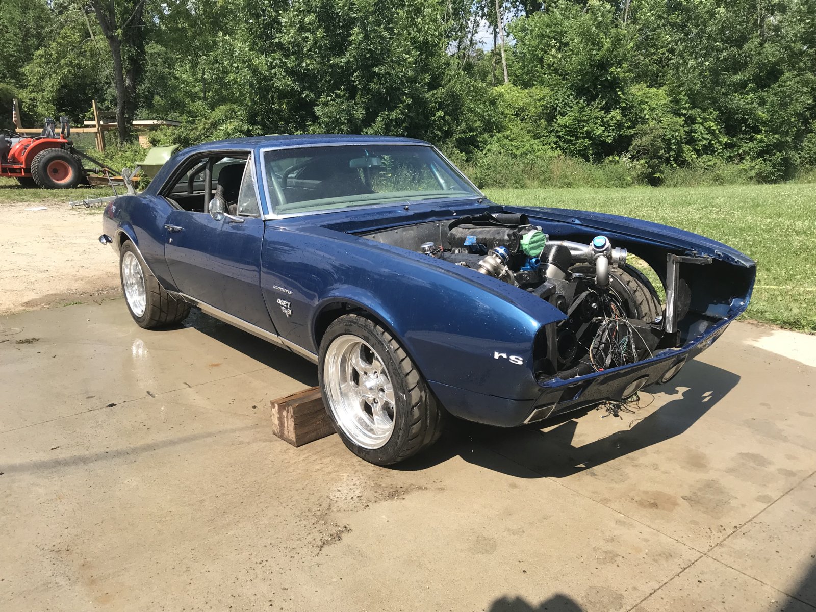

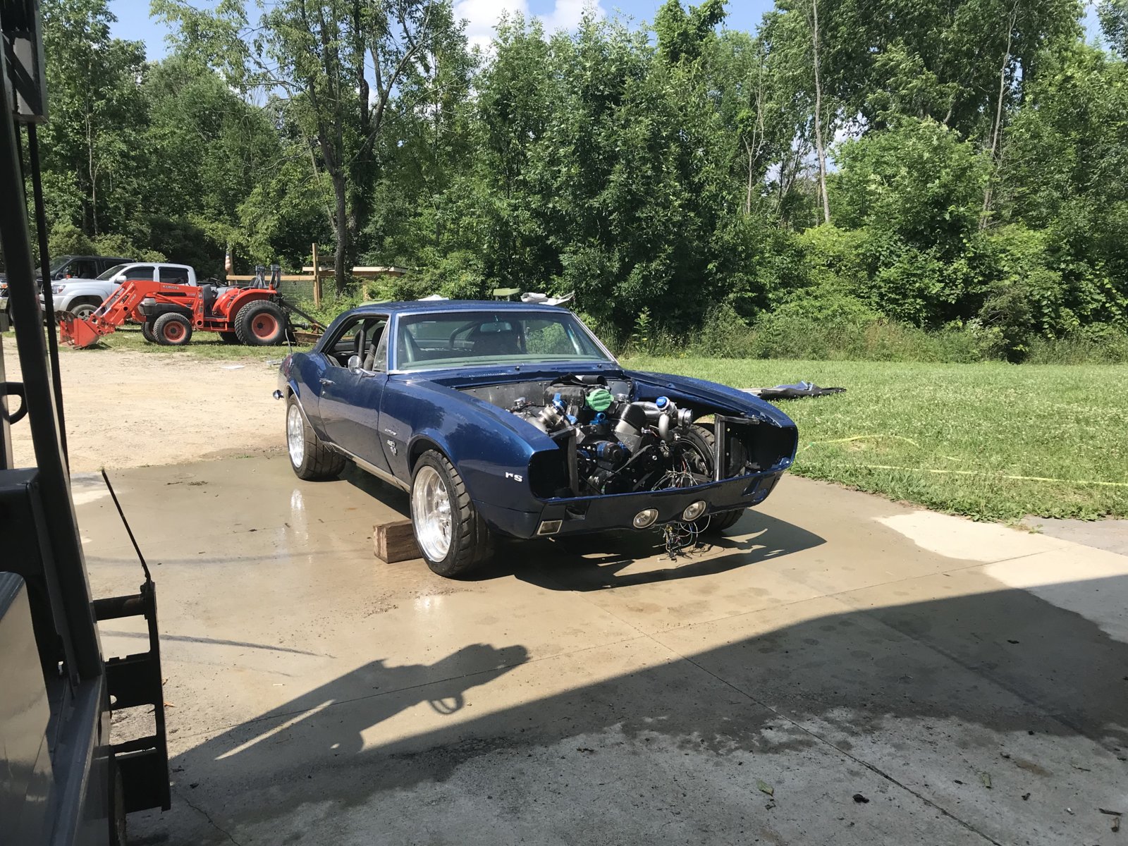

Before the answer to the 0-60 on the Yukon, heres a great video of my buddy doing burnouts in his Chevelle you guys always ask about...
*He got pissed after driving my Supercharged Yukon Denali so he stole my battery from the Camaro and threw it in his Chevelle. It has been sitting for almost 2 years and it fired right up. It's a .060 over 454" BBC with a pretty decent CAM. He proceeded to do burnouts in the shop and then went outside and did a few on the driveway LMAO...

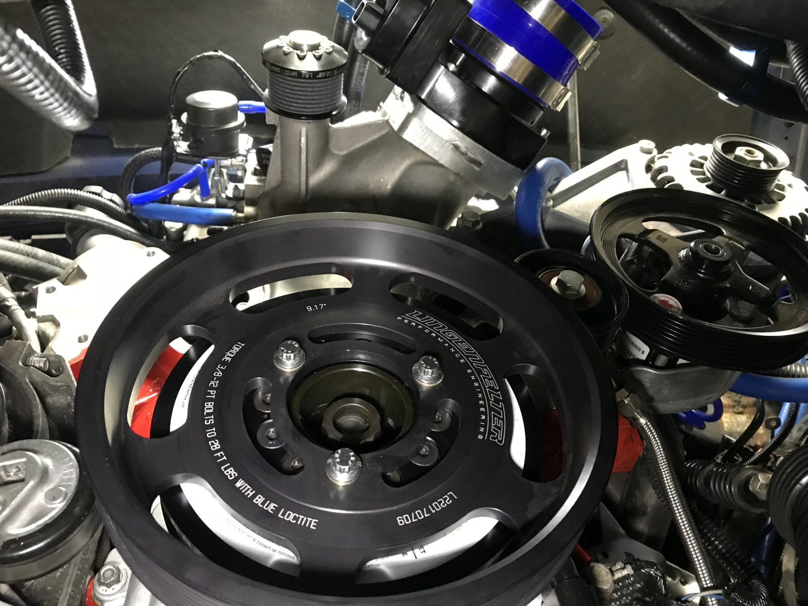

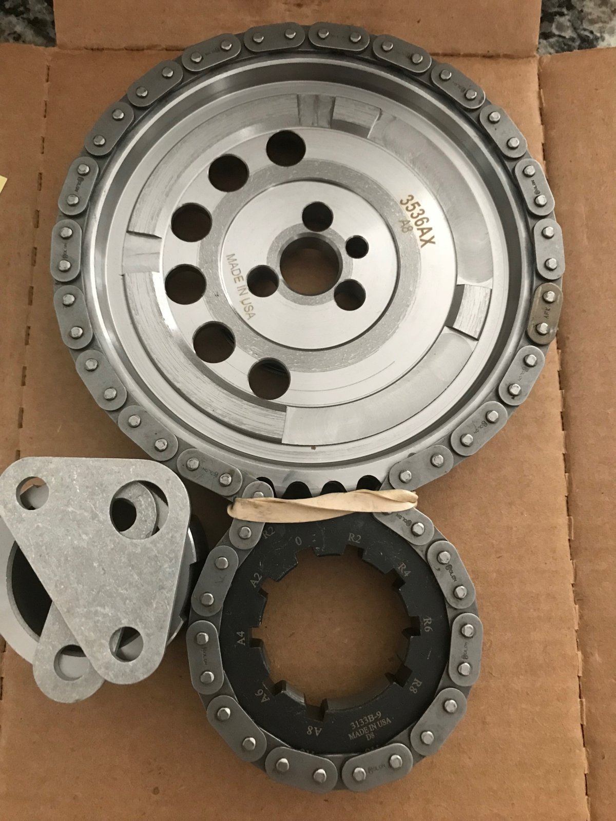

Don't recall if I mentioned this but I had to tear off the front accessory drive and timing chain to replace my CAM sprocket... Some ******* sent the wrong part and no one noticed when we assembled the motor. I have a 1 sensor 3 bolt sprocket installed, needed a 4 sensor 3 bolt... Such a pain in the ass but I ended up swapping out my lower 5% overdrive pulley for a 9.1"/10% overdrive. Gotta love more boost ;-)

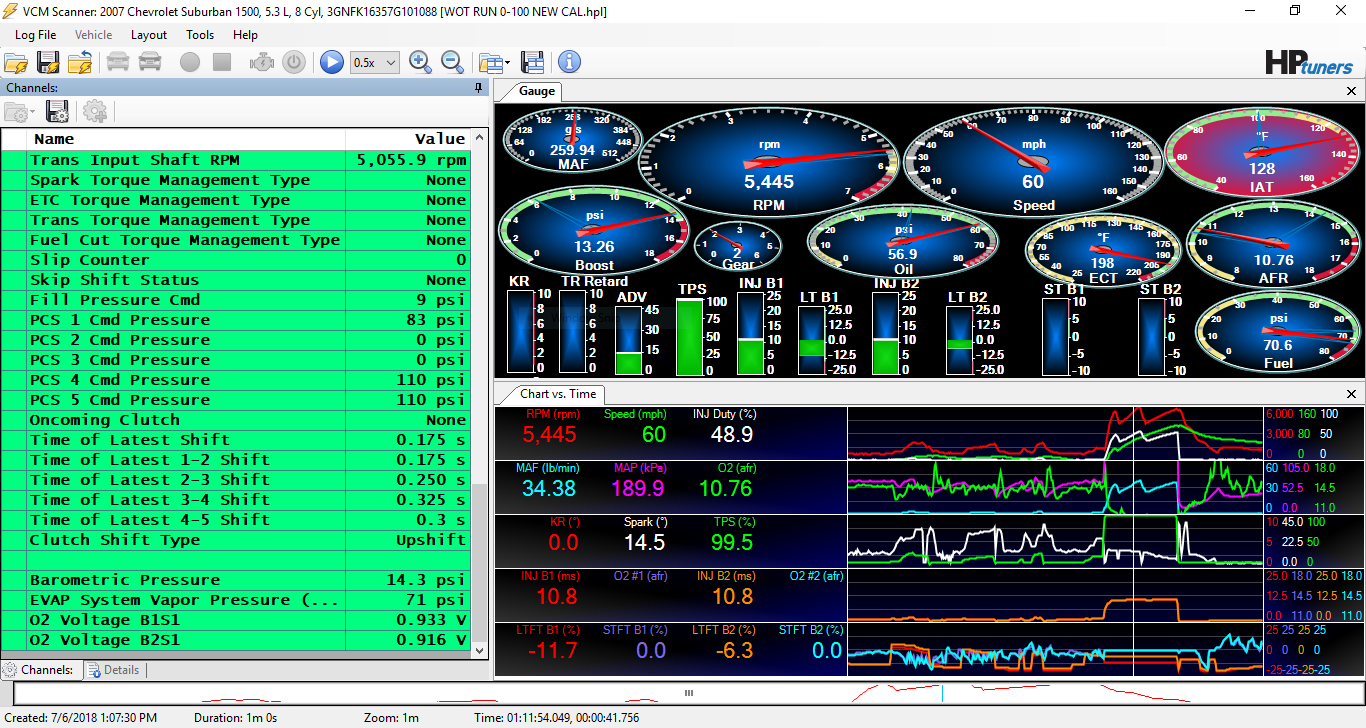

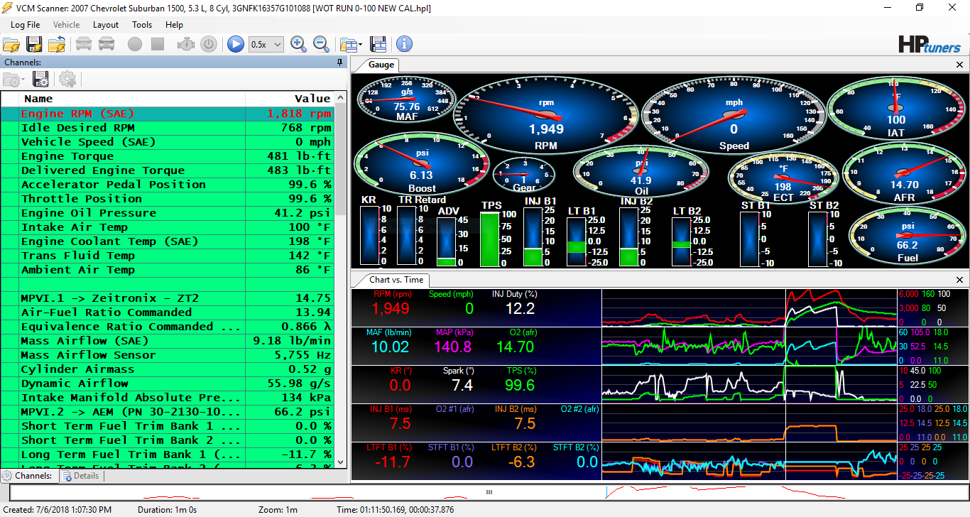

And for those that just want to see some data and a solid 0 to 60 time....
This run was today, 78 degrees outside and corrected Ambient Temp was around 86 degrees. I brake torqued it to 1,950 RPM and left with 6.13 PSI of boost. I do have a 2 step for this truck but haven't installed it yet. Was waiting to get the tune dialed in...
As you can see from the screen shots below, with a 100 degree IAT (no fans on my heat exchanger), I was able to run 0 to 60 MPH in exactly 3.88 seconds... This is the second time I've logged 0 to 60 MPH in less than 3.9 sec. Even in the 100+ degree weather we had last week (115 degree ambient), it still did it consistently.

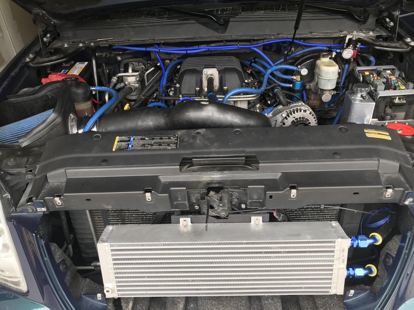

This is on a VERY conservative tune, barely any timing and more than a full point rich on AFR... Things will be pretty interesting to say the least when I get my heat exchanger fans installed and my interchiller next month as well. My IAT temps at the end of my 0 to 100 run were 175 degrees!!! I won't post the 0 to 100 log as I want to keep you all guessing, but it's fast to say the least lol. I also don't have the Circle D Triple Disc converter locked up in 1st or 2nd gear which would have given me an extra 1 PSI of boost. The 1-2 shift only went up to 5,577 RPM (36 MPH), 2nd gear shifted at 6,111 RPM (69 MPH) in this run as well.
I'm revising the tune after this post to lockup the converter in 1st and 2nd gear @ WOT as well as bumping the shift MPH up a bit. I was gonna wing this motor up to 6,800 RPM but it makes so much damn torque I don't know if I need to... 1st gear @ 6,800 RPM is 47 MPH and 2nd gear @ 6,800 RPM is 80 MPH.
There is A LOT left on the table with timing and AFR being rich. I can CERTAINLY do AWD burnouts lmao.... More videos to come soon, I promise

Anyone notice the 1-2 shift time? 175ms!!! This transmission is running great! Who the hell knows how long it will last but I don't care :)

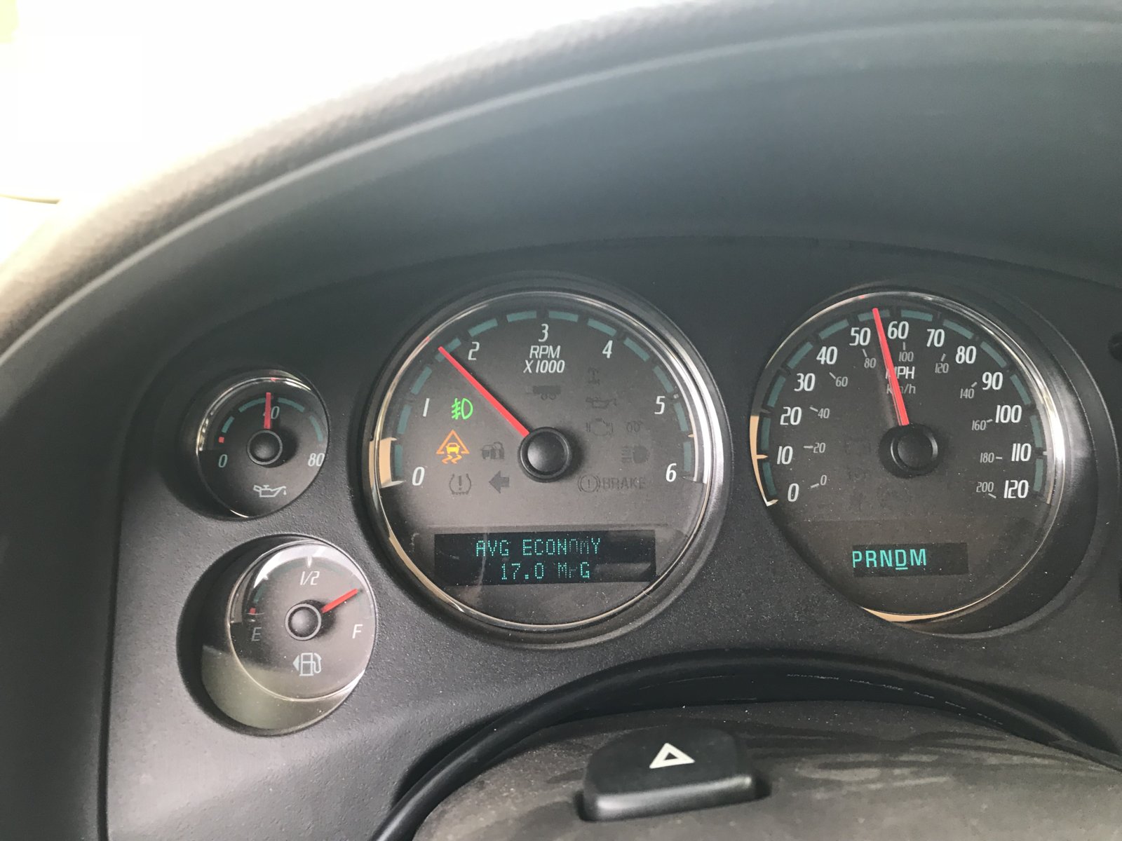

This beast also still gets excellent fuel mileage considering... I'm seeing 8-9 MPG around town driving it hard, testing and tuning. Running really rich right now too. Cruising on the freeway with light load, I've seen 16.7-17 MPG @ 55 MPH... 13-14.5 MPG @ 80 MPH
