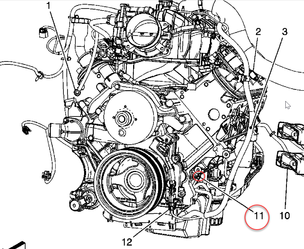

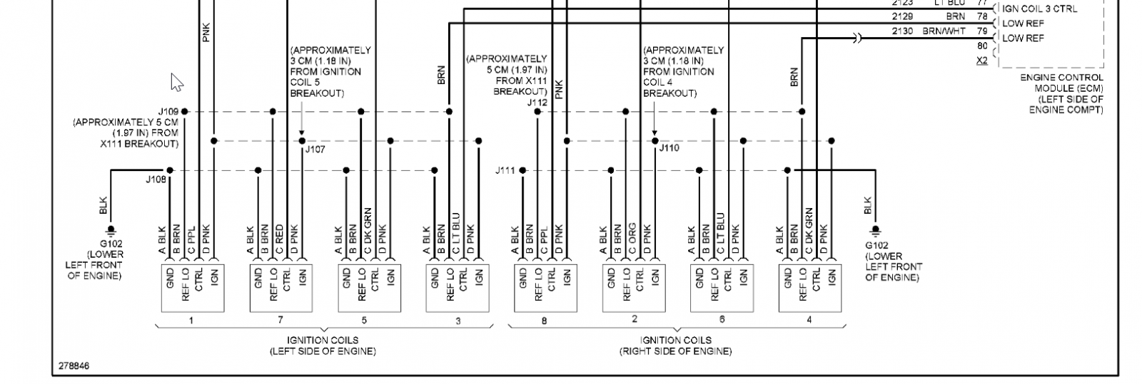

99% sure the issue is the wire at ground point G102. Under load the voltage at the coil was 1-2 volts lower than the battery. When I inject ground to the wire I get spark. I cleaned and reinstalled the wire at ground point G102 and the problem got worse. The eyelet connection to the wire seemed weak and pulled off with not too much effort. I need to crimp a new eyelet on and I bet the problem will go away. It's difficult to access it though, nothing is ever easy!
View attachment 381032View attachment 381033
That is why, especially on these ground(s) problems, when you locate and disassemble them and repair them, make sure you do it once and do it right. I was hoping that a connection problem, like I described above, would be a connector that controlled the entire side of the engine. That ground is a good find. Make sure, if you fix it with this ground repair, that you pat yourself on your back and have an ice cold beer. Lots of people would have just given up. Think of the diagnostic time $ you saved if this works.
