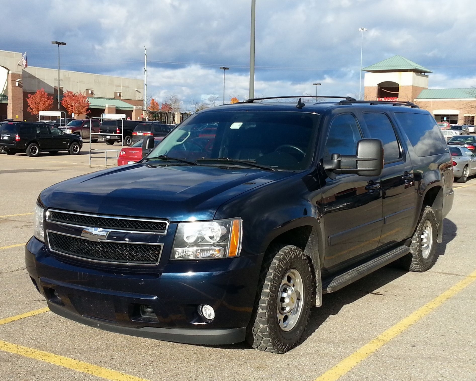

Goodyear Duratracs are an aggressive-looking tire. I bought them for the snow/rain performance, but they also happen to look good and do alright off road as well.

The original mirrors are tiny. I hate them. Once you get used to the tow mirrors, you'll never go back. I put them on my Denali, too.
I know you have a different transmission, but mine generally runs about 90-100° over the outside temperature. I wouldn't worry about it until starts going/staying at 220°.
Yea the tow mirrors are starting to grow on me. Will probably leave them
