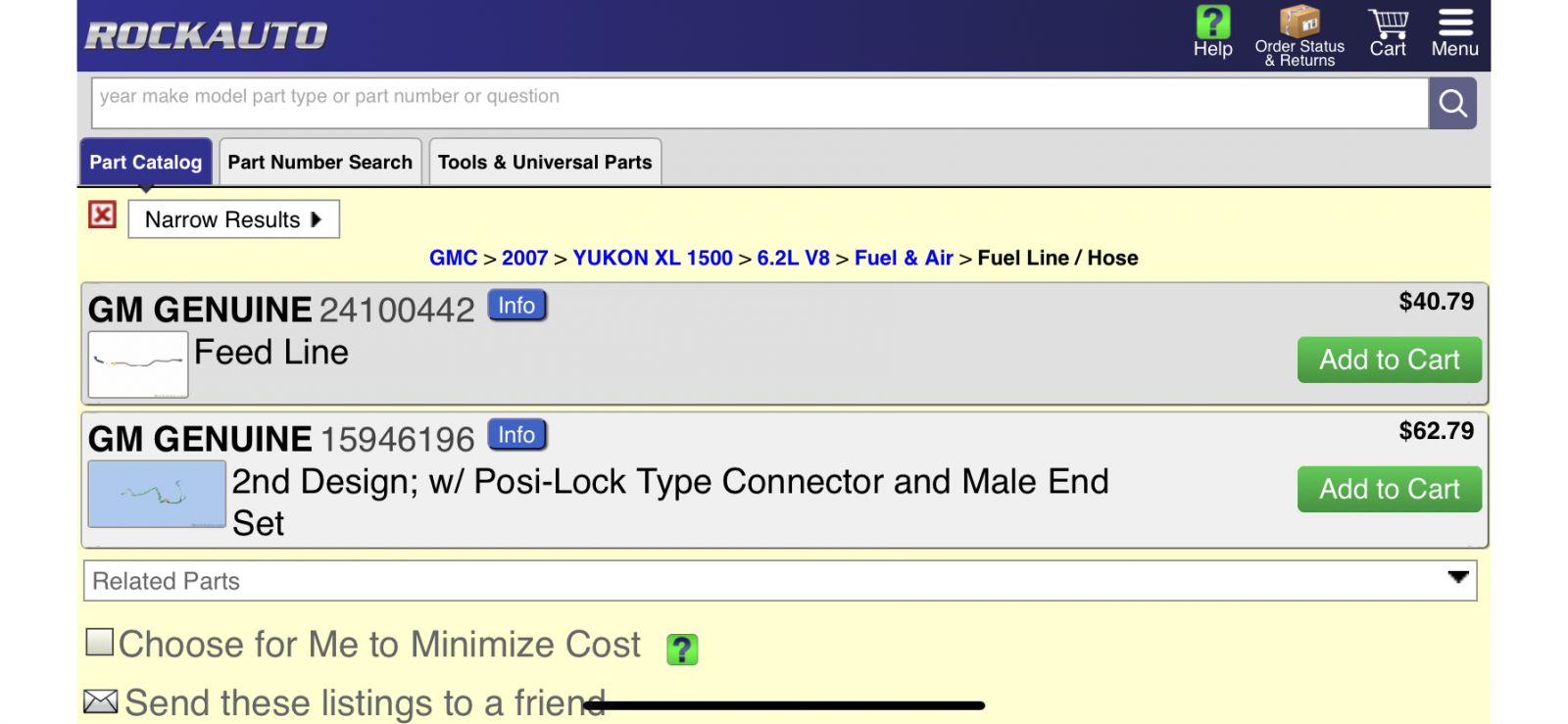

So, now I need the fuel pump, the hoses that are on the tank, a hanger, and the metal line. Problem is I can't find the part number for the metal line. Even the Fuel System Component Diagram from GM doesn't show that line, just the hoses on the tank and the pump.
Has anyone had to replace this metal line? Do you have a part number for it? How hard was it to do?

Are one of these what you are looking for?
