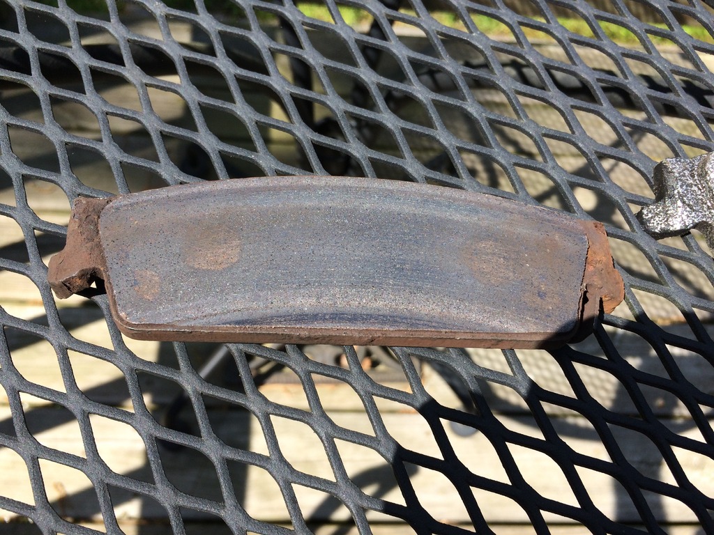

I've had my 2007 Avalanche for 13 months now. 1 month ago it failed inspection for rear brakes. Turns out the passenger side rear inboard pad was worn all the way down to metal. The rest of the pads had a good amount of material left. I replaced the pads myself with Duralast Gold (ceramic) pads, and lubed the guide pins with silicone grease. Also replaced the pad retainer clips myself. I then went on a road trip where I put around 1000-1200 miles on the car. About half-way into the trip, I noticed a chattering, or vibration throughout the entire car, while I was backing out of an inclined parking spot. I've gotten it to do it again a few times since, but it doesn't happen every time. It happens when I drive the car for a while, park, then come back a few minutes later. Always at slow speed only.
So I decided to pull off the pads again and take a look. It looks like the same pad that had no friction material left is now wearing a grove into the pad. Here's a picture of the old pad:

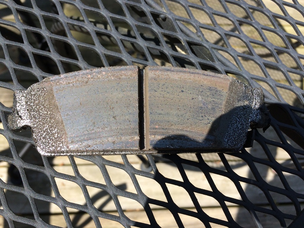

And this is the new pad I pulled off after the road trip:
As you can see I think the chattering or vibration is from the grooves in the pad. What would cause this? Rotors or caliper? Caliper bore moves fine when I push it in to put on the new pads. I didn't notice anything weird and the rotor doesn't looks scored or damaged at all.

The slide pins move freely and have been lubed with dielectric grease to hopefully keep them that way. I don't think it's the slide pins.
There are noticeable groves on the old and new pad. Sorry for the poor pictures. You can see them with the naked eye and you can certainly feel them. Maybe 1-2mm deep. I tried to highlight them in this picture:
