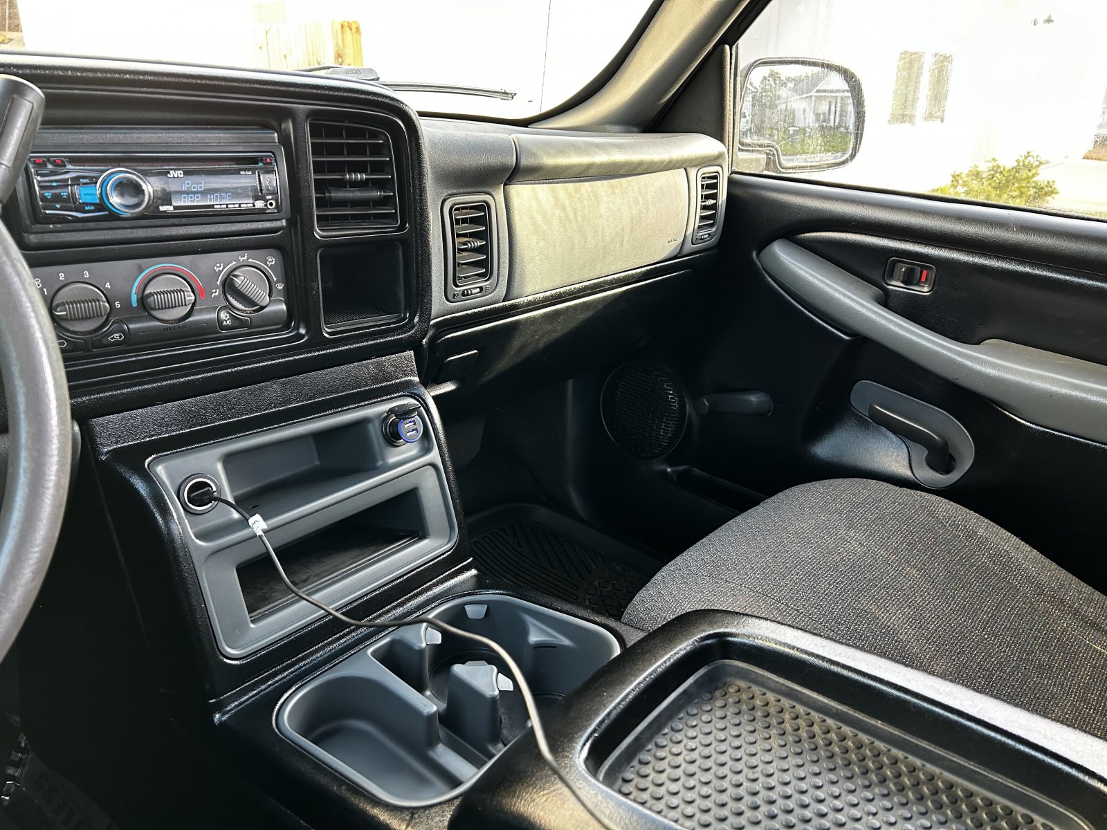

This is s super easy mod, and I recently did it in my 00 Silverado which is basically the same. You will need the following:
Center console (obviously)
Lower passenger-side dash trim (that encompasses the glovebox)
Lower driver-side dash trim (kick panel under the steering wheel)
Make sure you get the bracket for the center that the console bolts into (should be x2 10mm bolts)
Wiring connections for 12v outlets are a direct swap, but the console will have 2 instead of 3.
