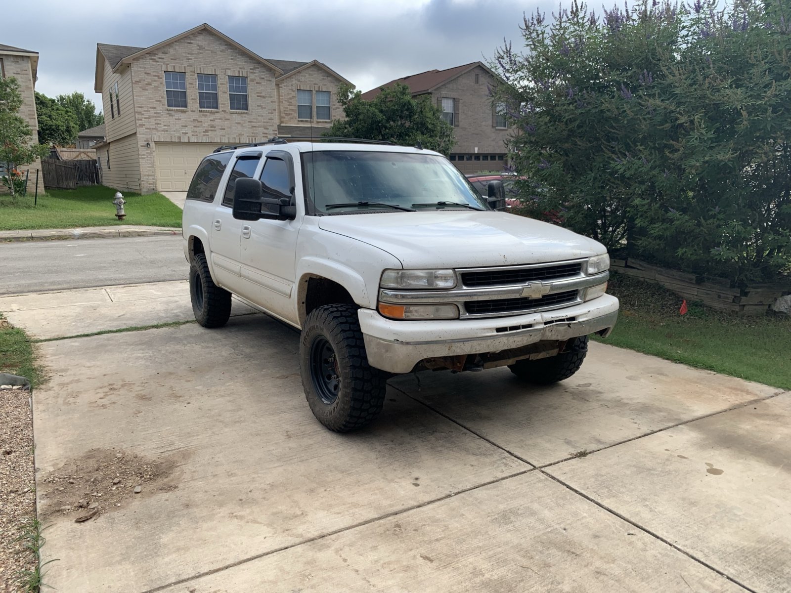

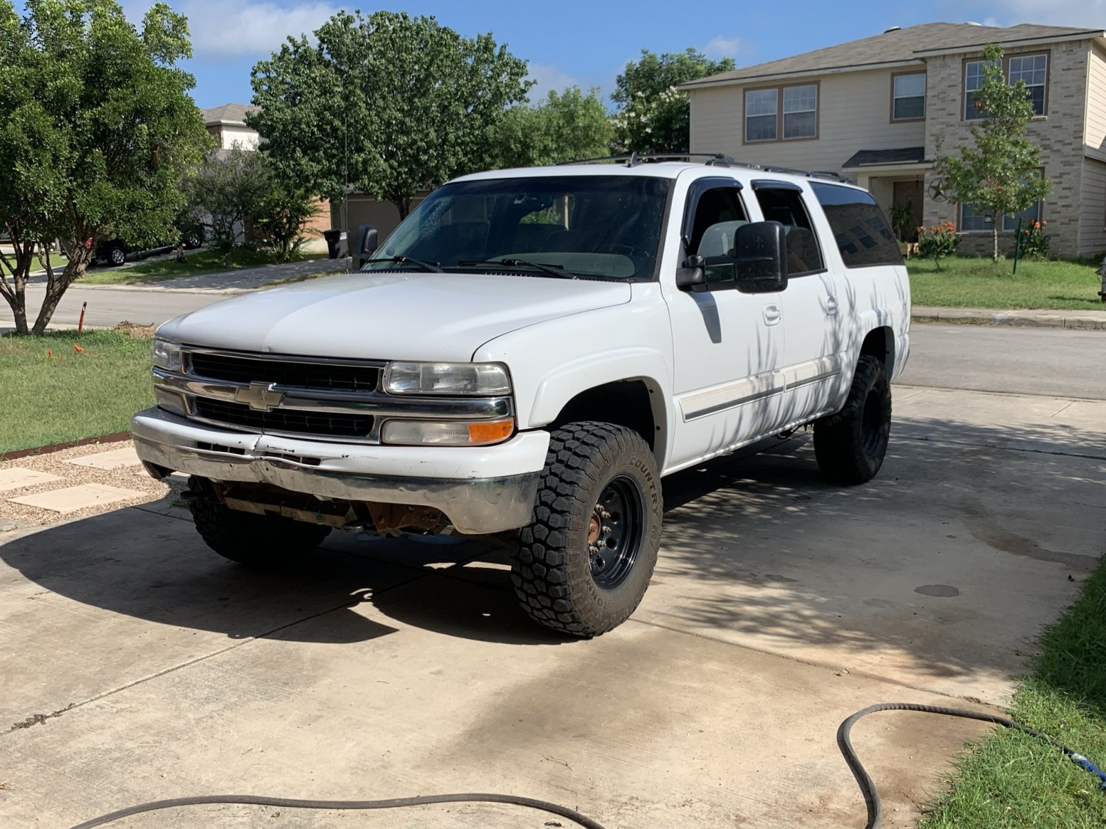

Hello everyone!
This will be the beginning of my build thread for my newly acquired fully loaded 2006 Suburban 2500. I just picked it up for $3750 (which is a steal for these things) and it definitely has its fair share of needed maintenance/TLC. I will try and document as much as possible. It was used as a farm truck by the previous owner but only seemingly for about a year or so. Not sure what the history is with the owner before him but I think it didn't have that hard of a life until recently.
I owned a 2000 Tahoe from 2008 to 2018 and really loved that truck, but always dreamed about owning a 2500 Suburban. So I've been on the lookout for one for quite a while. When I saw this one, that ticked every box I had, and at the price it was listed, I knew this was the one.
Specifications:​
- 2006 Suburban 2500
- 6.0 LQ4
- 4WD
- Leather
- Factory Navigation/Rear entertainment
- Sunroof
- Factory Power/Heated Tow Mirrors with turn signal indicators
- Rear lift gate
- Captains chairs 2nd row
- Heated front seats with full electronic control

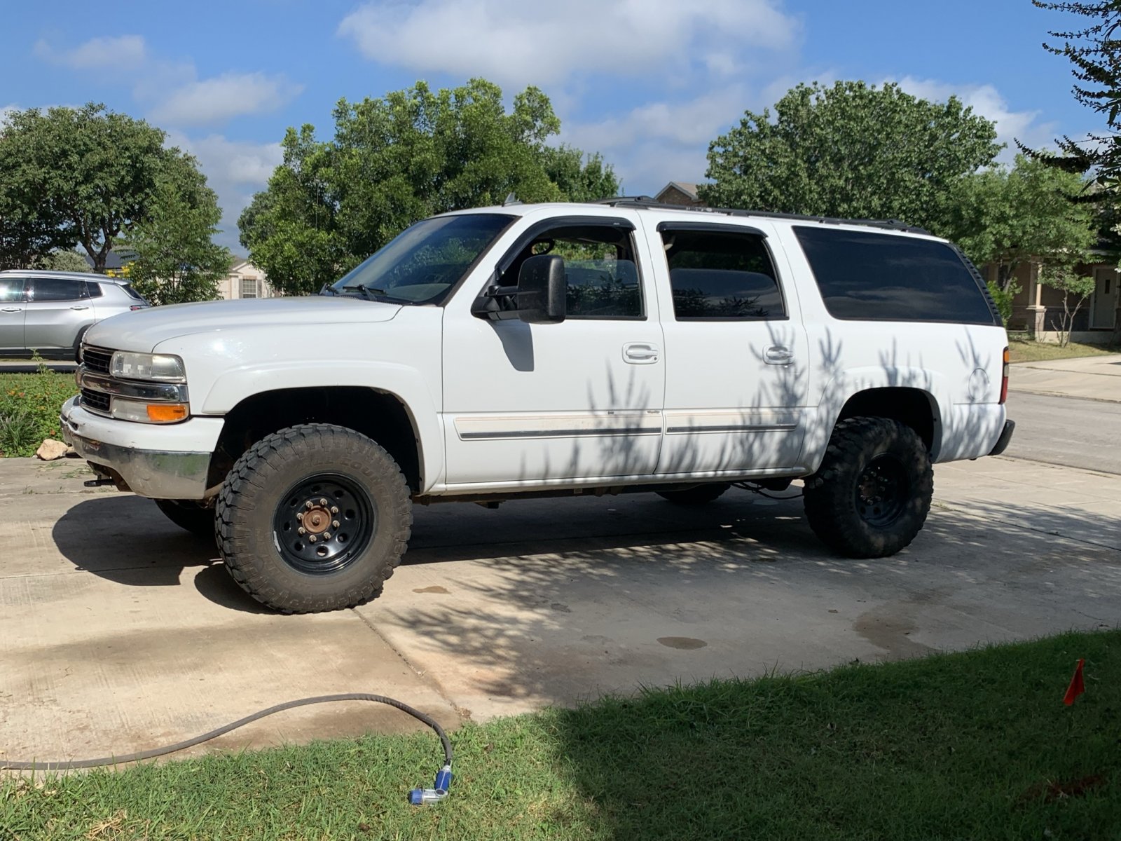

Here she is the next morning after a long 20 hour journey the previous day picking it up from 500+ miles away. Still fresh with bugs and farm dirt.
Gave her a bath shortly after (I'll be power washing clay/dirt from this thing for months..). She's definitely a little bit of a scratch and dent special
I'll continue with updates further along this thread. I've got some pretty big plans for this thing and look forward to documenting the process with you guys!

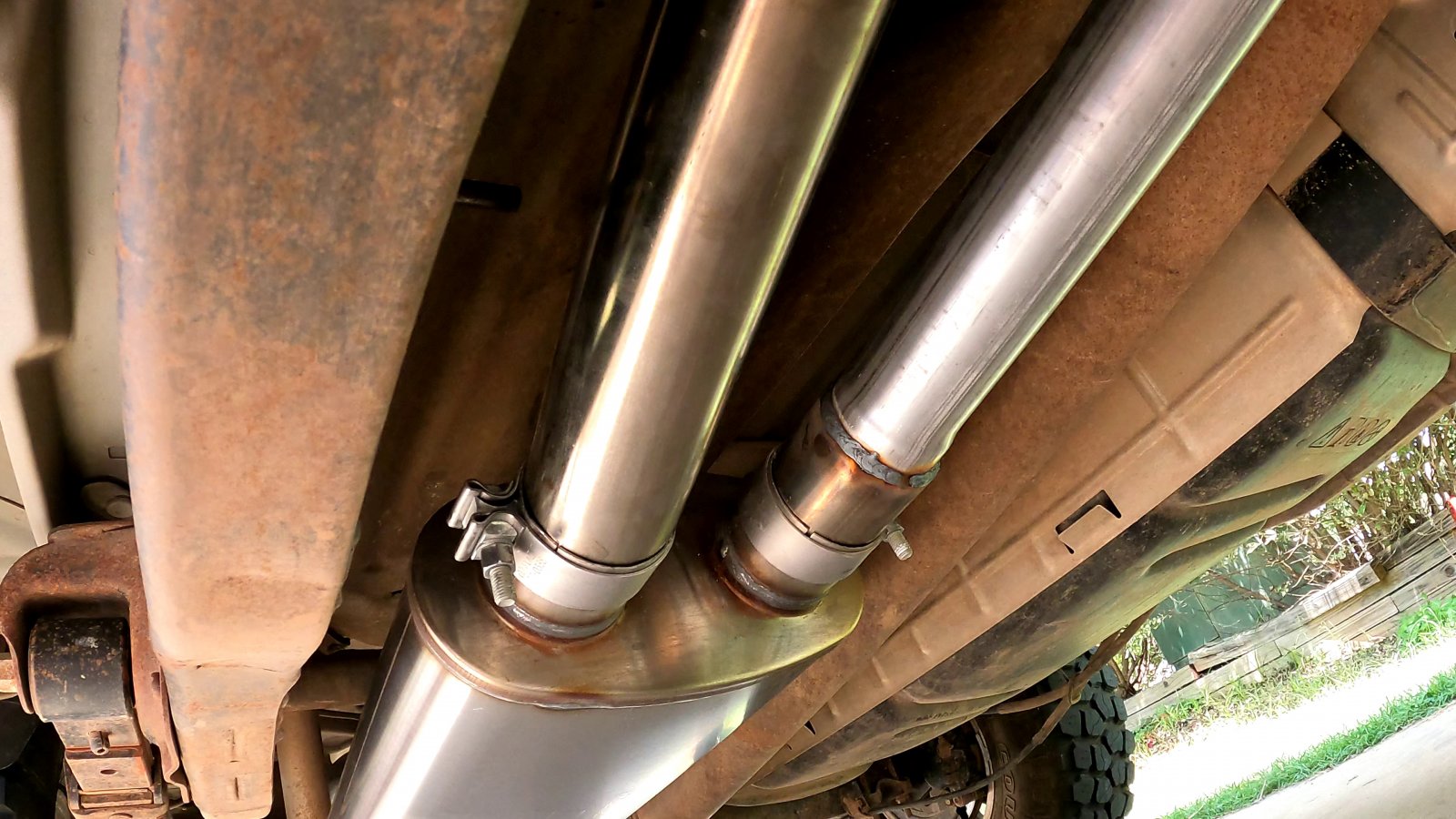

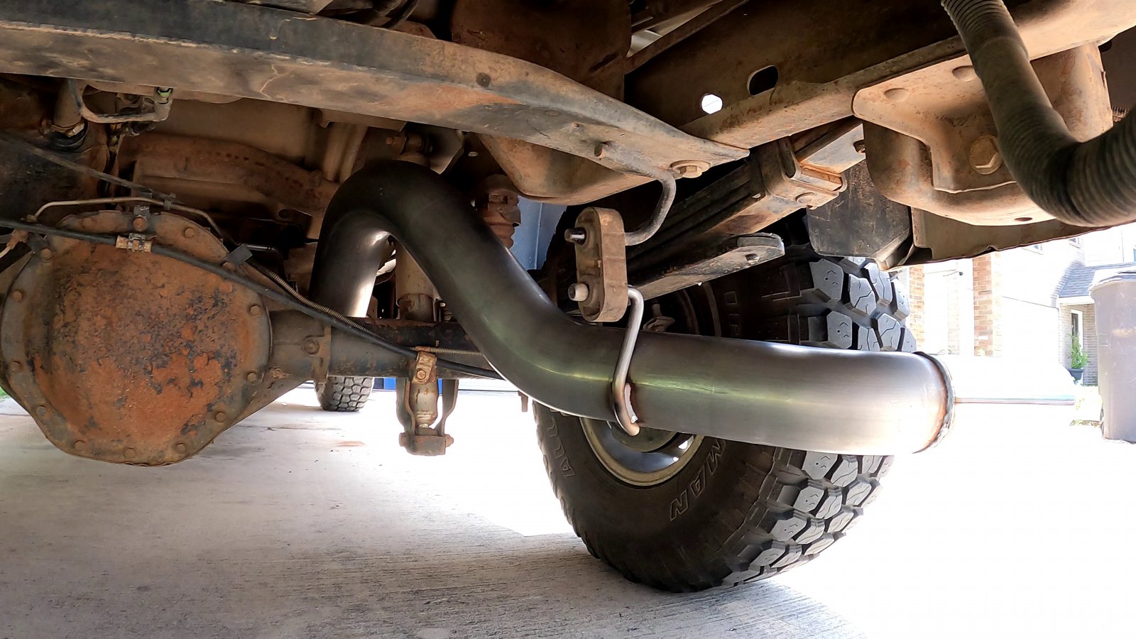

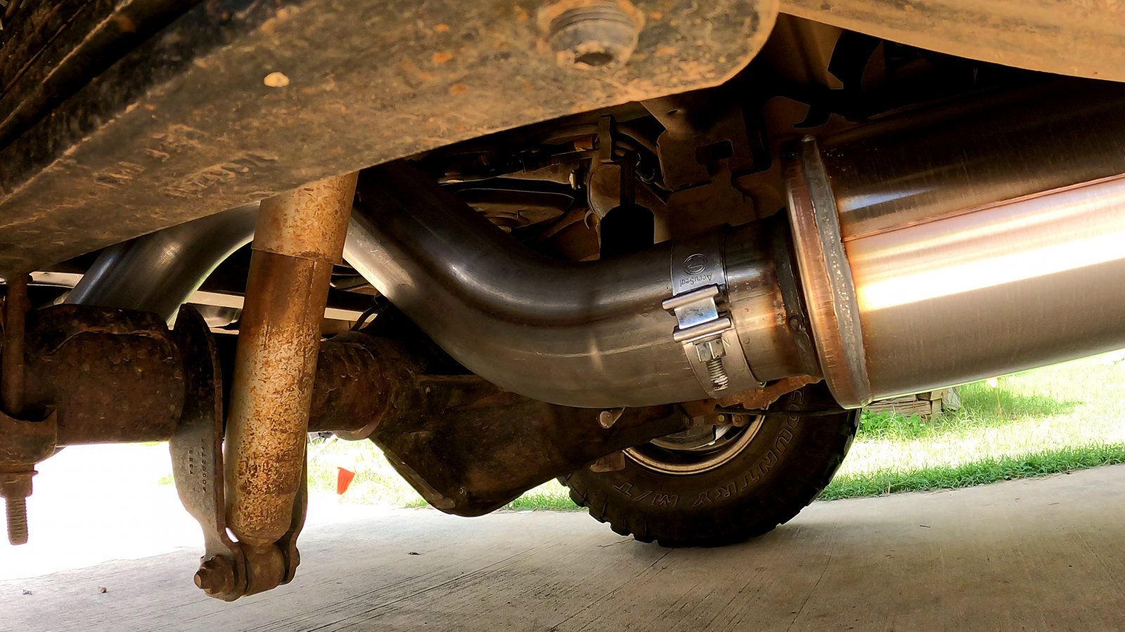

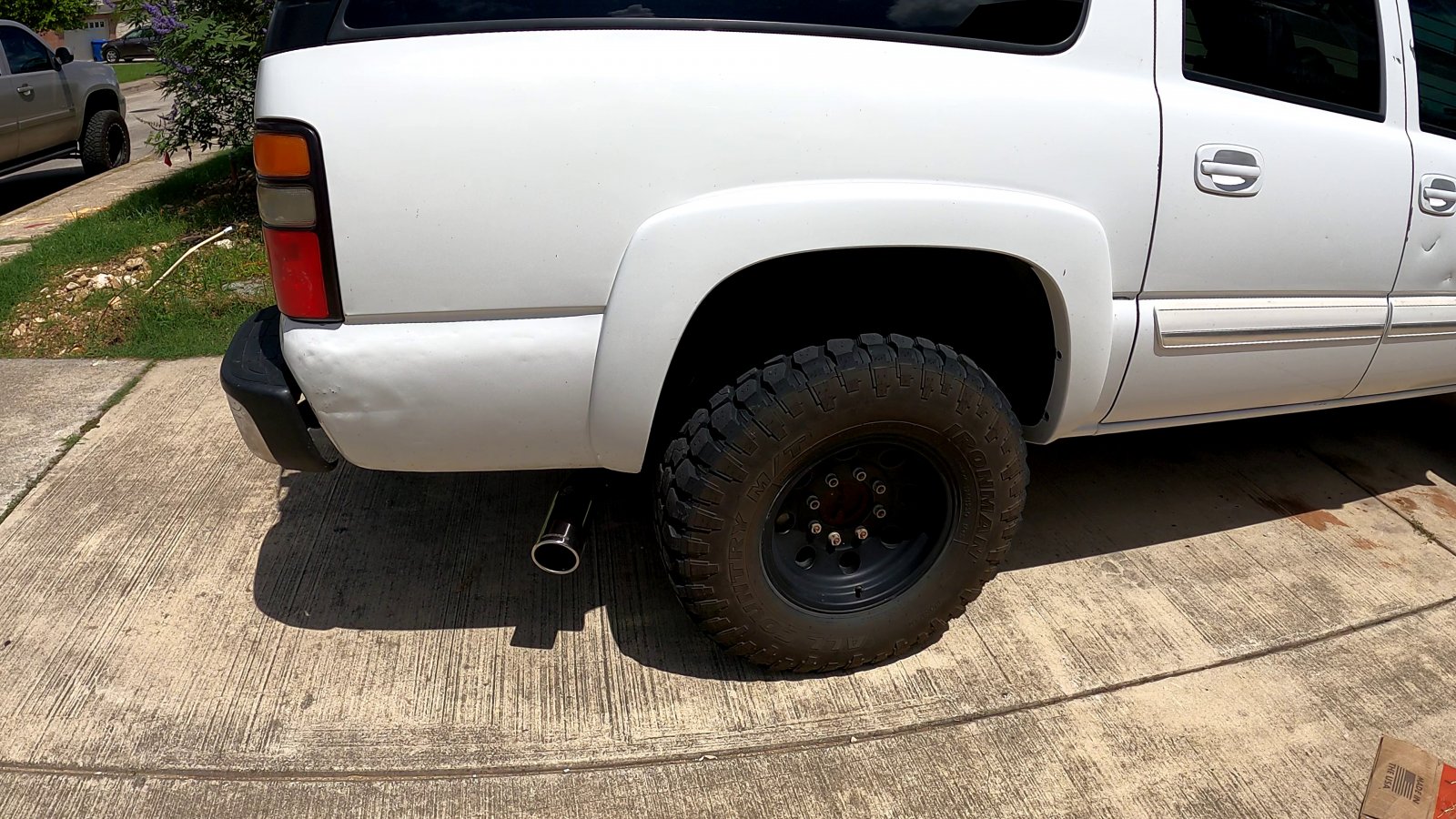

Exhaust Upgrades: Round 1​

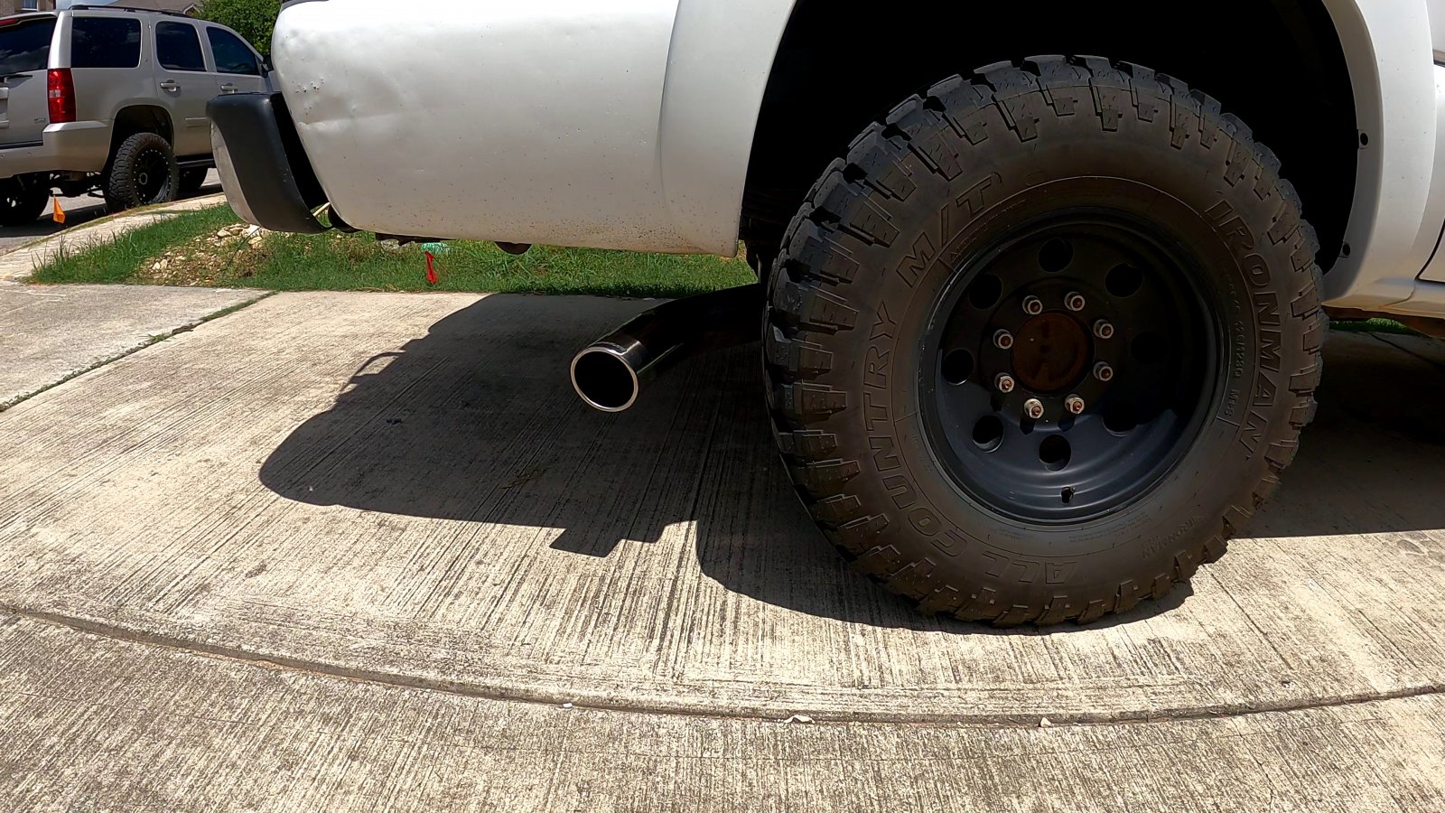

So the first thing I had to do was change the exhaust. The previous owner installed some really hacked glasspacks.. In addition the smell of exhuast fumes from this thing is pretty bad. So the entire exhaust system needs attention.
On my 2000 Tahoe, I had a cat back exhuast from Magnaflow I really liked, so I ended up ordering one for the Suburban. The magnaflow exhaust is designed to directly fit to the OEM setup, but unforunately the previous owner had mangled much of that. Much of the needed factory piping was gone, as well as a couple of the exhaust hangers.
So I took it to a shop to have them install it and fix the exhaust hangers. Unfortunately, the shop i went to was incapable of doing anything other than sh*t work and did practically nothing of what I asked them.
The exhaust hangs about 10 feet lower than it should...
I
imi4tth3w
Jan 14, 2010
386
60
Texas

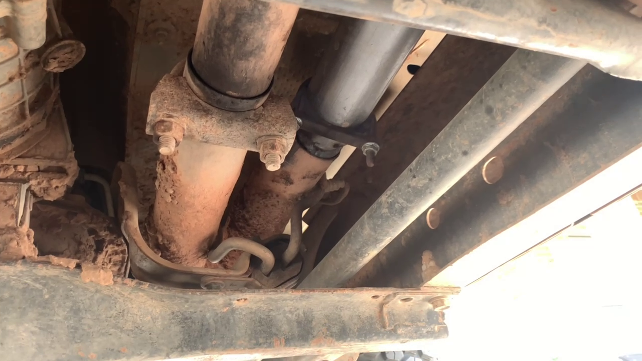

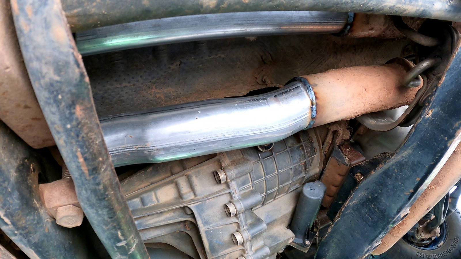

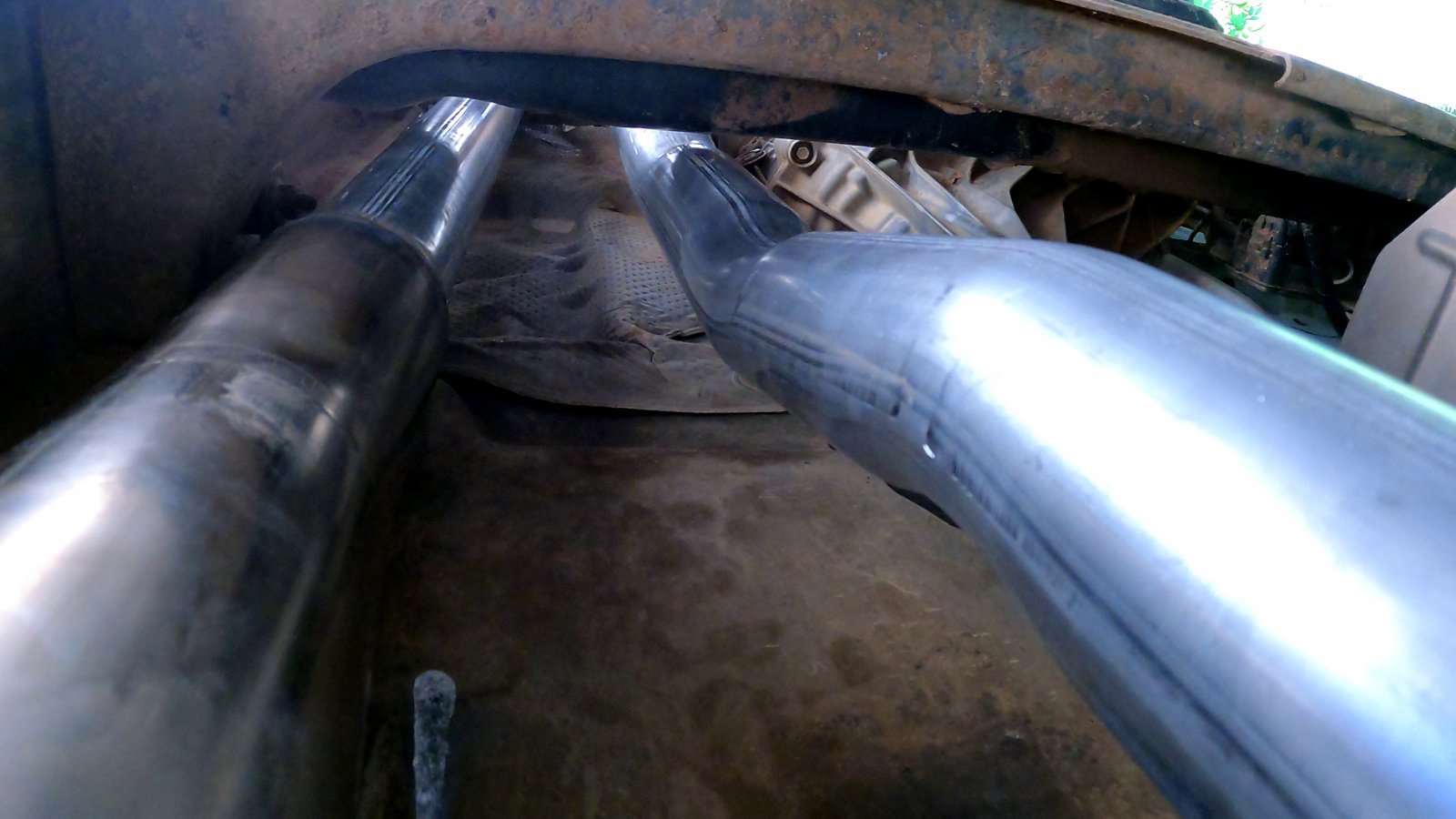

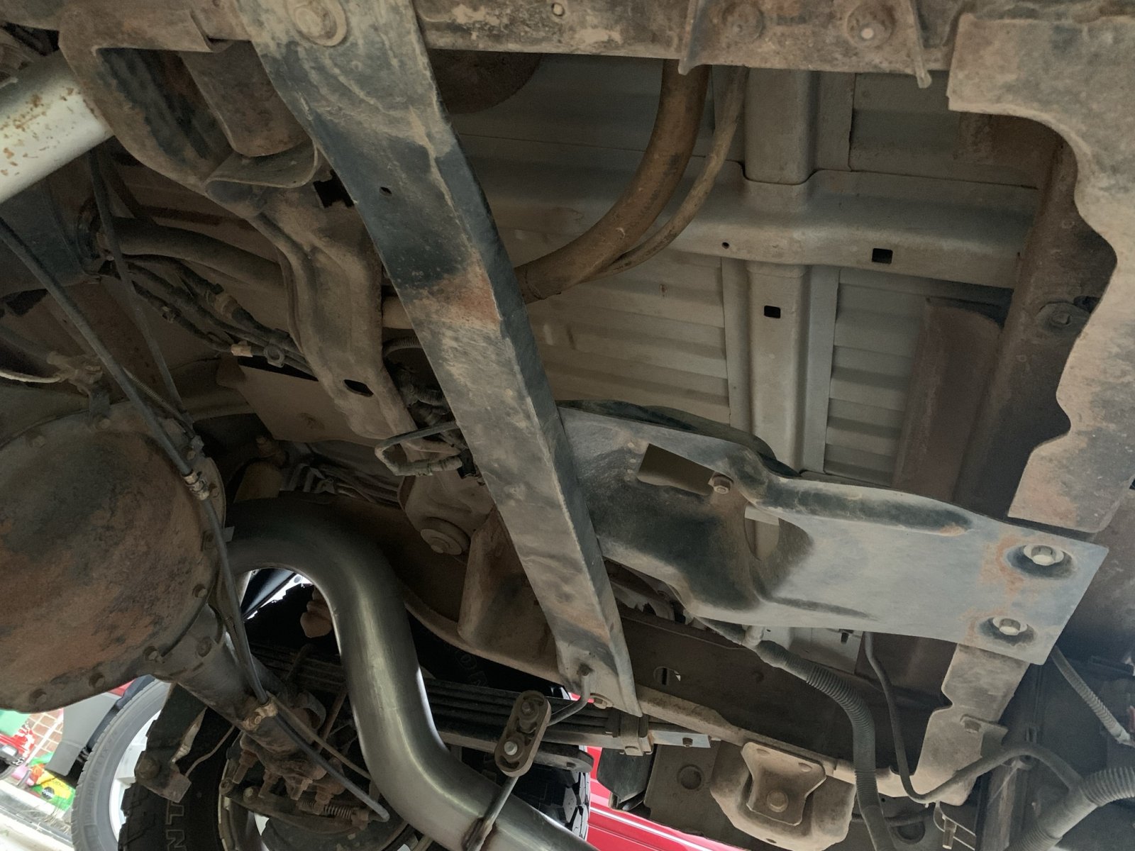

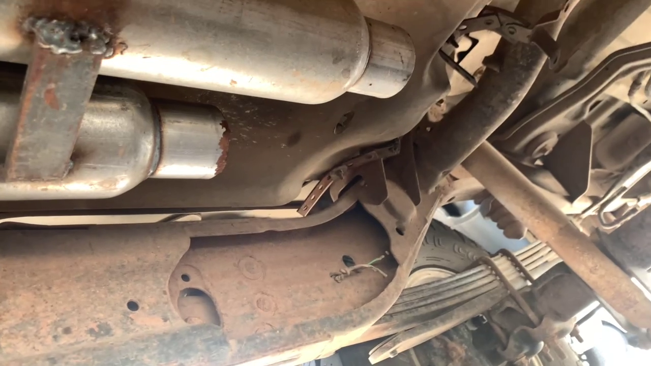

My guess is they clocked the exhaust wrong up to the muffler. I'll have to get under there and fix it myself. Here you can see the rubber isolator appears to be in the correct position.
Here you can see the muffler and the welding they did. They installed the two magnaflow supplied pipes at the front of the muffler in the wrong locations (longer one is supposed to be closer to drive shaft and use a slip/clamp fitting to the OE exhaust..) and the longer pipe also appears to be installed backwards (it should be 3" at the muffler side and taper to be slightly bigger than 2.75" to clamp over the OEM exhaust).
And not only that, the pipe they used appears to be 2.5" pipe when the factory pipe is 2.75".
And to add insult to injury, they never fixed the broken hanger or added the missing insulators like i asked.
And this is why I have trust issues with anyone working on my truck. But I also don't have a welder or a means to fix the original piping (right now).
My thinking is that I'll get this fully sorted at somewhere that isn't completely incapable of taking instructions when i get the new catalytic converters in. I'm assuming the heavy smell of exhaust fumes means the cats installed currently are either gutted, or just no longer functional. I also need to fix the usual sheared bolts on the exhaust manifold so those are next on the to-do list for exhaust work.

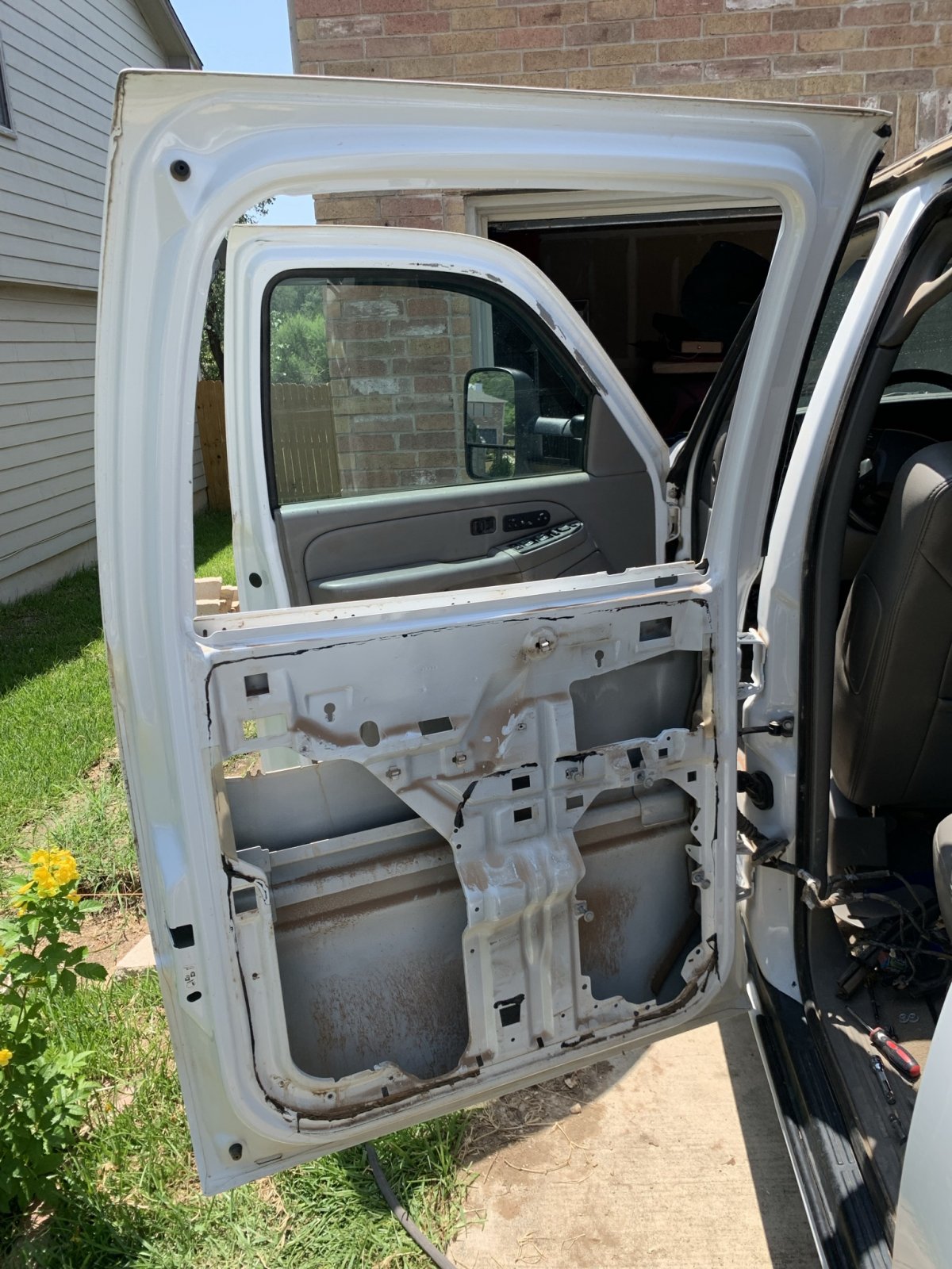

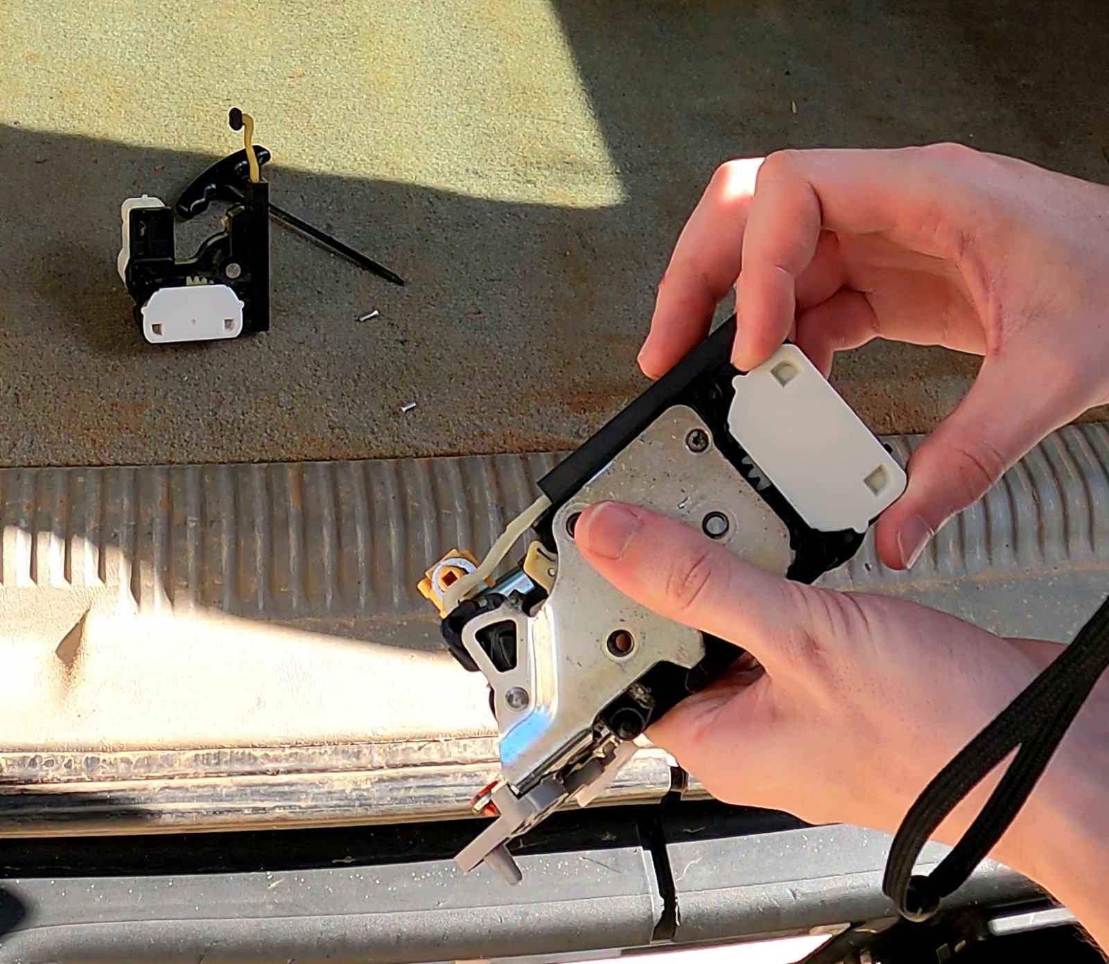

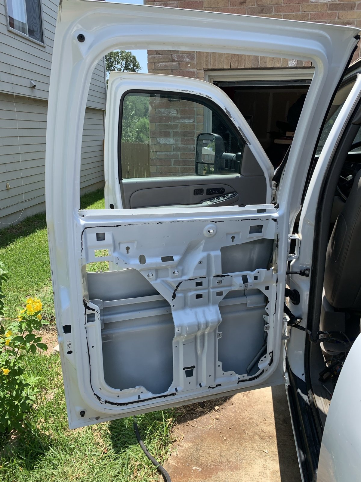

Fixing Door Lock Actuator​
Next up is a much easier one. The door lock actuator in the driver's side rear door went out. After tearing the door down, I saw just how dirty it was and figured I would just take it down all the way for cleaning.
Before:
And after:
Now the actual door lock actuator is a simple cheap part, but if you want to buy a replacement from Chevy, they make you buy the whole thing ($200+!!). Luckily, Dorman sells a cheap replacement of just the actuator so you can fix it yourself. I saw comments about some vehicles having some additional lever on the actuator (in which case you might be SOL and have to replace the entire assembly). Luckily for me the dorman part was all I needed.
Dorman 746-017
Here's me installing the new part (with the old part in the background). Just a couple of torx bolts and alignment of the gear and you are good to go!
I also used some white lithium grease for the window tracks, and some dry silicon spray from 3m for the door lock gears and rubber of the window tracks. Window works better now but still pretty slow going up. Will further diagnose later.
Now all I have to do is tear down the other 3 doors for cleaning... and strip the rest of the interior for cleaning... another day...

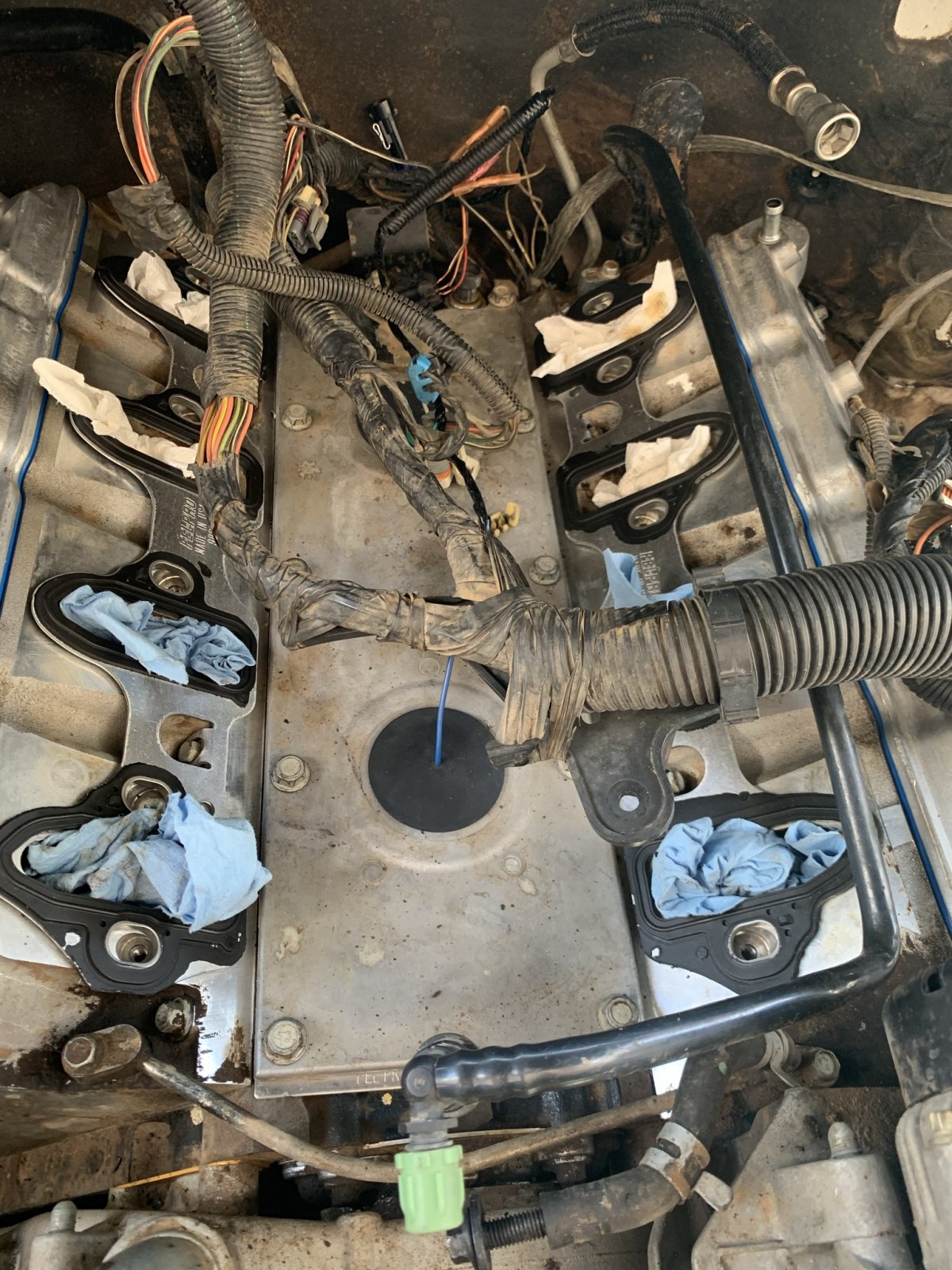

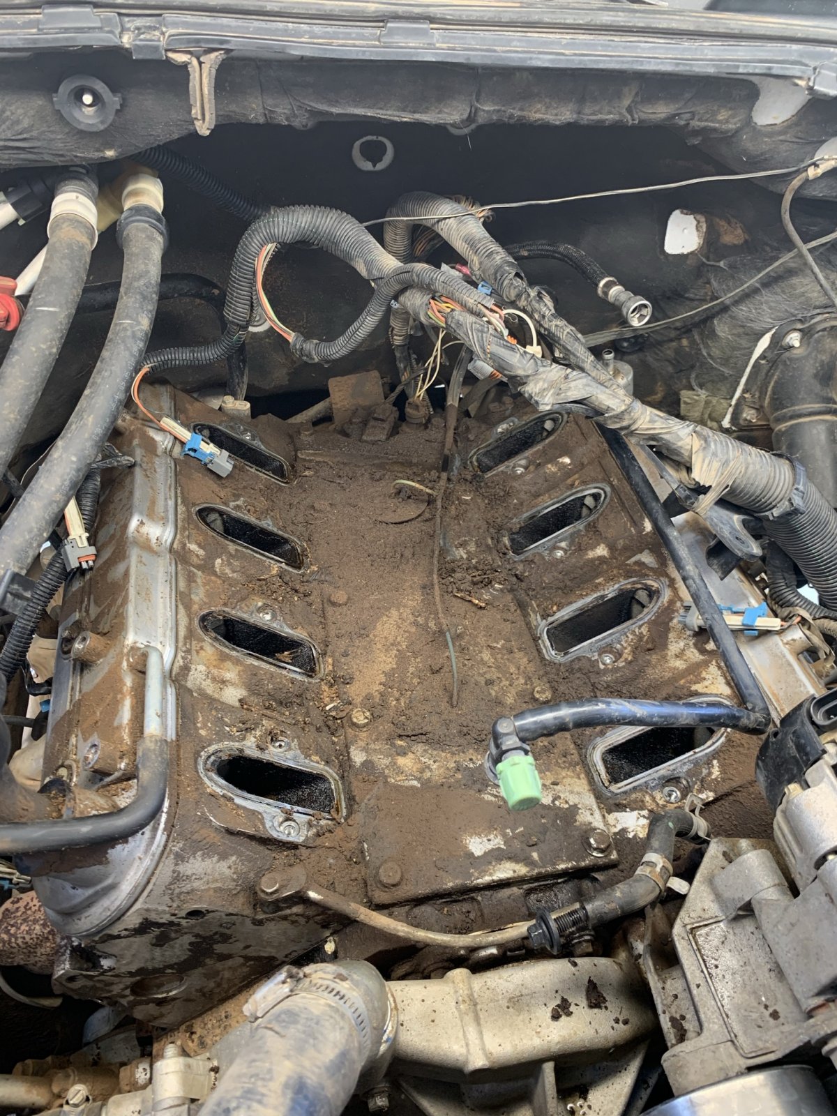

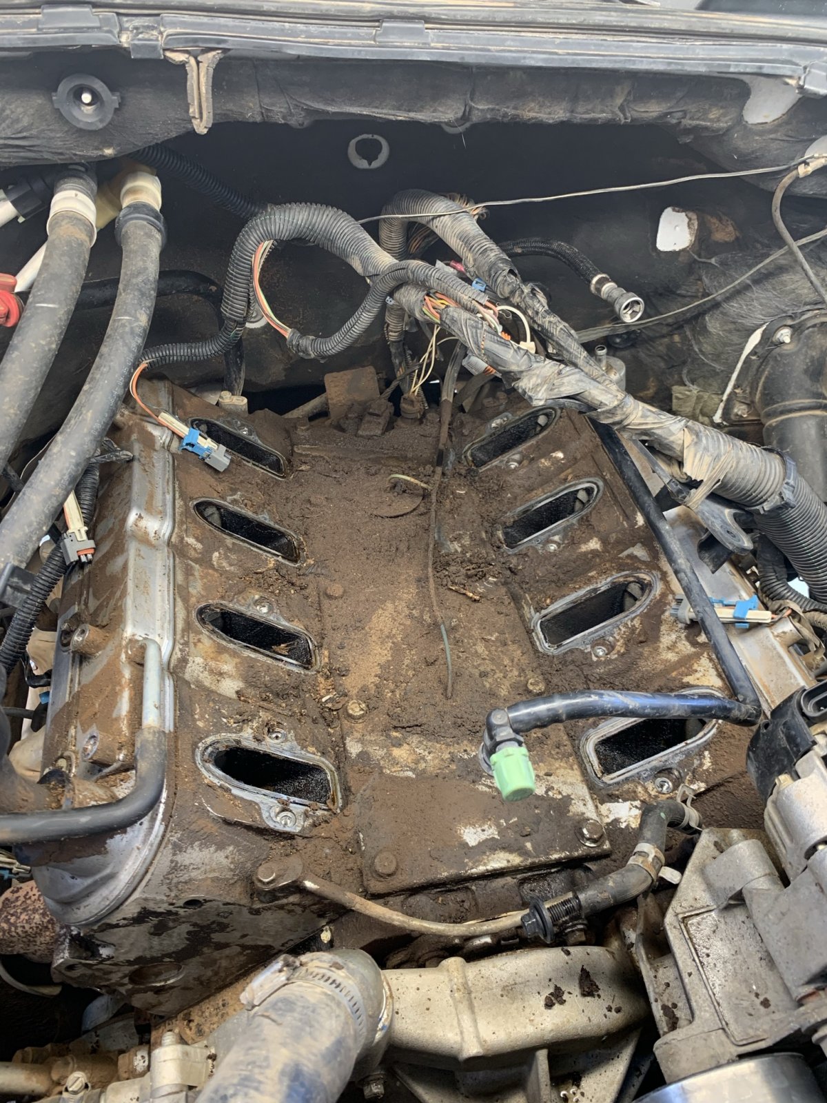

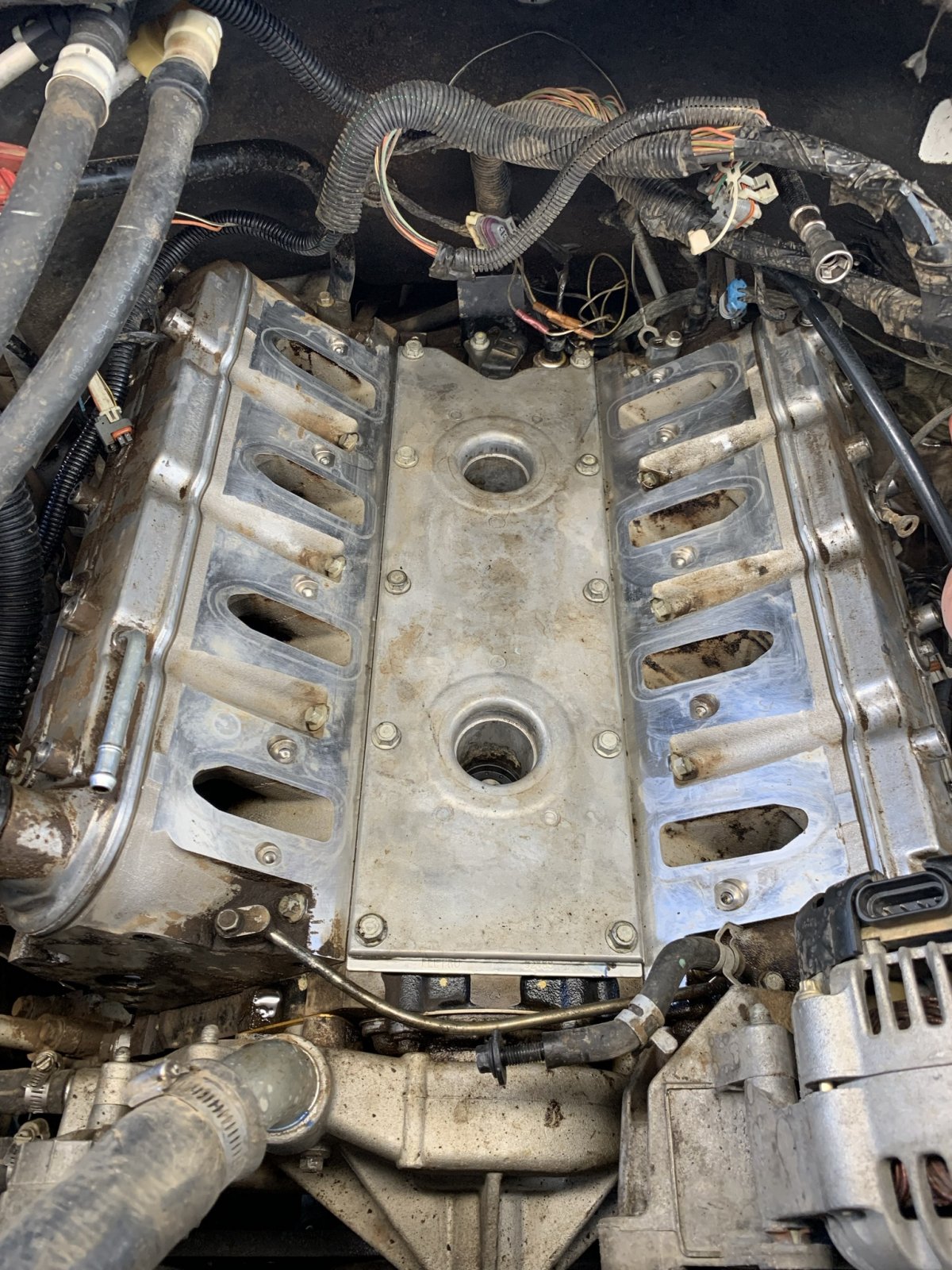

Engine Maintenance: Part 1​
Next it was time to tackle some things under the hood.
Here's the parts list breakdown:
Volant 350603 Closed Box Air Intake w/Scoop
Fel-Pro VS50504R1 Valve Cover Gasket Set
Fel-Pro MS92465 Valley Cover Gasket Set w/knock sensor seals
Fel-Pro MS98016T Intake Manifold Gasket Set (w/ throttle body gasket)
AC Delco 41-962 (8x) Spark Plugs (best LS plugs)
AC Delco 9724GG Spark Plug Wires (check the stamp on your coil packs to ensure right length wires)
Dorman 917-033 Knock Sensor Harness
AC Delco 213-3521 (2x) Knock Sensors
GM 12615914 PCV Hose (Driver Side)
GM 12556932 PCV Hose (Passenger Size)
AC Delco 214-1105 Vapor Canister Purge Valve/Solenoid
GM 17113552 Fuel Rail O-Rings
GM 12570619 Fuel Rail Cap + Schrader Valve (my cap was missing)
GM 217-1588 Fuel Injector O-Ring set
AC Delco PT2782 Replacement MAF Sensor Pigtail
AC Delco PT1798 Replacement Pigtail for Water Temp Sensor

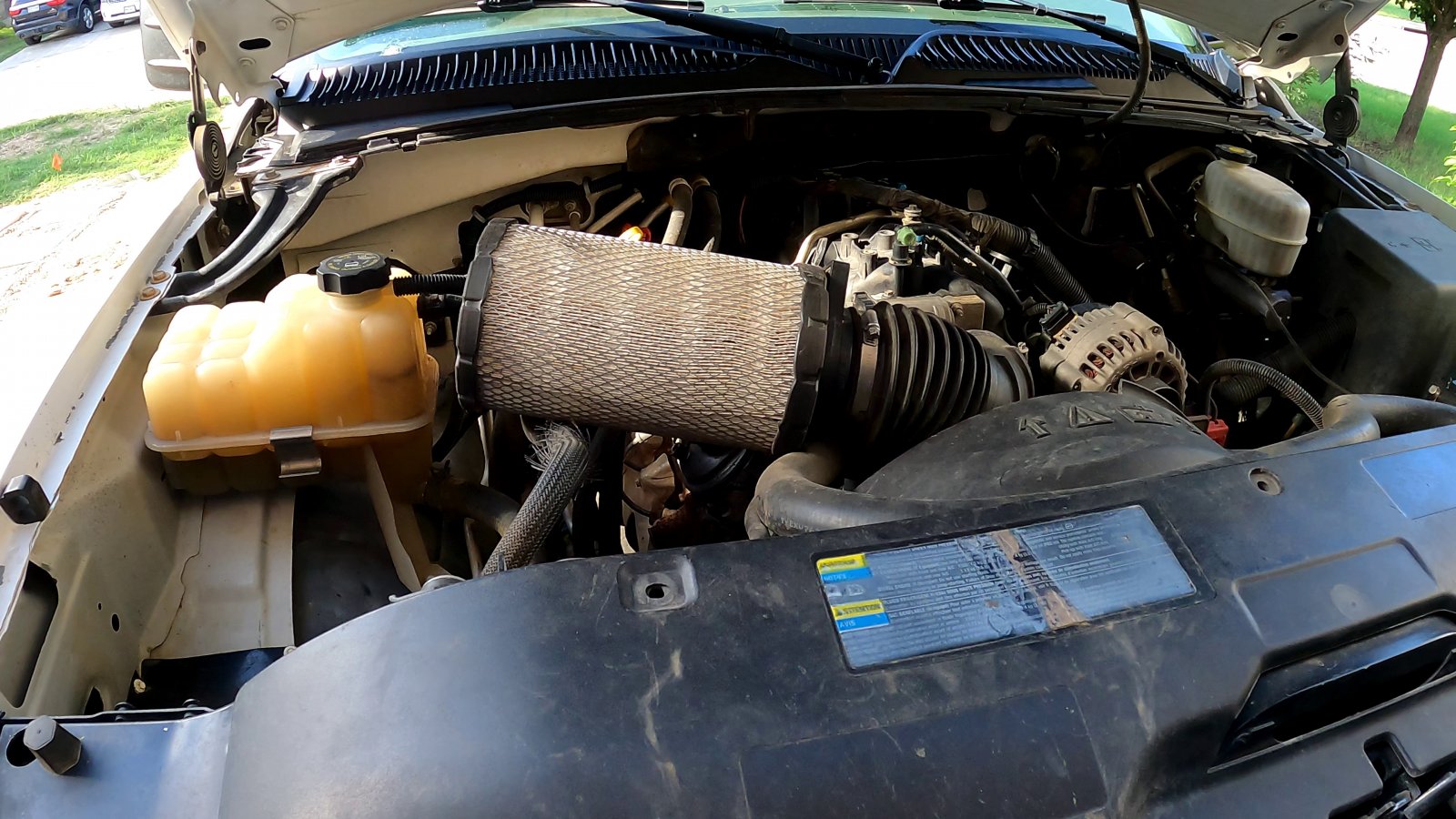

Additionally, a new intake from Volant is on the way (on backorder...) to replace whatever this is...
Okay i'll tell you what it is. It's the factory intake cut short (why???!) with some random filter slapped between the MAF and whatever is left of the factory intake. Oof. Surely it can't get worse?
it can.
Okay not so bad now

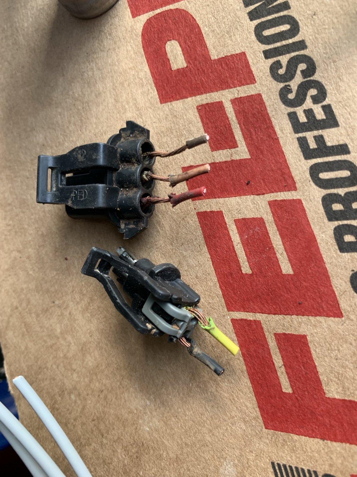

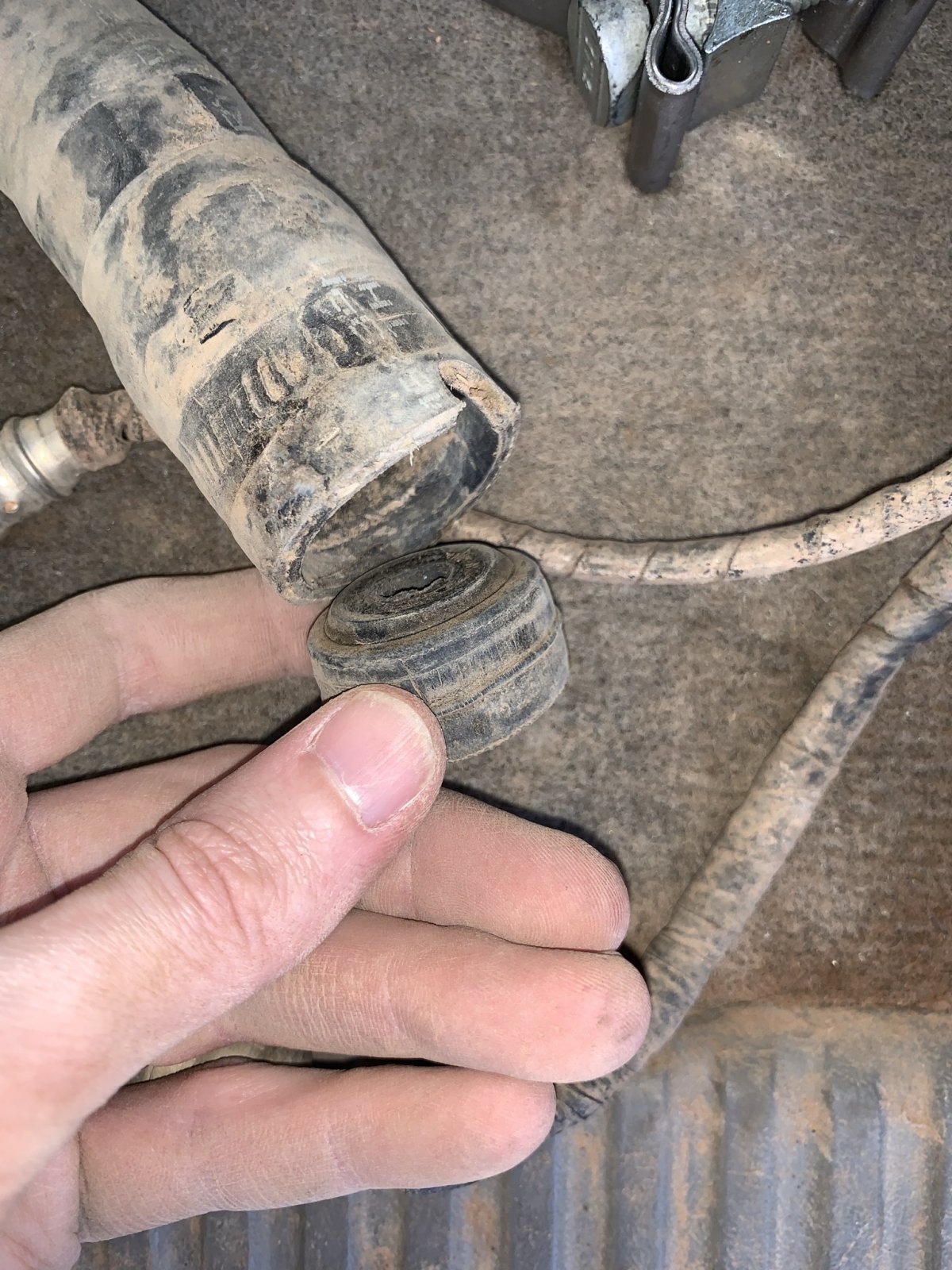

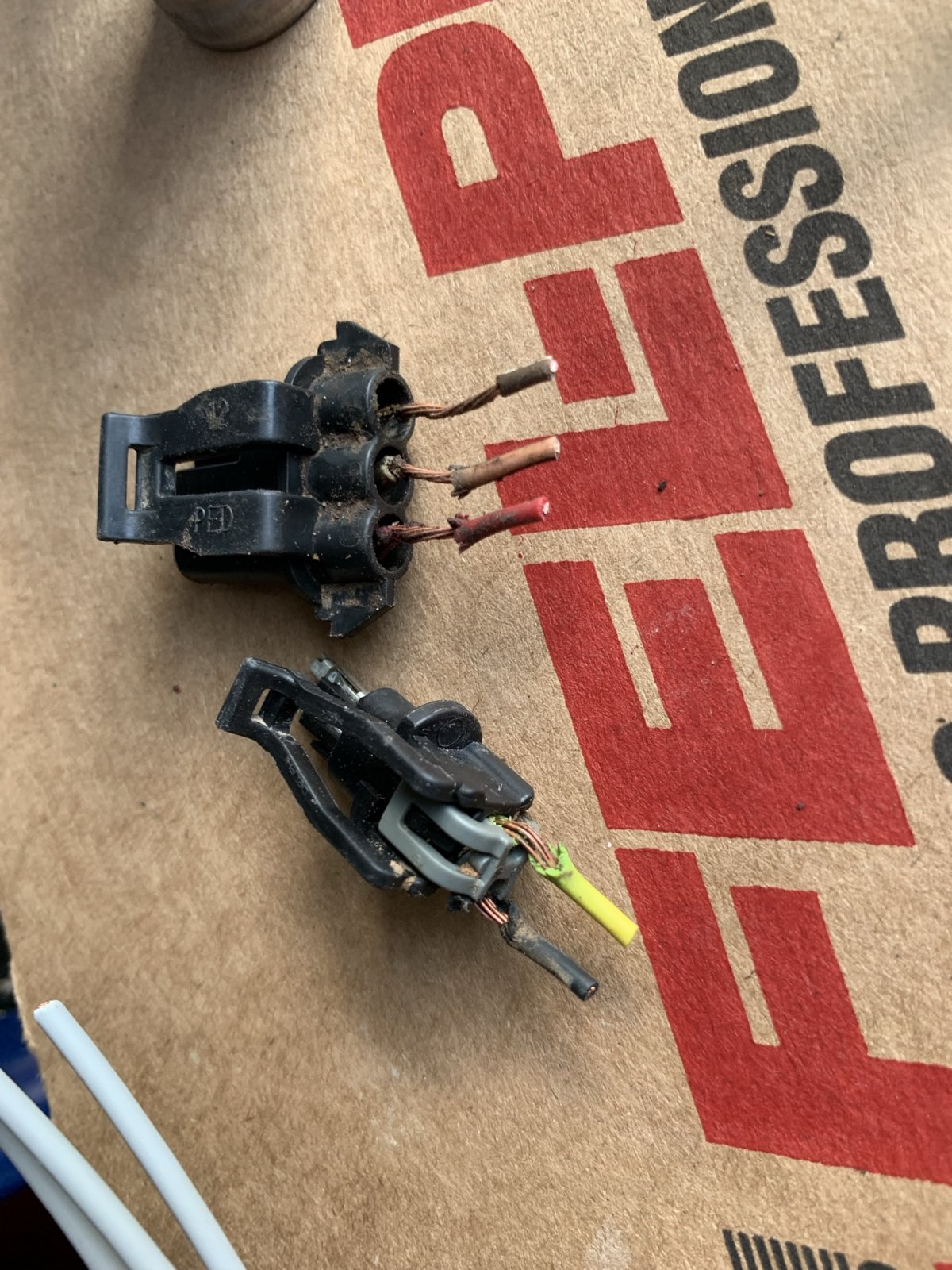

Here's the pigtails I replaced.. falling apart.. missing seals.. exposed wires..
I
imi4tth3w
Jan 14, 2010
386
60
Texas

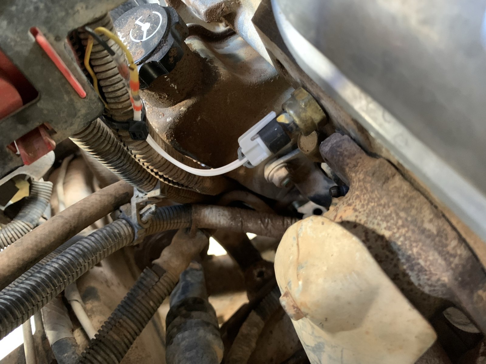

Here's the water temp sensor pigtail harness nice and new again (getting cozy with an exhaust manifold leak). Solder splices make sure the connection stays good and dry.

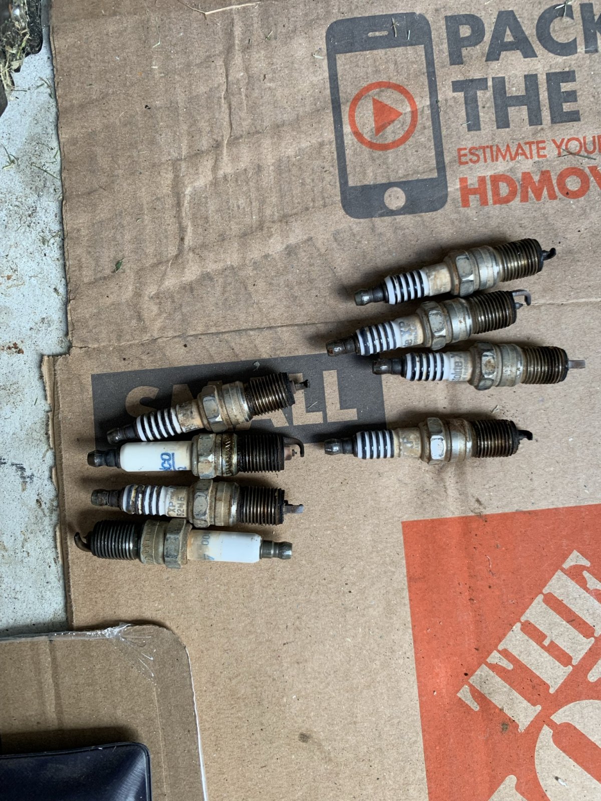

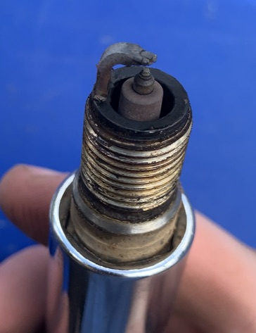

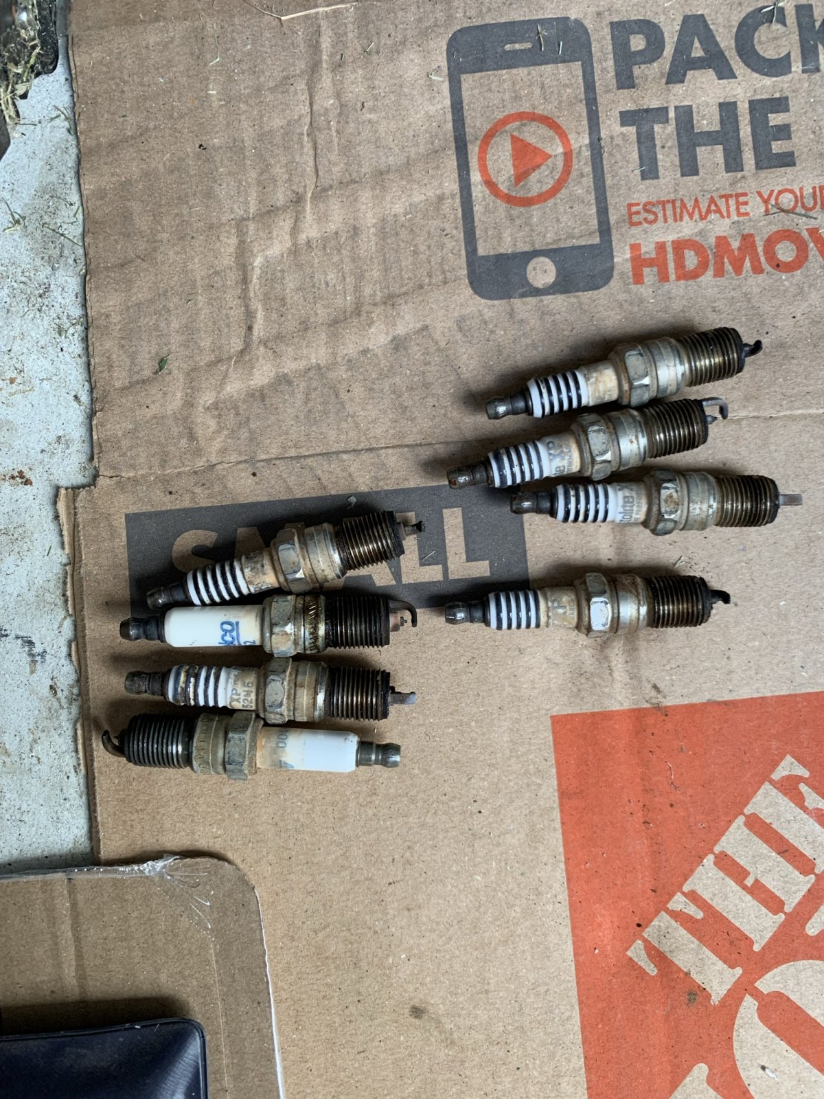

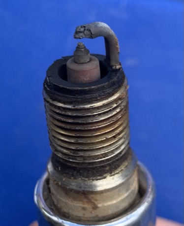

Now more fun stuff. Check out these old spark plugs...
Plugs installed were just a cluster. 6 crappy auto lites, an ac delco 41-962 and an ac delco 41-100. The delcos were in much better shape. But its all getting nice fresh new 41-962s now and fresh plugs.
Here's the engine with much of the parts installed, just before replacing the MAF pigtail.
I didn't get any pictures after this, but I will say it is running 10000% better.

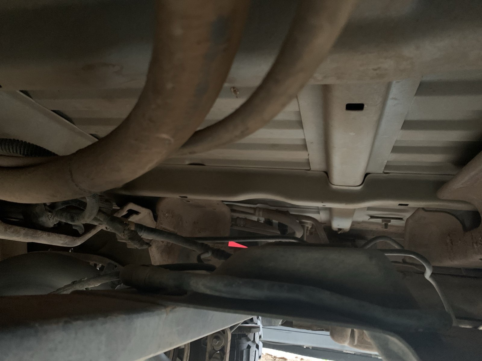

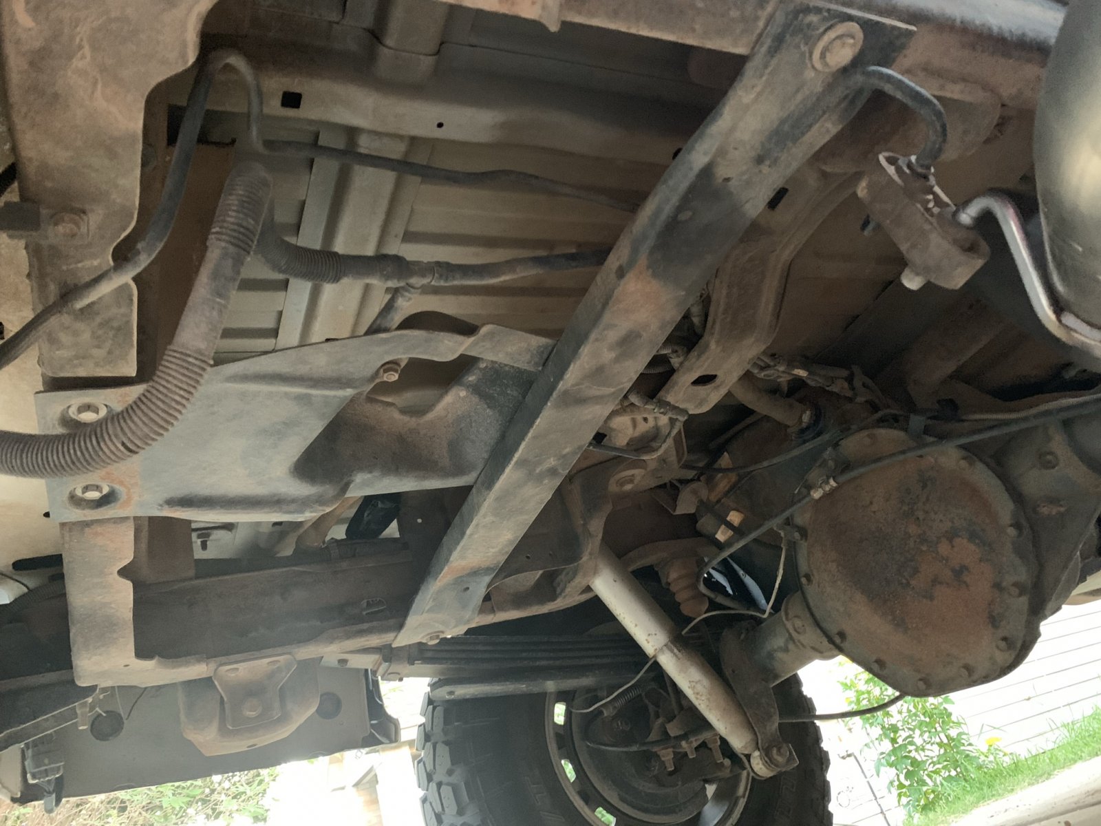

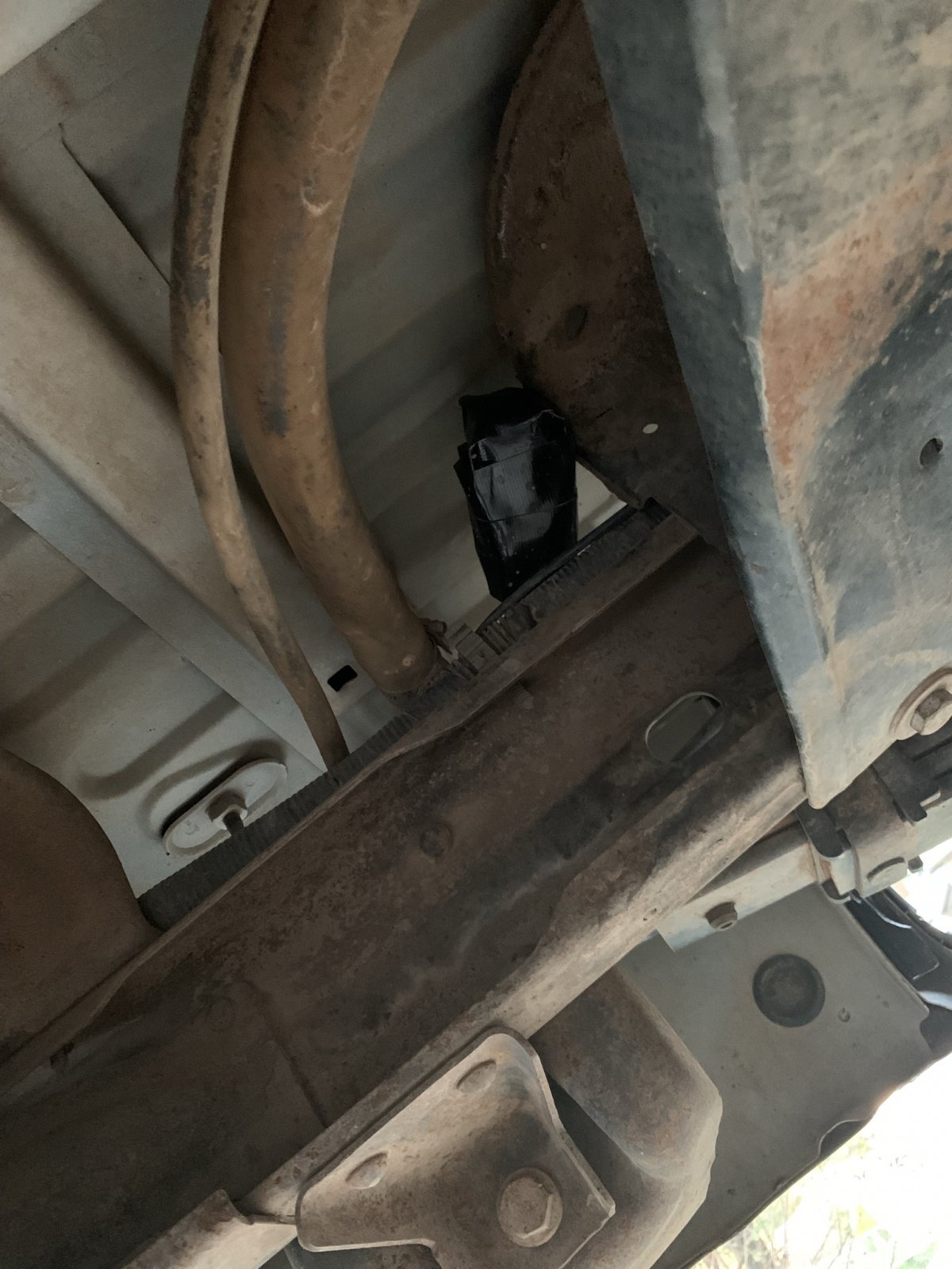

Took some time to look under the truck today to see if I could troubleshoot the fuel gauge issue. I ended up finding some extra hoses and some hacked up plugs and duct tape.. i also read that these 2500 burbs have dual fuel tanks but i only saw one...
i only saw one fuel tank.. the auxillary fuel tank that is supposed to be above the spare tire is literally non existent lol.
Google tells me that the replacement tank part number is 23306963 and runs about $600 + shipping + whatever else i need to install this thing.... fuel pump/sender, fuel tank straps, any hoses or bolts to go along with that, etc... could be worse i guess.
Probably end up replacing both fuel senders while i'm down there mucking around with things. Guessing this will be a $1500 repair.
But i will say i'm just glad i never had any issues in my 500 mile drive home from where i bought it. I will definitely not be driving this thing until i get this fixed. Duct tape fuel lines is just a giant safety issue.

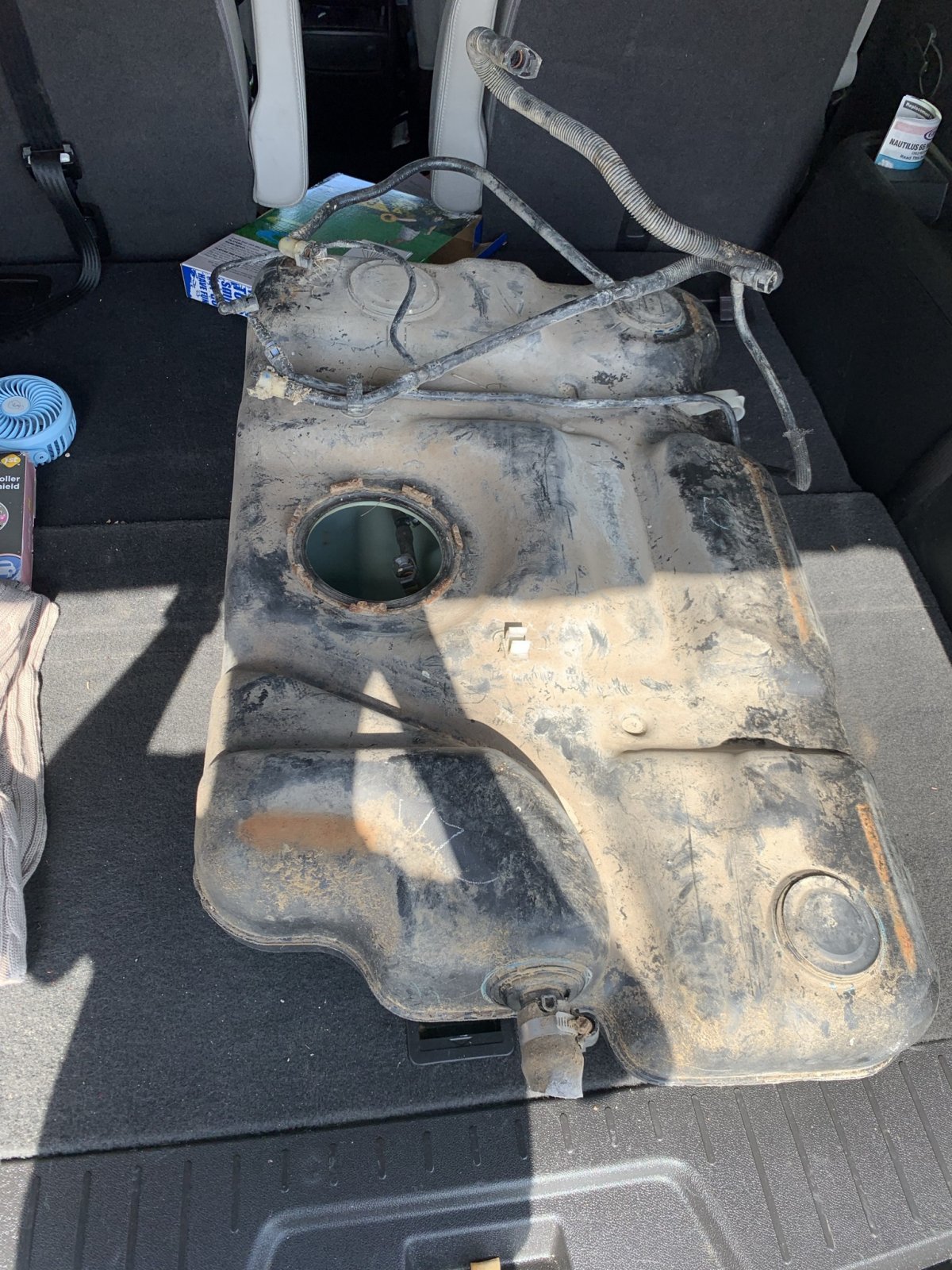

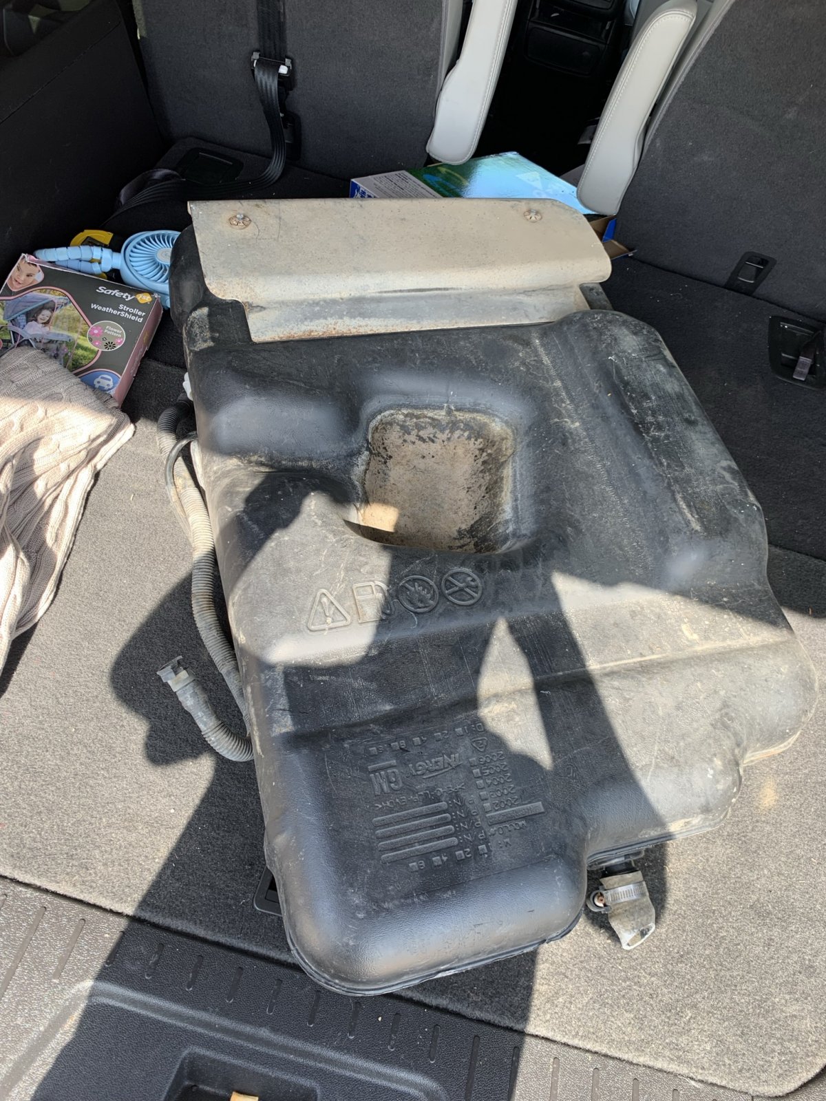

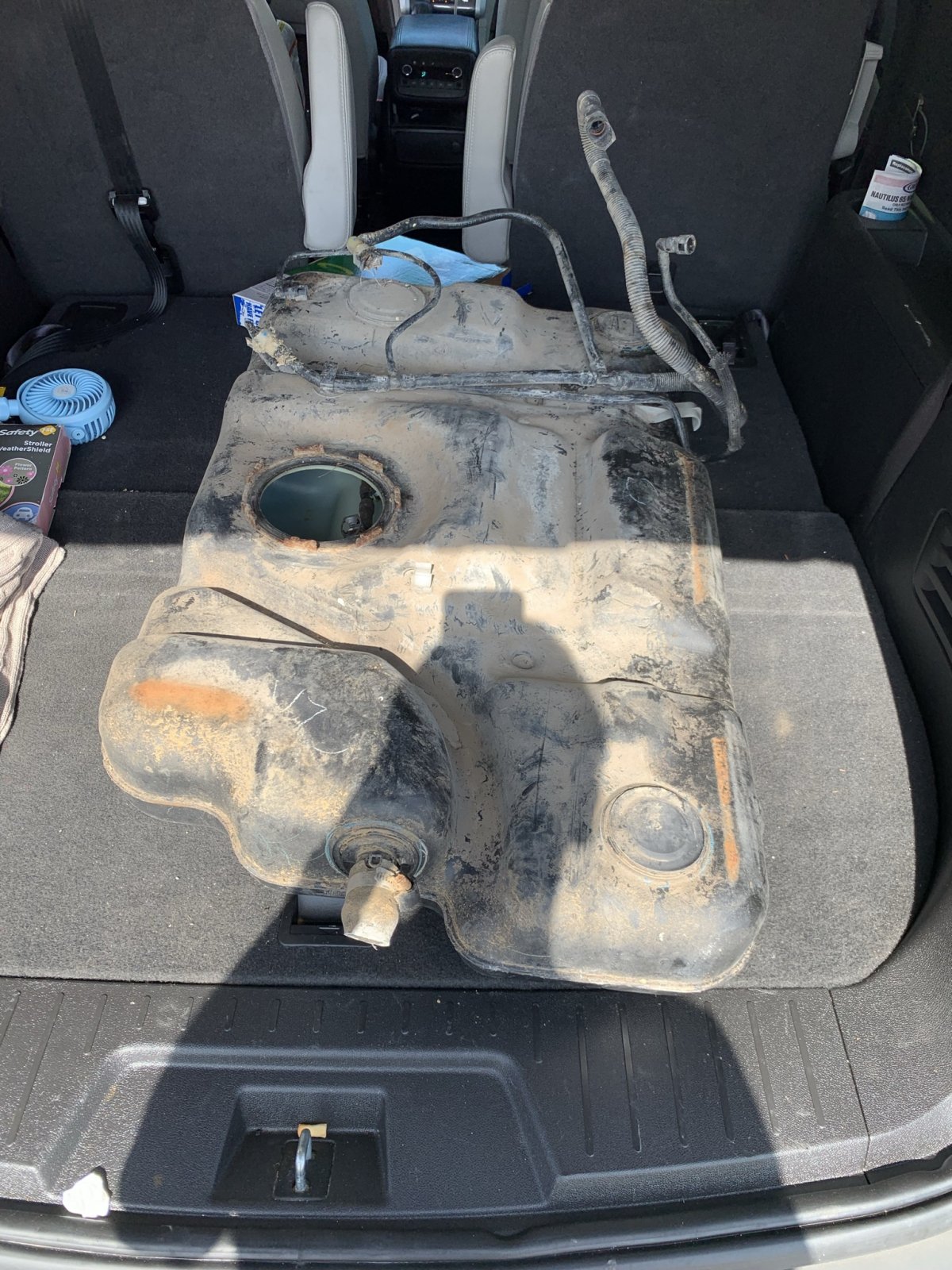

Quick update:
Made a fun 500+ mile drive today to pick up this!
It's a little dirty, but this is the replacement auxiliary fuel tank! (the one that came in my truck was lovingly "deleted" by the previous owner for unknown reasons...)
Tried to find a new one, but it was basically unavailable from GM and on "backorder". Seeing as I highly doubt GM is going to be manufacturing more of these anytime soon (if ever?), i ended up picking this one up from a junk yard for 1/10th the cost.
There's a couple more pieces I need for this puzzle (sending unit, straps, and the big one... ????) so it'll be a minute before i get it under the truck. Definitely glad to have this hard to find part waiting patiently in the garage.
Here's a couple more pics
Still not sure exactly what the fuel capacity is of this tank. Chevy says 15 gallons but most online says its 11. I know for certain the total fuel capacity of this truck is just over 38 gallons and I've heard the main tanks are 27 gallons. Simple math says the auxiliary tank is about 11 gallons.

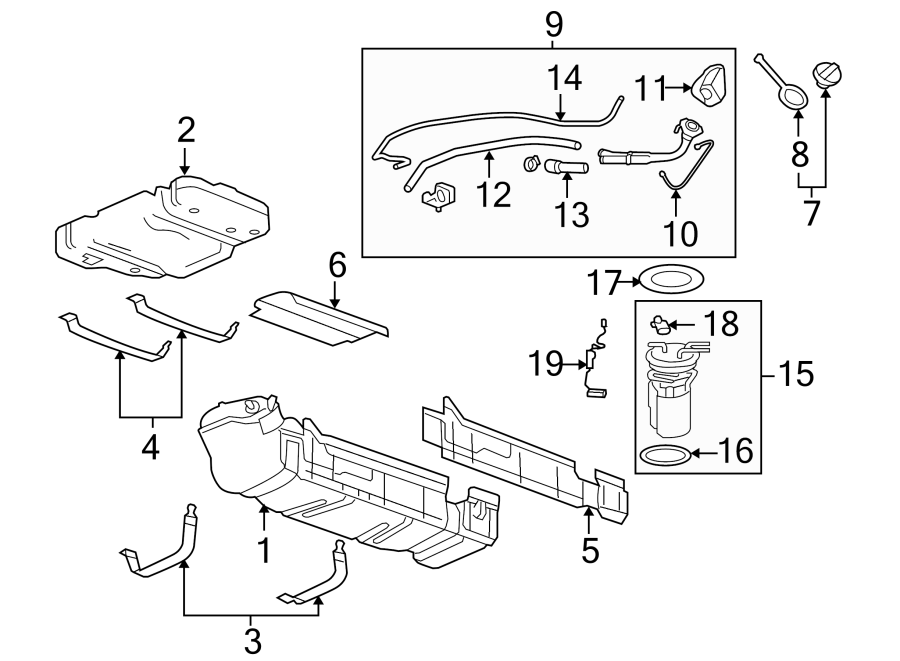

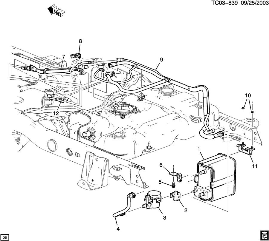

Here's some diagrams I've found.
Auxiliary tank is item #2 (GM PN 2330696)
I believe i'll probably need the following:
Fuel Tank Straps #4 (GM 15757605)
Fuel Tank Strap Bolts (not shown) (GM 11515767)
I'm having trouble finding diagrams of the fuel lines for this dual tank system so i'm really hoping i have everything i need. worse case some weird hose or something is missing and there's no way for me to get a new one which would really suck. Although i supposed i could always use aftermarket parts to make it work.

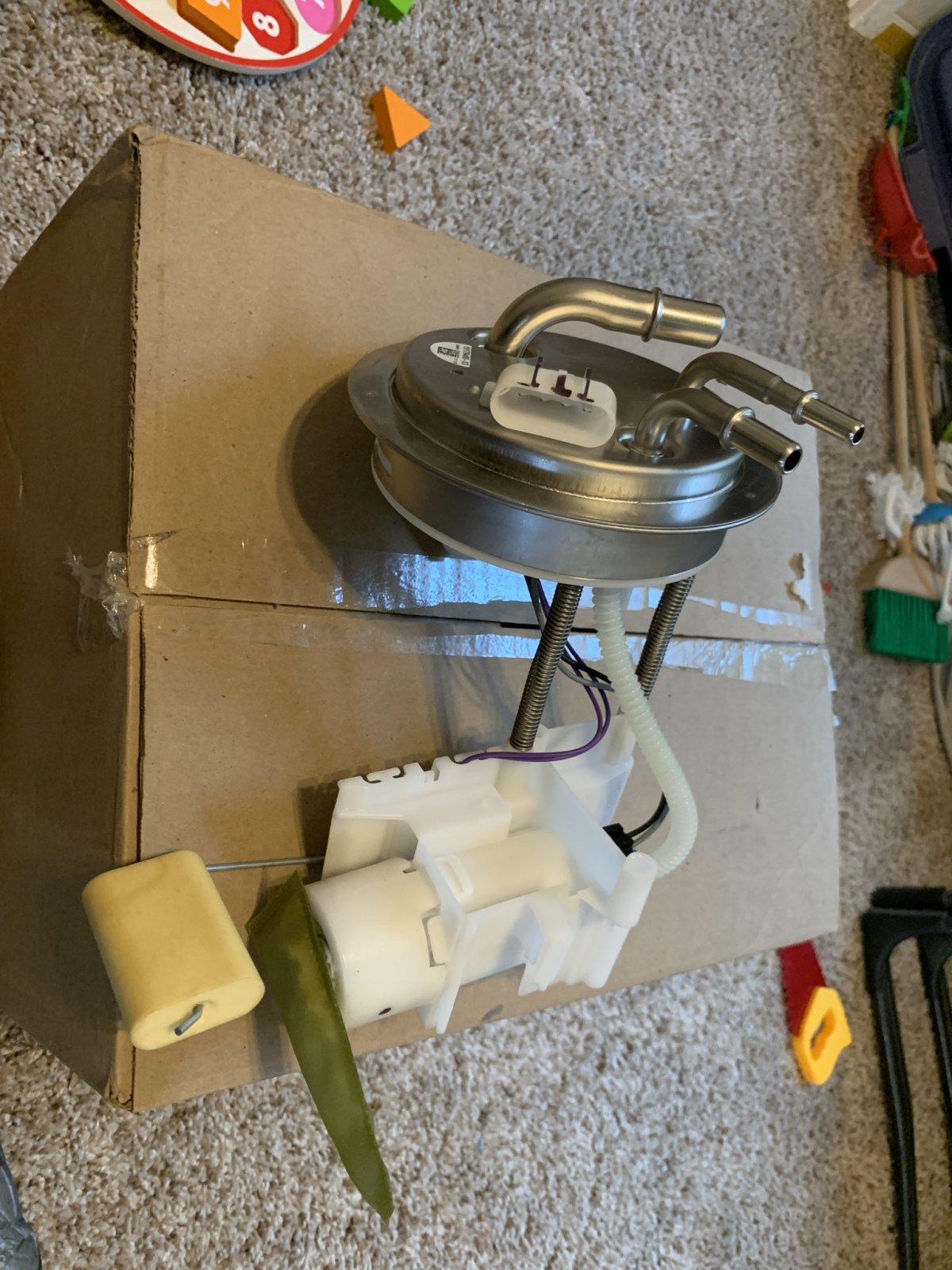

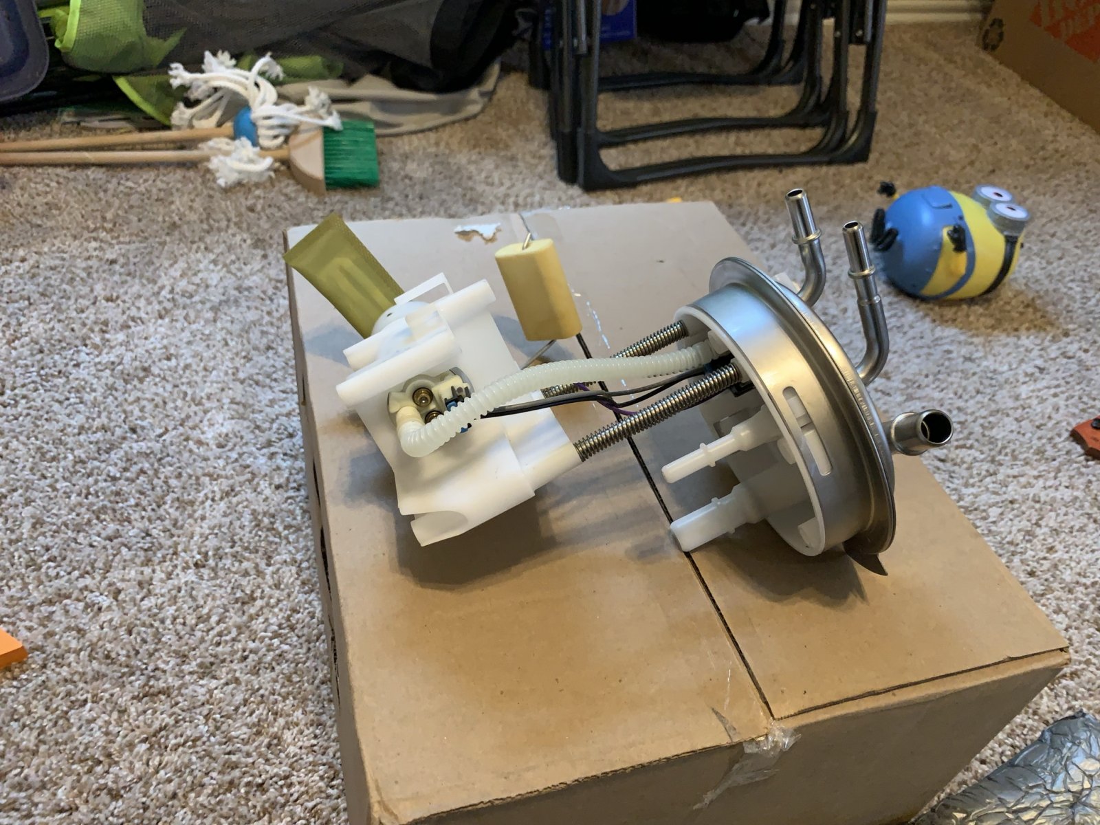

more updates!

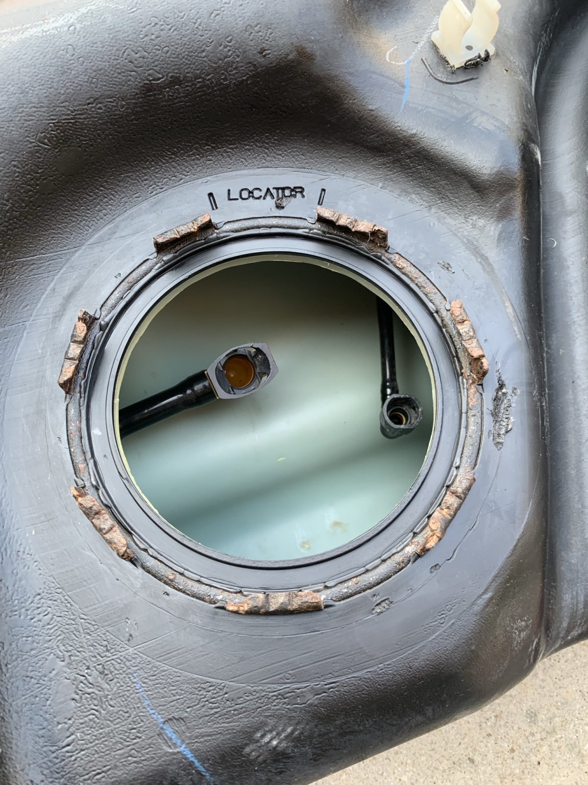

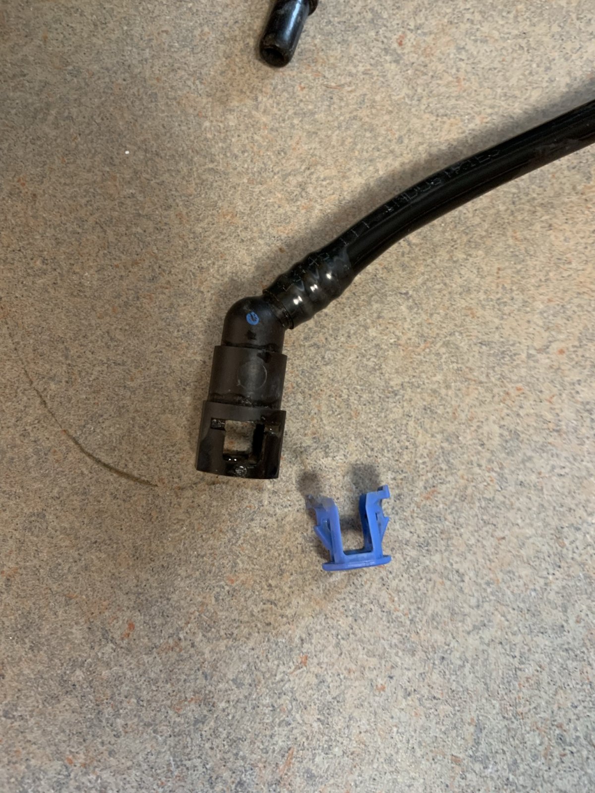

Got the aux fuel tank cleaned up and a new fuel sending unit in.

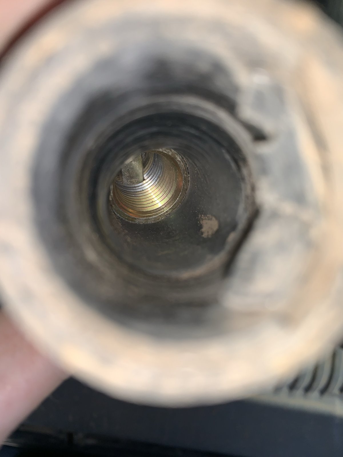

There's two connections inside the fuel tank
The small one is unfortunately missing a small fitting. It came with some extra hoses but it looks like this blue clip is 3/8 and i need a 5/16. Amazon should have me a clip sometime tomorrow
I also found a great diagram of the hoses for the aux tank so it should hopefully be smooth sailing to install everything.
I also picked up a new sending unit for the main tank so while i wait on this clip i should hopefully get the main sending unit replaced tomorrow.

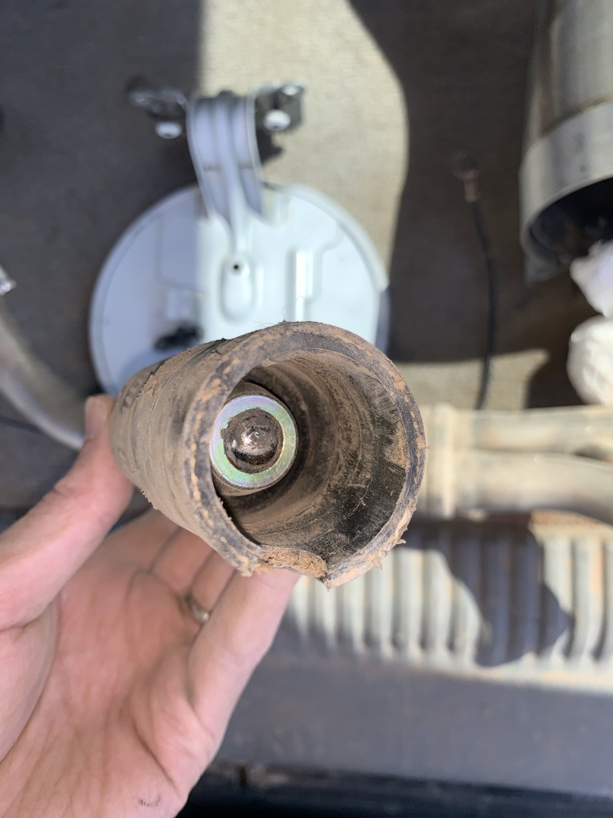

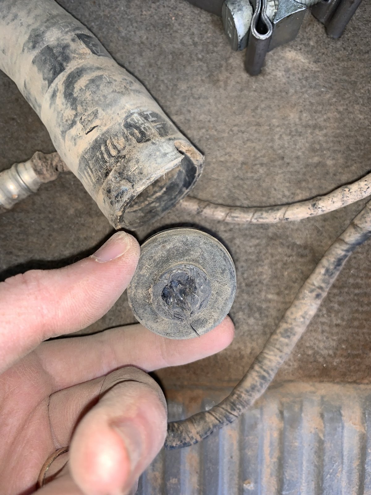

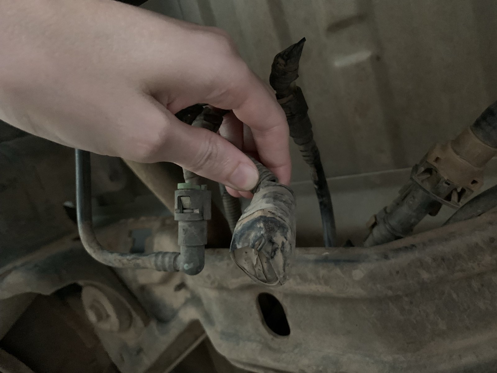

So this weekend was certainly... interesting..
to start, i went underneath the vehicle to remove some duct tape. Found this in the aux tank fuel filler hose
I'm assuming the previous owner was using all this to block off the hose... just seemed really random.. But it looks like i'll need a new hose. Gotta call the dealership to figure out the part number as the online search tools are all ******* up for these trucks (doesn't even show this has dual tanks?)

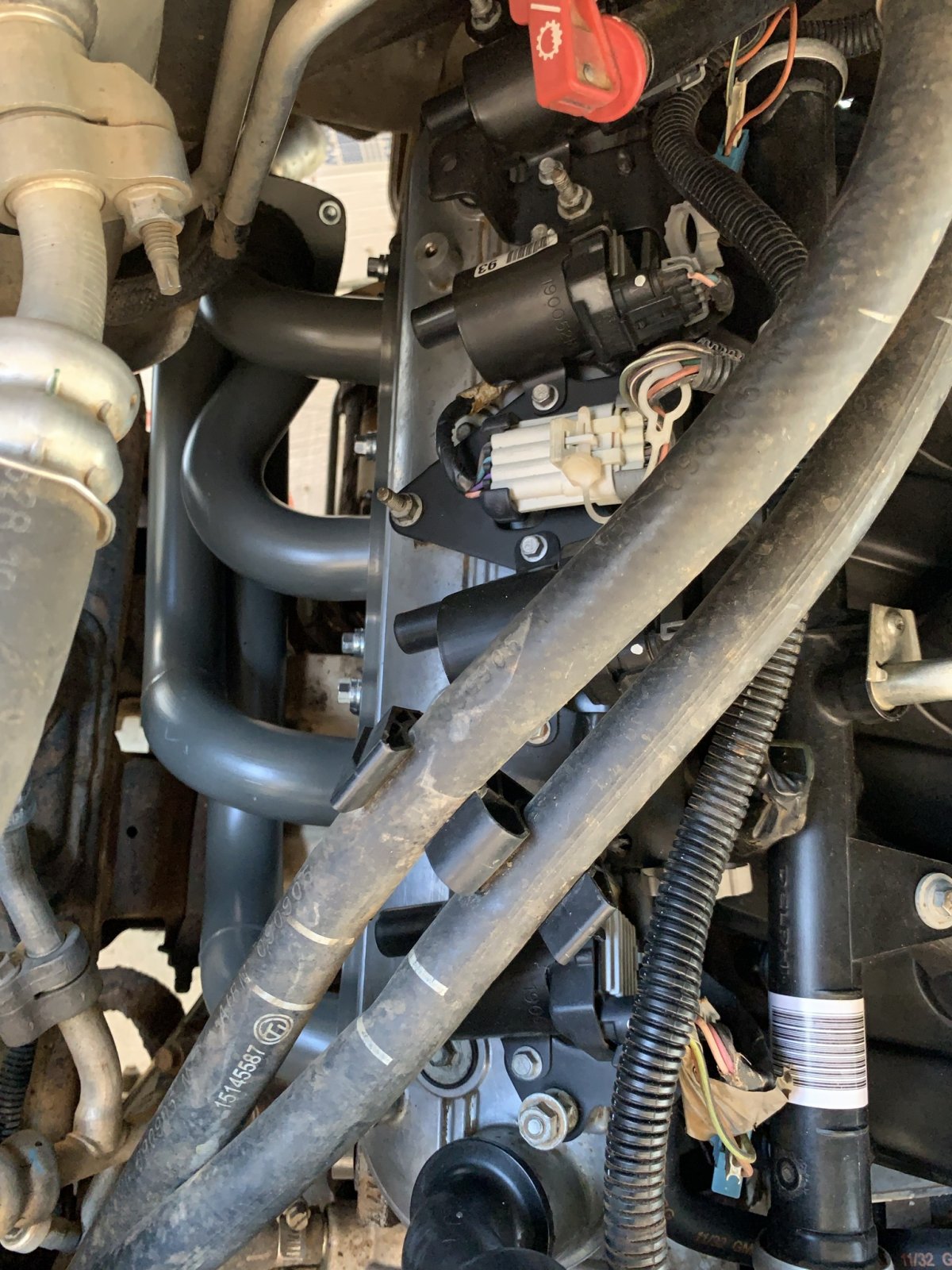

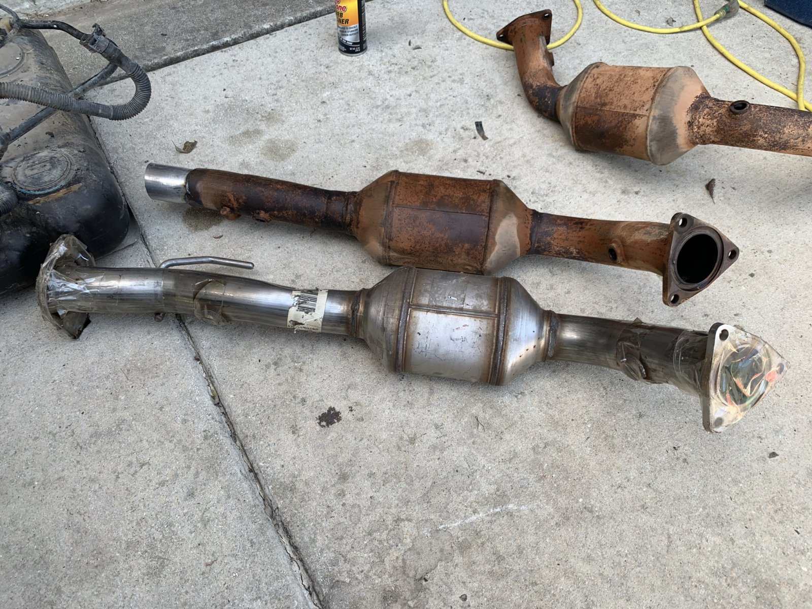

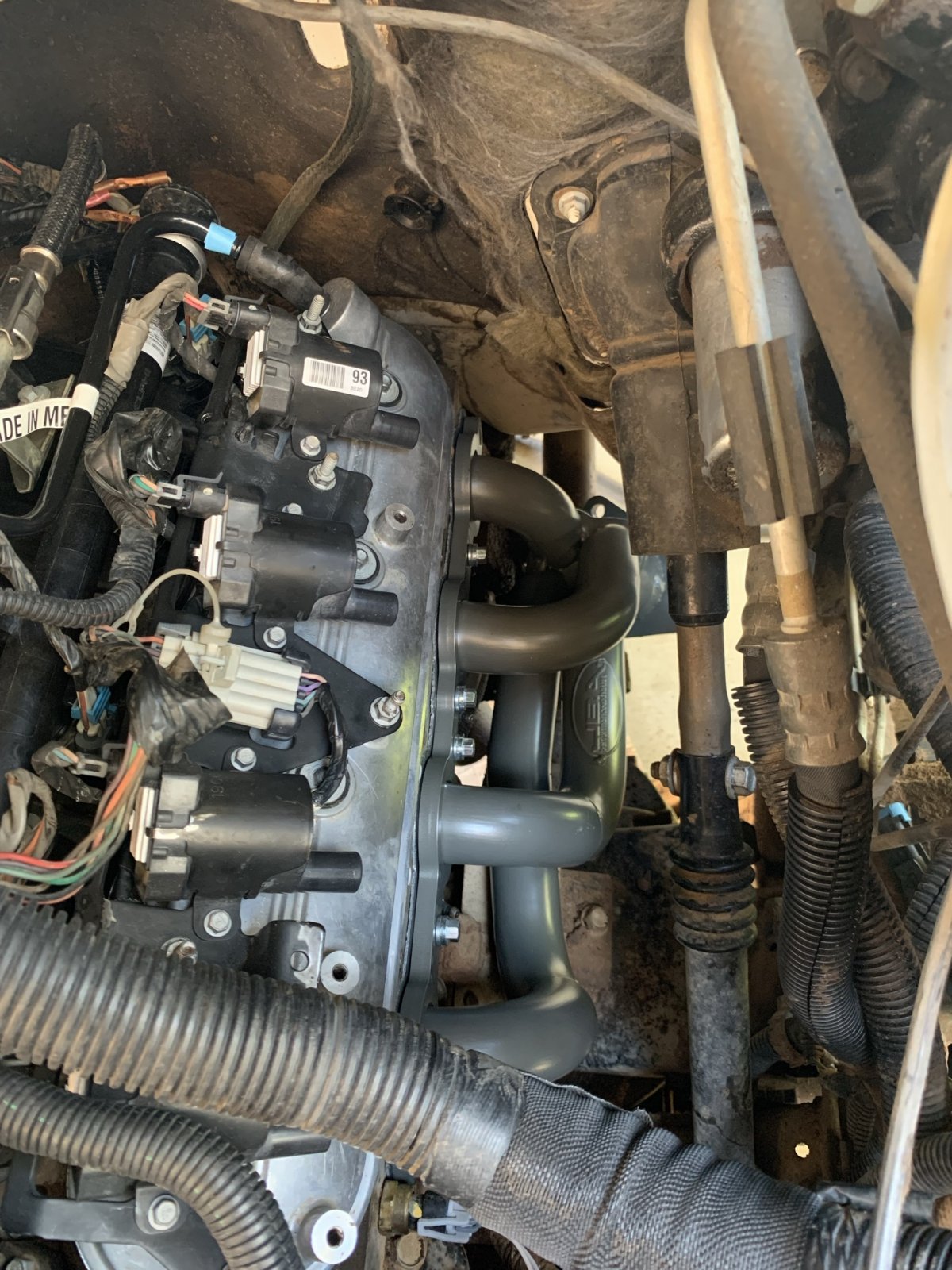

I went ahead and splurged on some nice JBA ceramic coated short tube headers! Passenger side original exhaust manifold has a stripped bolt where it bolts to the cats so i figured might as well.
I had previously removed the passenger size exhaust manifold and found that the missing bolts were just not there (instead of being broken off in the head) and assumed the driver side would be the same story.... not the case.
Drive side exhaust manifold has two broken off bolts deep in the head (front and back side bolts of course). Plan is to get the dorman exhaust manifold support brackets for now as i'll need to pull the engine to properly drill and remove the broken off studs. Although i might pull the engine sooner than later as the rear main seal looks like its been leaking like crazy. Hard to tell right now with all the grease still coating everything down there. More work with the power washer in the near future..
So other than the broken bolts in the head, the header install went very easily.

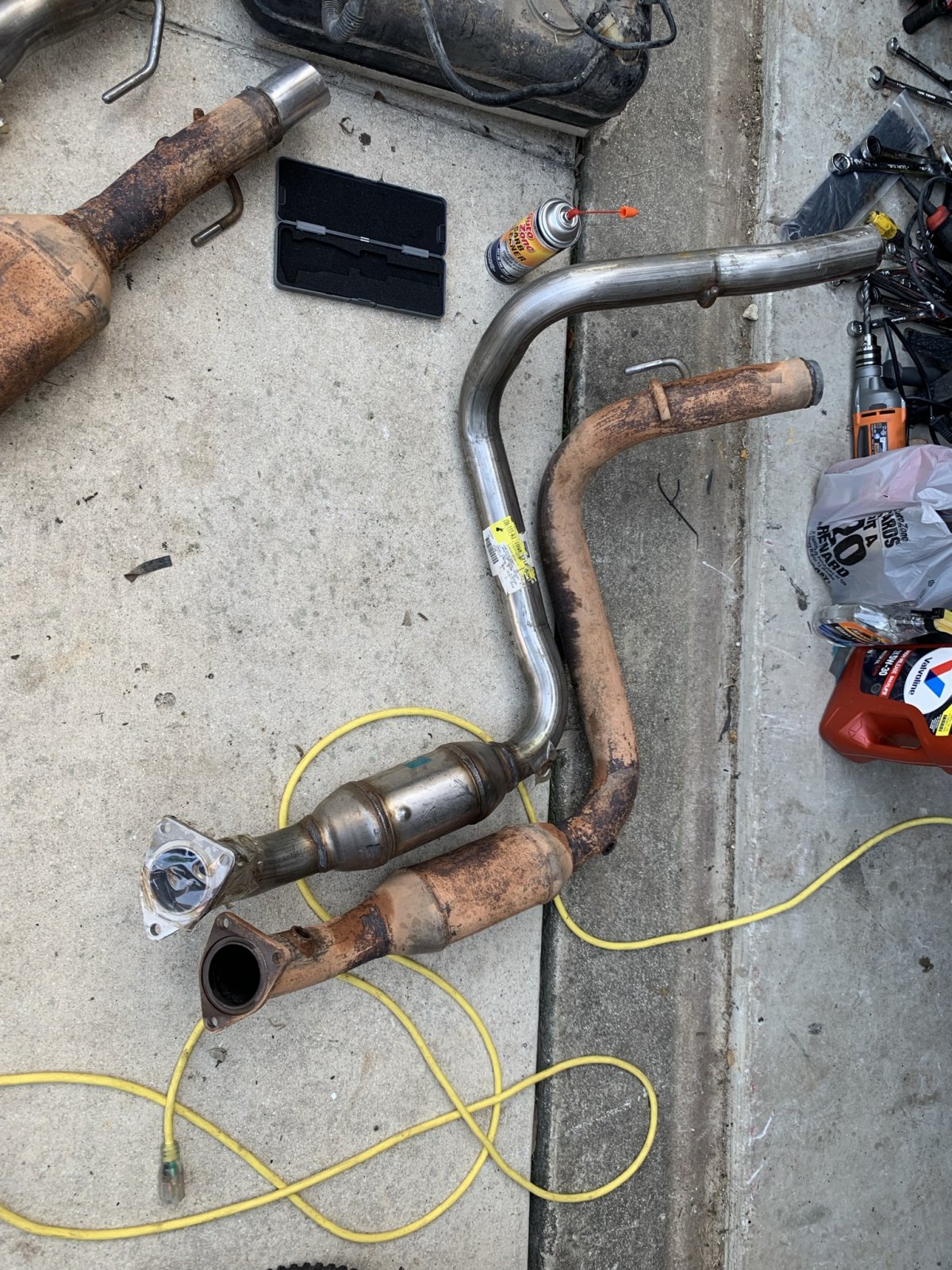

Next was to bolt in my new catalytic converters. All my research got me the part numbers of 10395213 and 10395214. Well it looks like these are the part numbers for the 1500 trucks that came with the 6.0 and not the 2500..... Its like they ALMOST fit but there's a couple strange differences. The driver side 10395214 cat had 2.5" pipe instead of 2.75". The passenger side was 2.75" but the exhaust hanger was completely off.
So after a call to the dealership so they can look up my vin number, the actual part numbers are 15793201 & 15793200. They quoted me $1200 + $400 core charge.. each.. and the cores have to be 100% unaltered or they won't accept them... yikes.. and i still need to figure out how to unload these wrong cats i got. I was really excited when i saw the pair for $900 on ebay but it was too good to be true.
But i did at least get some validation that the cats in this thing were done. If you knock on the original cats they seem hollow, but had no signs of being modified. Not sure if the catalyst material inside them just deteriorates over time. The new cats i got were nice and solid when you knock on them.
Anyways not sure what i'm going to do about the cats for now. It also exposed just how bad a job the exhaust shop did. You can see they didn't even seal the weld around the whole exhaust (just visible in the above pictures).

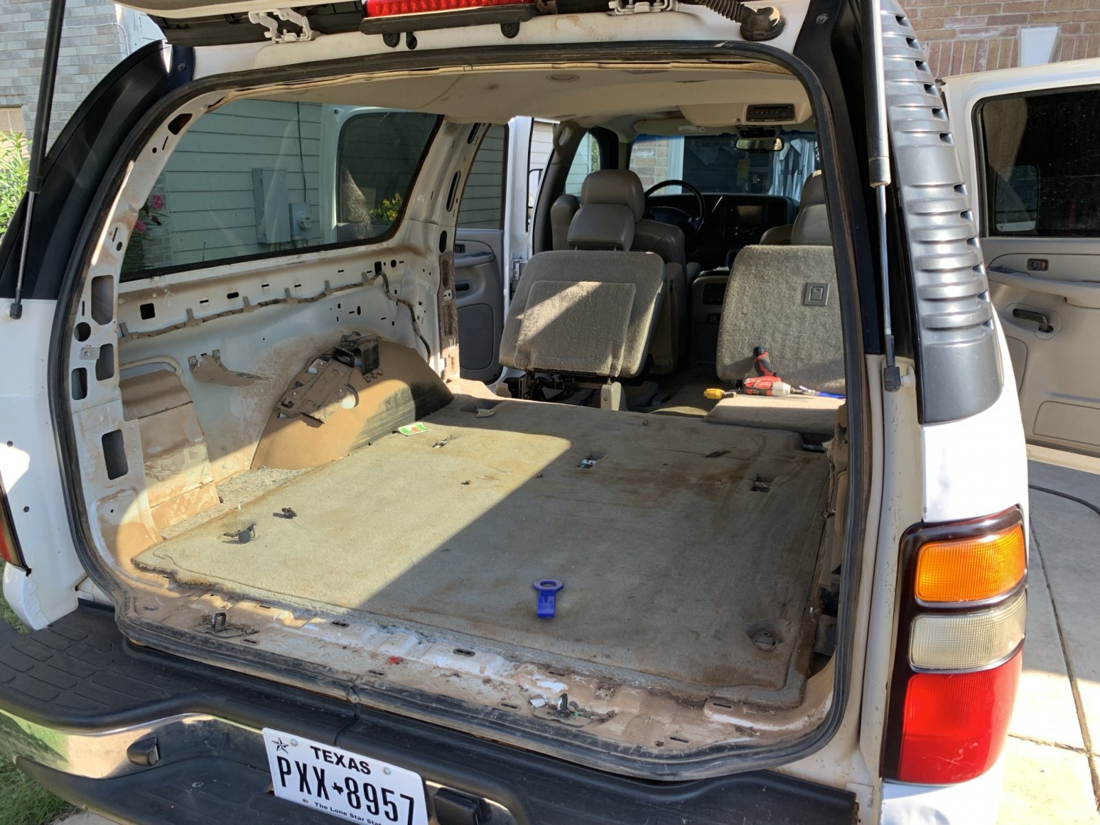

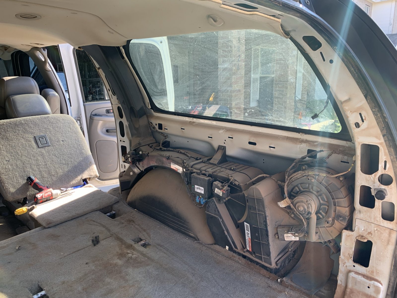

Made some progress stripping out the back of this thing. There is thick dirt EVERYWHERE.
Its going to be a real nightmare tearing down the rear AC for cleaning. But, i'll be happy i did with how dirty this thing is..

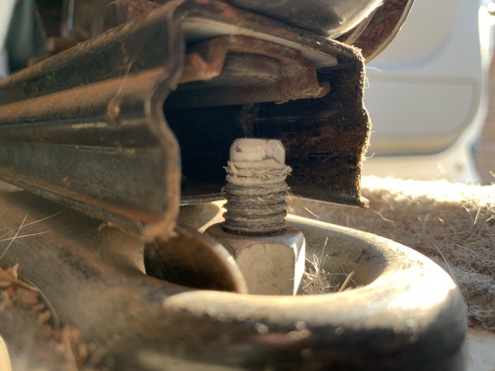

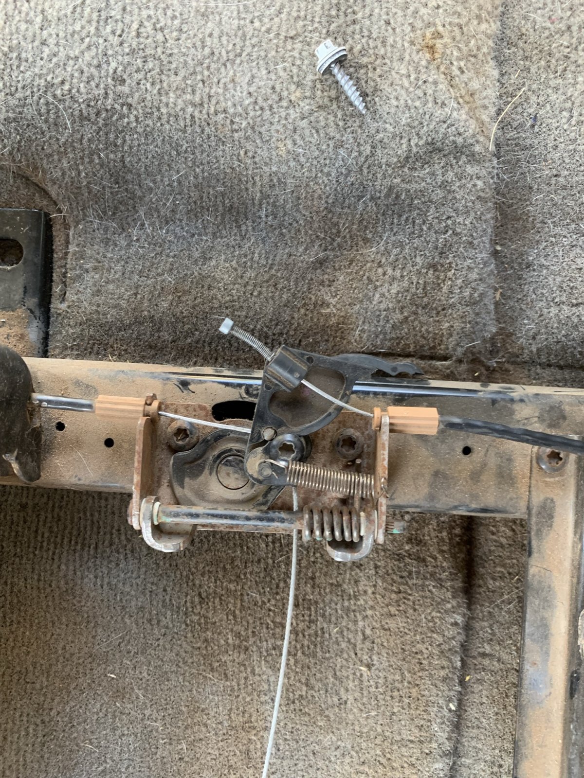

Also, for those who got stumped like me removing the passenger side 2nd row seat, it can slide forward!
This is the bolt i could not figure out how to remove
I then realize this mechanism here allows this seat to slide forward. This was only found on the passenger side and this is presumably to allow the seat to slide forward and load passengers into the 3rd row.
Of course my mechanism was also broken, so i had to manually release the "claws" in order to allow the rail to slide forward for seat removal.
I superglued the piece back together but it still doesn't seem to be operating correctly. Going to leave it as is for now and worry about it once i get things put back together.
That's about as far as i got this weekend. The biggest issue with tearing down the interior is finding a place to put all the parts while its disassembled for cleaning... The things i would do for a nice big shop to work in lol.
That's it for this week.

Edit. I answered my own question. I can see leafs in one of the pictures. Nice truck have fun building it up

Can you have the new cats welded to the old pipes? You can sell the old cats to a scrap yard--for good money.
