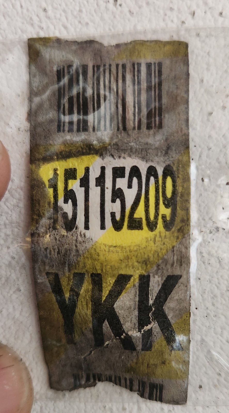

I learned how our rear coils springs are different, to work with whatever shock option you are supposed to have. If a rear shock was changed, the springs MUST conform to the weight/strength of the shock requirements, or the ride can be ruined and/or unsafe.
Specific OEM shocks are designed to assist with the SUPPORT of the rear weight, some are not. So, some coil springs are either stronger, or softer.
Maybe, the factory decal, on the coil spring is still readable..... ( It can be removed to read the part number.... maybe I was able to rear my decal after removing it.
My coil spring decal.... ( The number is the important part )
Moderator
16,282
33,657
People's Republic of Colorado
Bingo; it came with manual self-adjusting shocks ("Nivomat" "Sachs") and softer coil springs in the rear.
ZW7 = Premium Smooth Ride
G65 = Nivomat rear shocks (with companion ZW7 softer springs)
Replacing the self-adjusting Nivomat shocks to standard requires also changing the springs or things can get squirrely, as you're experiencing. So either Nivomats need to be re-installed or the springs need to be changed to a Z71 or standard spring.
G65 = Nivomat rear shocks with softer springs
In short.... Nivomat or other "adjusting - height" shocks are more firm as they are more of a supporting - weight shock, so the springs are softer.
