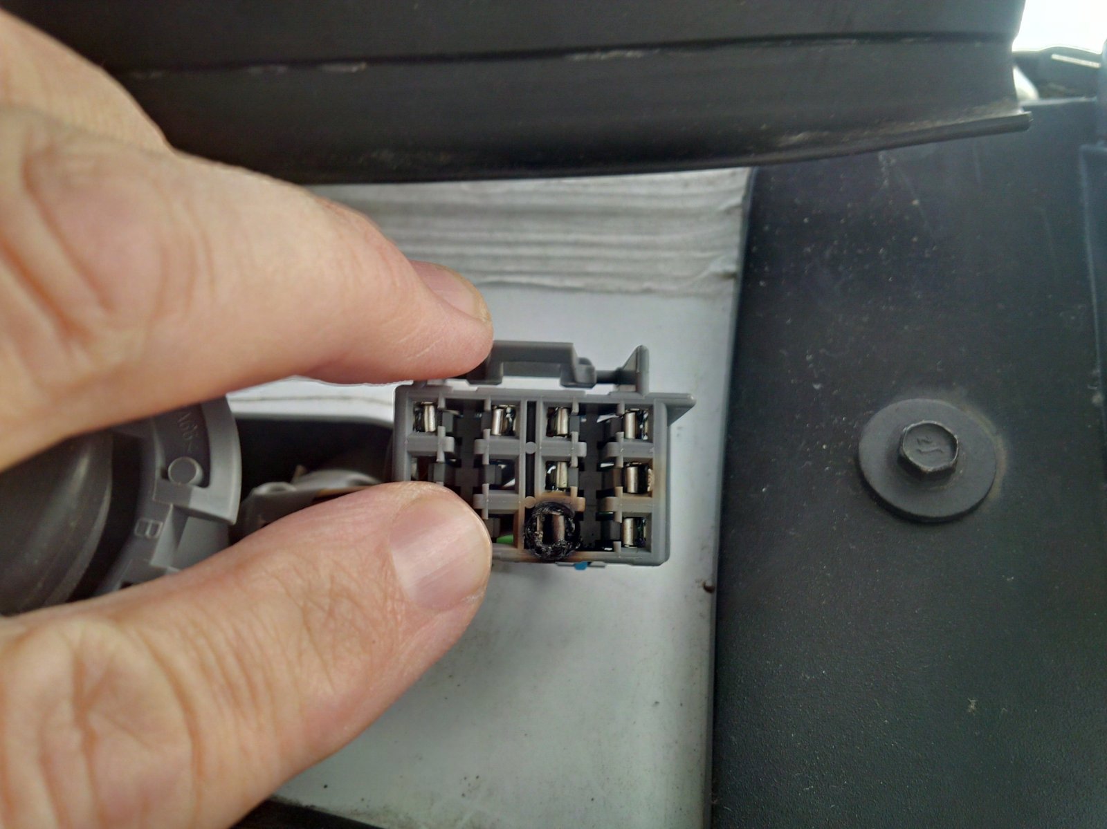

I found the connector, and the defog wire in the connector was badly burned. Unfortunately, I don't think that's the end of the trouble. When I put the volt meter on the good end of the wire, I still only got 6V which means there is a bad connection further up the line.

Here is a picture of the affected connector. Once I removed the burned out terminal, I measured the voltage and got 6V or so. I'm going to check at the relay at the engine bay fuse box.

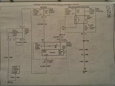

Finally found the wiring diagram I needed. In case anyone else has the same issue:

That was the diagram i was referring to. As you mentioned, i would check the voltage at the "front" of the system. I cannot remember off the top of my head what the voltage is and what the drop across the system.
I believe on moon roof tahoes the harness runs down the drive side kick panel, under door seal panels, through the jack panel, and up the D pillar. I am not 100% sure on the actual location.

I've got a good 12v at the fuse. The next place to look in the connection at C1 as that is the only connection between the the fuse block and the connector at the the lift gate.

I was unable to clean the female terminal adequately. When I tried to remove the terminal from the connector, the terminal actually pulled out from the wire because the plastic connector was blackened and melted around the terminal. I will probably need a new connector for the female side. I can fairly easily clean and save the male side.

okay, time to eat a little crow here. The ground I was using was not a good ground and was fooled into thinking I had a problem farther upstream.
I measured the resistance between the fuse box and the heater wire to the rear window and got zero resistance. I only have to fix the connector at the lift gate.
