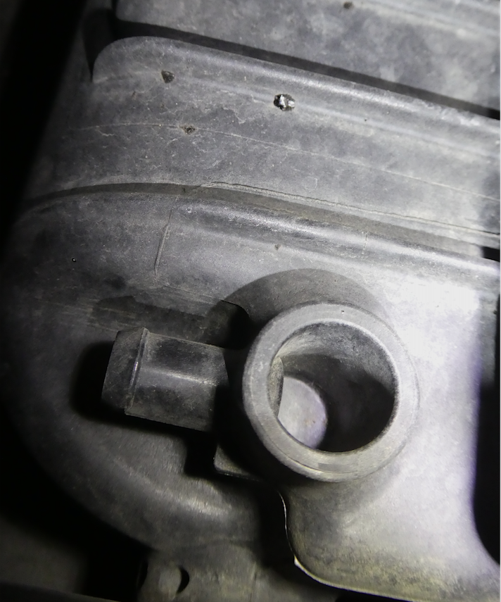

I am going to do a coolant flush and what do you know I have no drain plug or drain hose. The outlet is there and even the loop on the side of the radiator is there for storing the drain hose. WTF.
Anyone have any good ideas about how to proceed?

LOL wow. I guess you will have to pull a radiator hose off, maybe a heater hose too, in order to flush it.
52,949
They did away with the drain petcocks in 2003 I believe. Just pull the lower radiator hose. It’s faster anyway, just more messy but the petcocks didn’t direct the coolant anywhere that was a straight shot down, it hit stuff on the way and made a mess regardless.

there was a hose that fits on the petcock outlet and then tucked up into the hole on the side of the radiator, when you wanted to drain it you pulled the hose down and pointed it at a bucket then opened the drain, my 2012 radiator has the petcock and I added the hose back, but it's a aftermarket radiator from 1800radiator.

I bought a new a ACDelco radiator for my 02 and no petcock. The old one had one. I don’t miss it. I just pop off the lower hose, then hose everything down good afterwards.

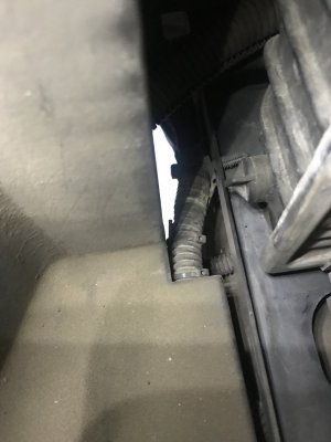

I'm in a 2003, have the petcock but no hose near it. Planned on changing out my water pump this morning but now I'm stuck.
You pic didn't load. If you have the openable petcock then you are good to go. Get a 2ft piece of clear tubing from hardware store and you are on easy street.

I uploaded the photo again, not sure why it didn't work before.

Even if you have a functioning petcock of the radiator, I don’t think it’s worth touching when you’re doing a water pump. If you were to try to use it, the thermostat virtually stops coolant from draining from the engine to the radiator and you would find plenty more coolant after the radiator drain stoped running.
My method for dumping coolant / minimizing the mess when doing a water pump was putting the catch pan under the heater hose end of the pump. removing surge tank cap to release any pressure, reinstall cap - creates vacuum as coolant dumps and slows flow. Remove one of the heater hoses from the water pump, seems like the one to the back is easier to take off first, at least with factory clamps. Once that seems to slow down, pull the cap again, and upper rad hose. Then pull the remaining heater hose. Once that stops pull the catch pan out a bit infront of the pump, pull the lower hose, and then take the lower hose and bend it down to empty the radiator. Move the catch pan under the pump to catch the remaining coolant that will come out between the block and the pump.
Draining the radiator first will reduce how much coolant you could potentially make a mess with, but you’ll still be trying to catch it from all of these places
