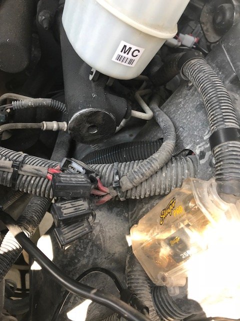

right now i have disconnected power from all the stereo amps, no fuses blown at all, battery has been on charger for 2 hours, reading 12.6, all lights, a/c, dash lights come on like normal, but no crank, no click, no start at all....
only thing i have disconnected was the power to the amps
still getting batt drain from somewhere

UPDATE (again).... saw a video how to crank engine by jumping #30 and #87 terminals on starter relay... engine cranks over right away... thinking there is a 'starter interrupt' or similar somewhere on the alarm system i never knew was installed on the truck..
batt holding charge with these fuses removed-
