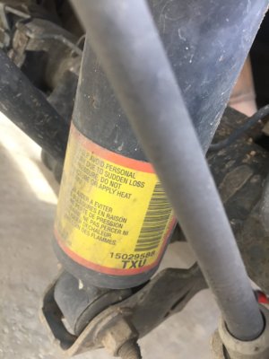

I believe that the truck has OEM shocks front and rear but I wanted to confirm. The front shocks are blue. I have attached a photo of the rear shocks. Correct me if I'm wrong but I believe that these are the self adjusting shocks that are OEM.

Also, can anyone confirm that the picture I posted of the rears are the ZW7 PREMIUM SMOOTH RIDE NIVOMAT? My glove box is stamped with ZW7 so I've confirmed that!

Keep in mind that the rear Nivomat shocks are exclusive to the stock zW7 springs. Unless you replace the rear springs, you must buy an OEM replacement shock that performs the same way;

Bilstein 4600, if its got the connector on the top of the stock shock buy the resistors on ebay.

IMO, go with the Bilstein shocks. Had many sets on many vehicles over the years, see my age, and never had a problem.
