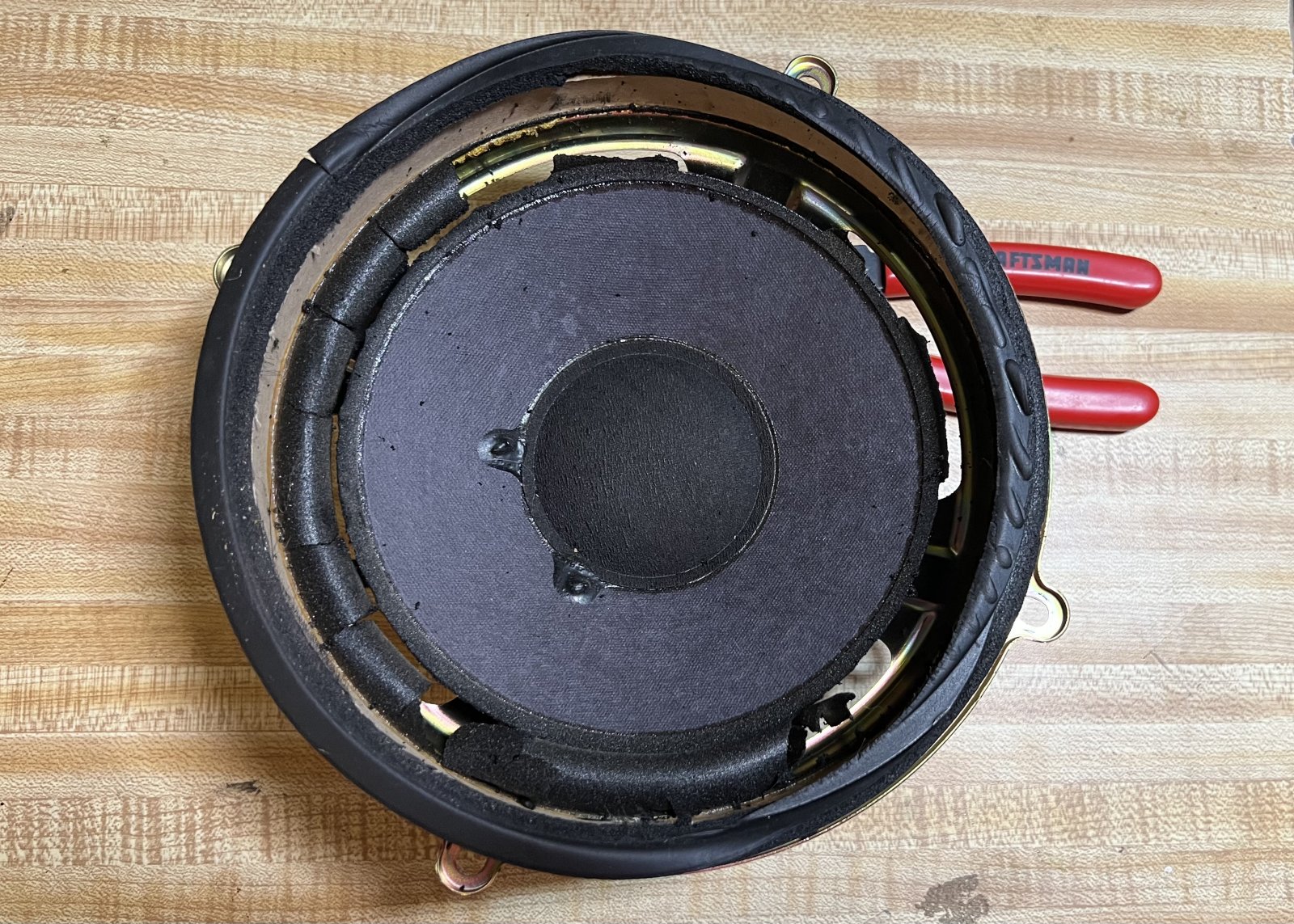

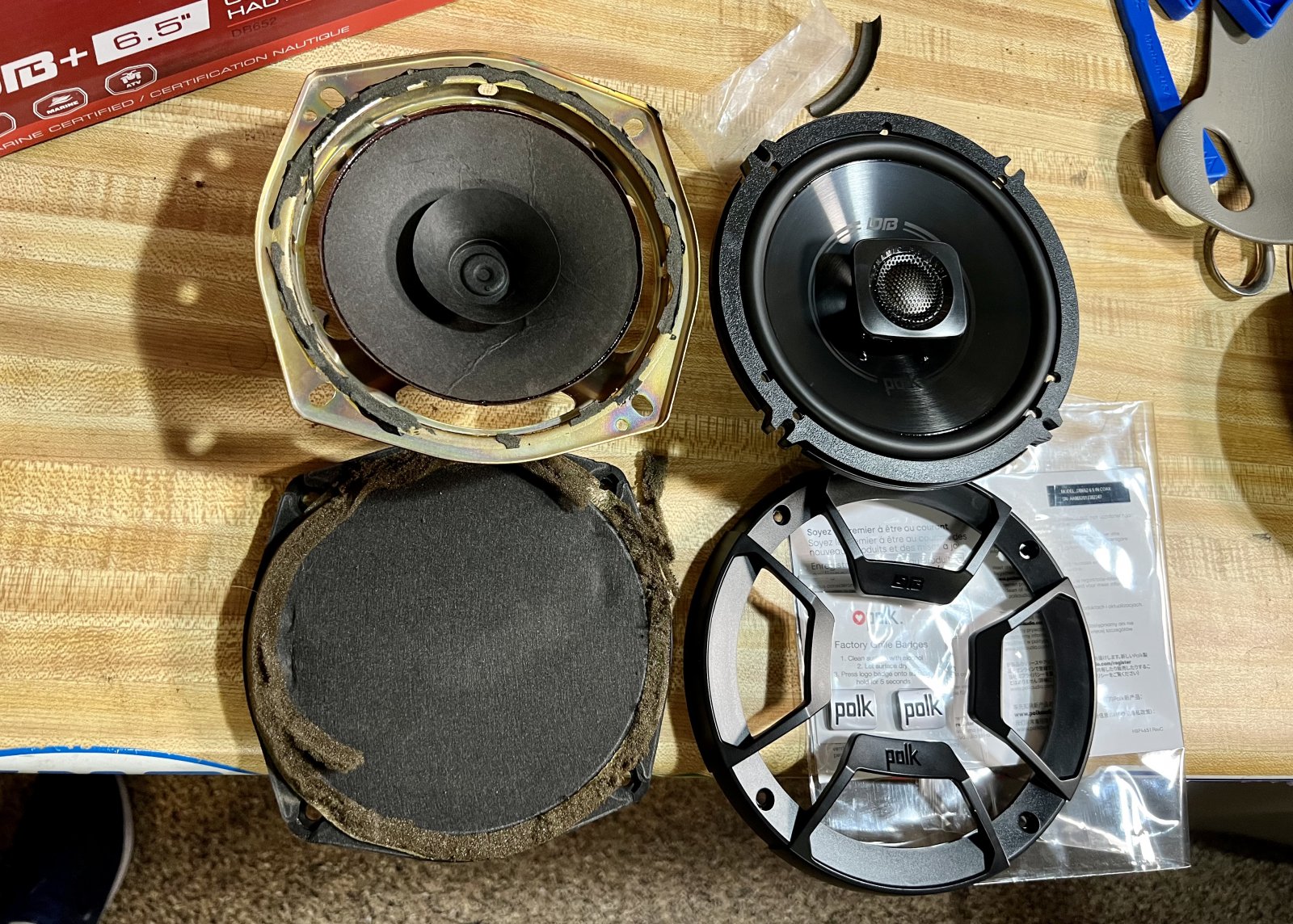

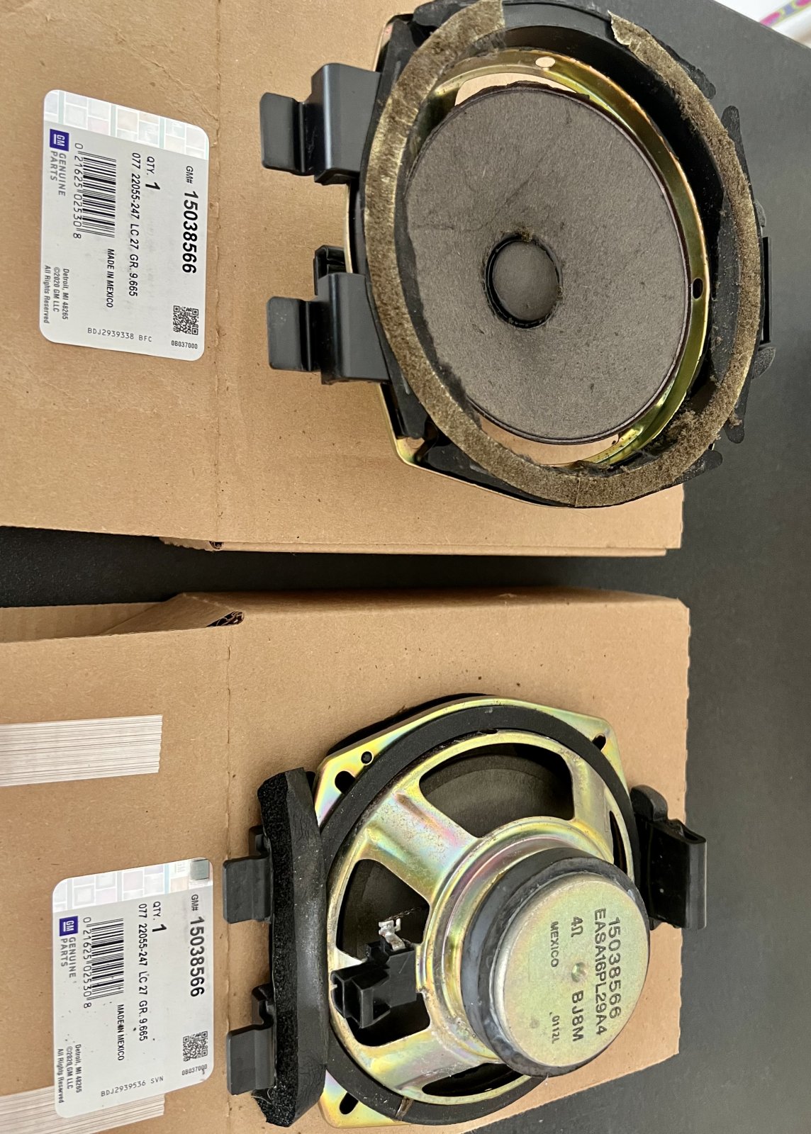

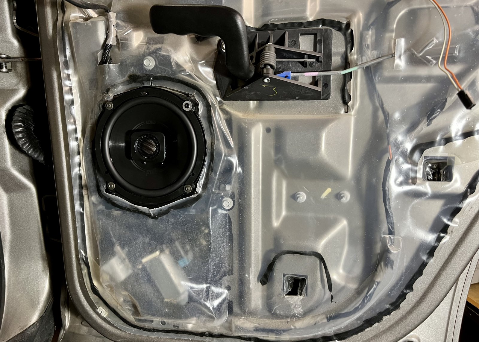

Paper cones and foam surrounds on all four door speakers and the subwoofer will begin to degrade after about ten years, until the foam is essentially gone. Time for new speakers. I used Polk Audio 6.5 in rear doors; Polk 8” subwoofer, Memphis Audio 2.75 in rear pillar and GM Genuine in front doors. They are all relatively easy to swap if you YouTube door panel removal. I have some threads up on speakers too.
View attachment 408082View attachment 408083View attachment 408084View attachment 408085
