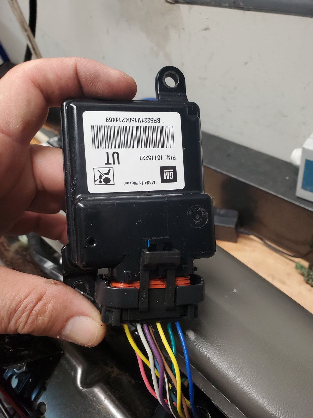

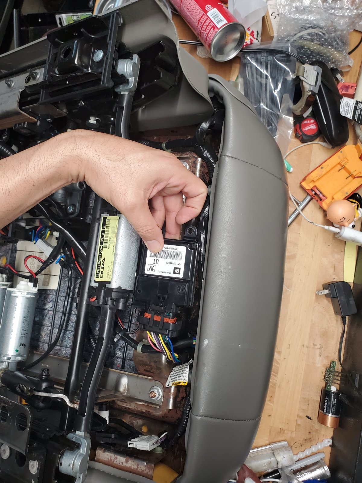

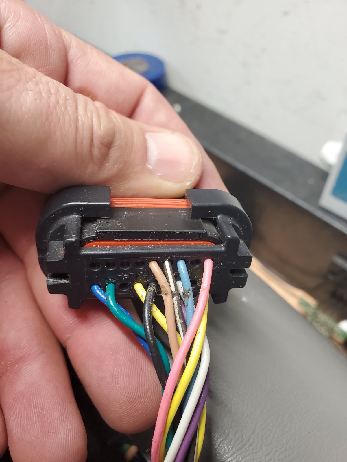

Just found out why my suv was showing B0092. One of the SRS connectors was grounding out with the seat frame.
