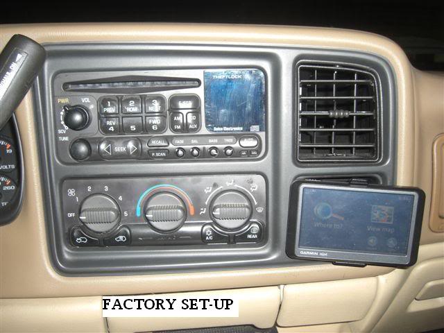

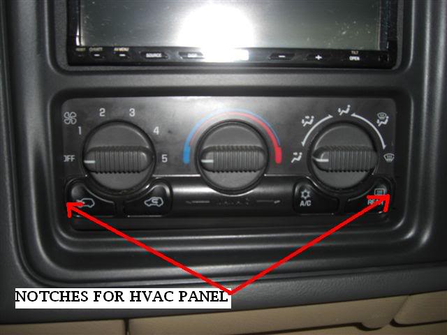

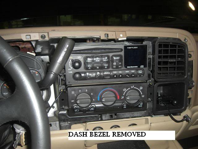

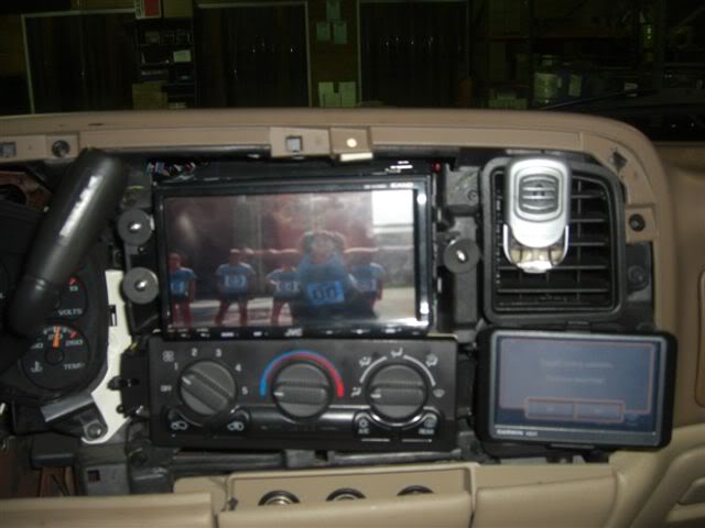

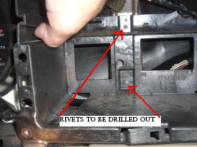

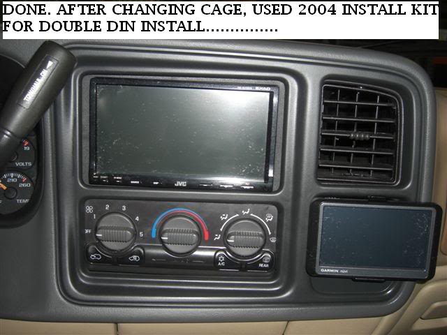

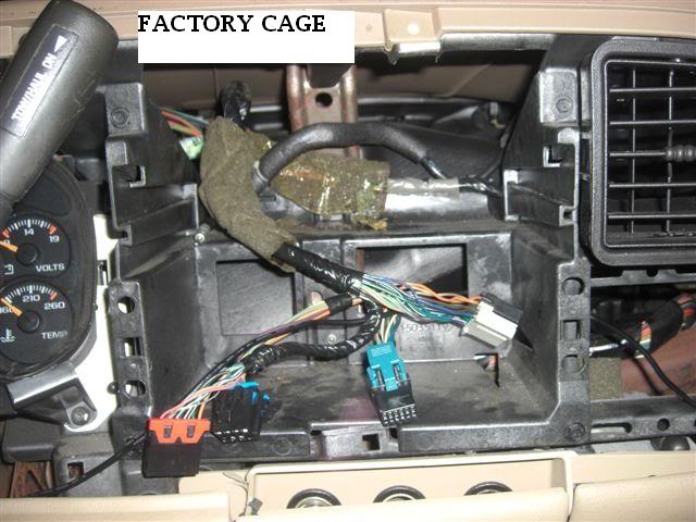

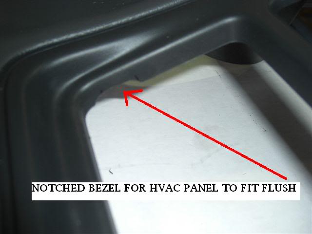

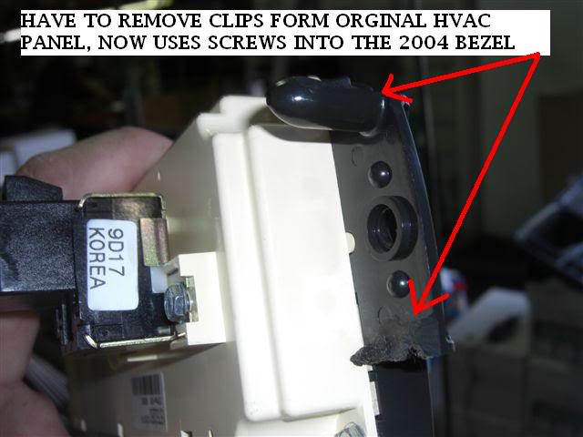

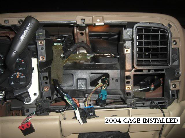

Finally got time to complete to DD install in my 2000 yukon with the 2004 bezel......

Nice write up! Did a great job on the install. Thanks for sharing the process with everyone.

Thanks guys, love the results. Need to finish installing some more screens, then move on to speakers..... Always something.

They are blocked a little. You can still get to, and use them, but the door doesn't open quite as far. The ash tray will not open. I've got to pull it back out to finish the hook-up for the rear view camera and ipod, and I'm going to rework the bottom of the bezel a little. looks like if you trimed a little off the bottom of the lip it would be be good. i'll post pics after I finish it.

Yeah, it fits really good. Other than the ash try issue. Not sure I'm going to worry with it though. Non-smoker truck :)

Hello everyone, sorry to bring this back from the dead, but I can't find a cage for my 01' Denali, already got a 03+ bezel to make the 2din work, but can't find a cage for it... anyone know where I can locate one?
This post / pictures really explained a lot, wish I saw this yesterday before I started with my dremel .. haha
