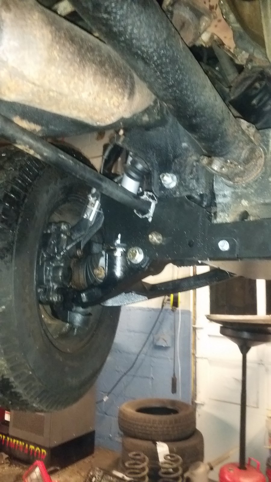

I recieved 6 cans of Eastwood internal frame paint, MasterCoat primer and paint, the new polyurethane body mounts and 3" body lift blocks today; I'll be buying M12x1.75 180mm bolts and designing my own brackets. I have removed 8 body mount bolts so far, all very easily which shocked me. The remaining 4 are going to be loosened and removed one side at a time.
Bumpers are off. I need a new rear bumper but I am in the process of cleaning out the frame rails. I tried snaking a hose into the rails and flushed a lot of crap out but it failed to remove a lot. I am going to create a cable/chain/drill powered rust scaler that I saw on YouTube, followed by my backpack blower and then compressed air.

I've used bridge primer and paint on the body mount brackets and metal cups. Half the body lift is bolted in, the other half has to come out for primer/paint.

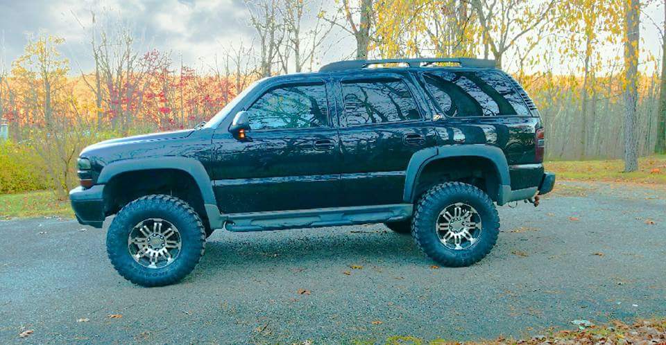

35's are looking small now...
10.5" total lift (plus 2.5" in tires) next to me at 6'4
