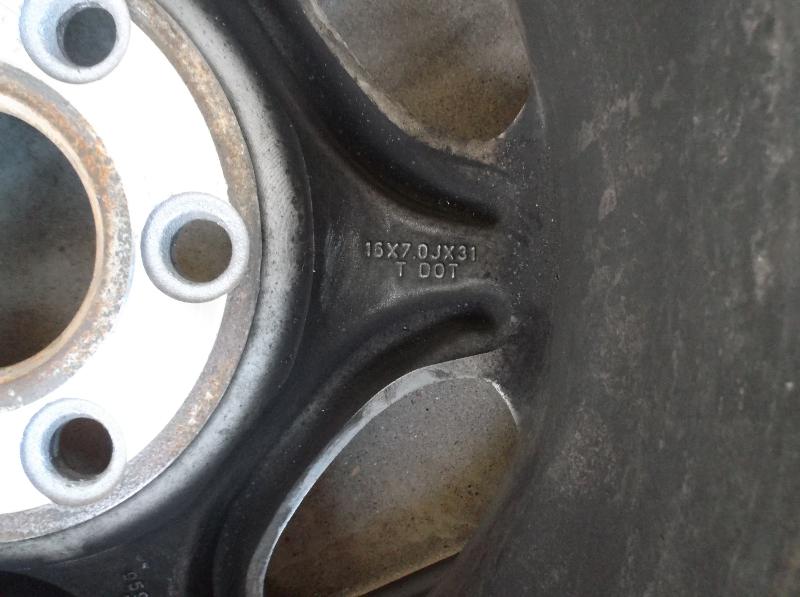

To the OP: your OE wheels probably have a 31mm offset. Pull one and look at the back side; the size and offset should be stamped or cast there. Like this 16x7 inch wheel with a 31mm offset:
