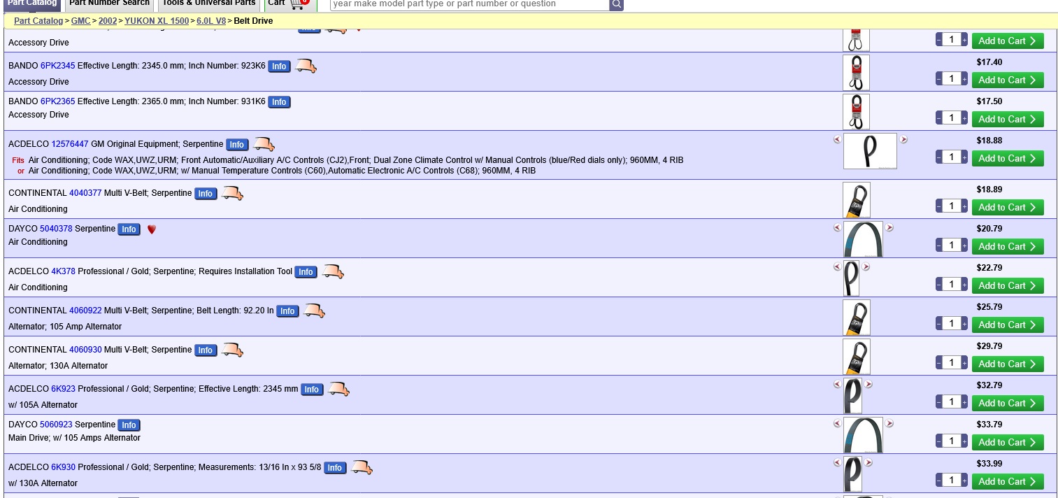

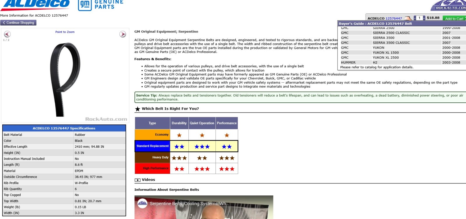

Original ACDelco belt is listed to be 94.88 At Rock Auto.
Where do you see that? The longest I see under the 2002 6.0 is 2365mm (93.11 inches).

If he is saying his took a 94 inch belt and rock auto lists one, is it incorrect?
Your listing was for the XL (OP didn't post it as such), not that it should matter. I'm not arguing that it's the correct belt; I'm saying that the Rock Auto listing conflicts with itself. The line item shows a 960mm belt but the details show it to be a long belt and a short belt at the same time.
https://www.gmpartsgiant.com/parts/gm-belt-12576447.html and the Zone https://www.autozone.com/p/acdelco-gm-original-equipment-serpentine-belt-12576447/916818 show it to be an A/C belt.
