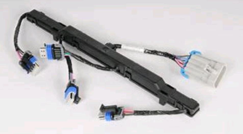

I am not super familiar with the GMT800 platform.
On the GMT900 trucks there is a harness that goes between the coil packs and the main engines harness, so that you could unplug it from the main harness and remove all 4 coil packs while still attached to the bracket as an assembly.
I have seen that harness go bad and cause the same issues you are having.
I assume the older LS engines use the same type of harness.
Looks like this...
Hope this helps.
K

ok thanks im doing a valve cover job on it now so ill swap them and see if miss moves to bank 2.... that is a great idea thanks bud
Looks like this...
Hope this helps.
i swapped this harness tonight while doing the the valve cover gaskets.
once i get the car running again tomorrow i will be able to see if you are right. great thinking and thank you for this idea... i do hope it is something simple like this harness
