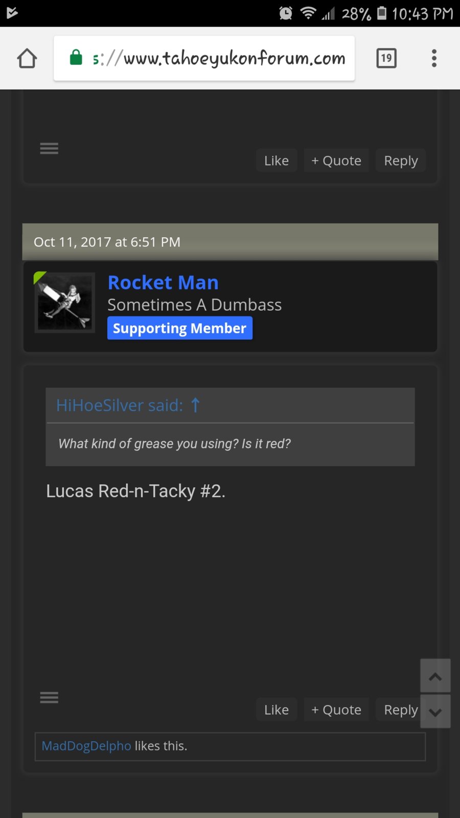

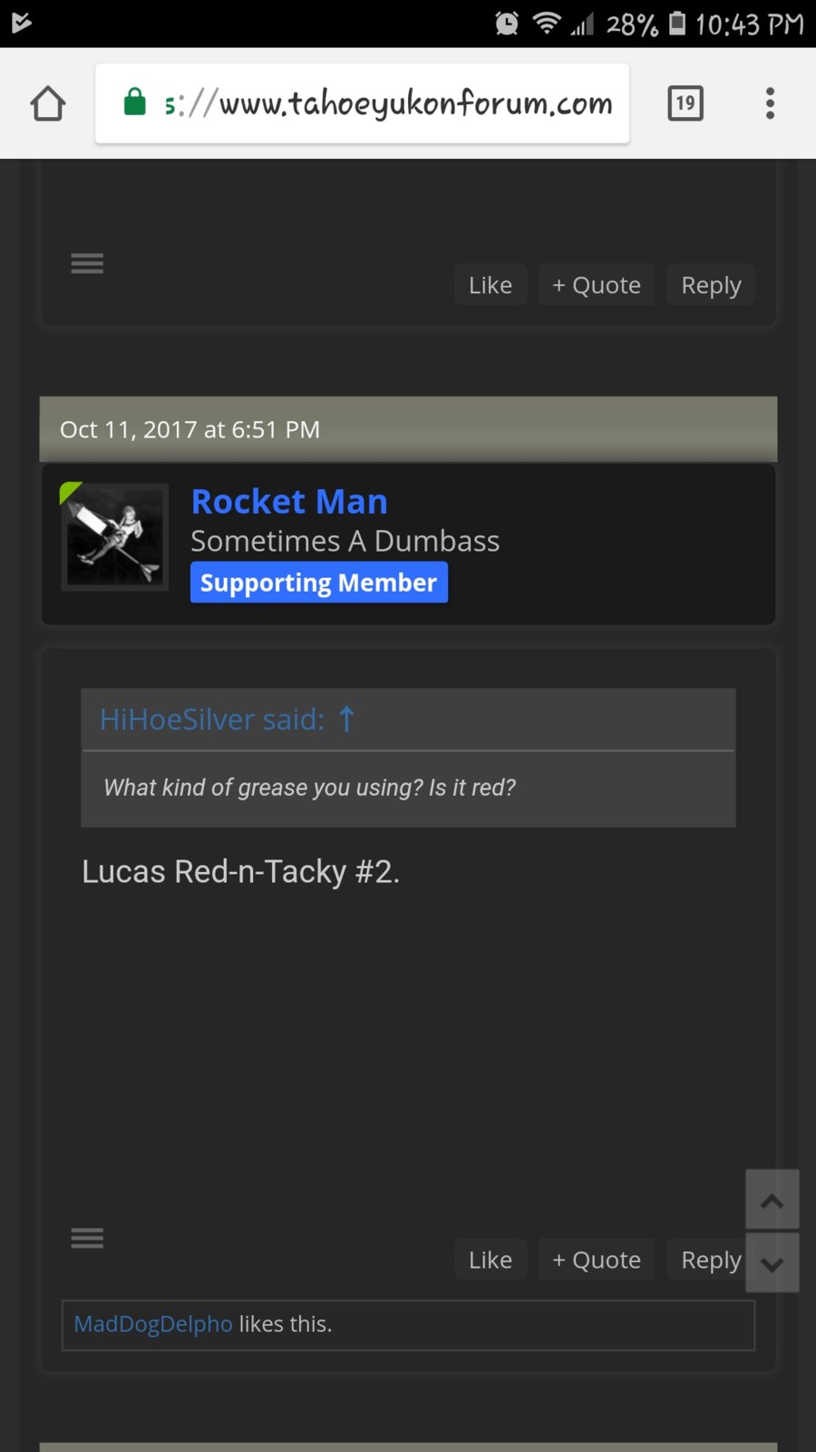

Hey who ya callin red n tacky? I used to go by Red but I was never tacky lol.
