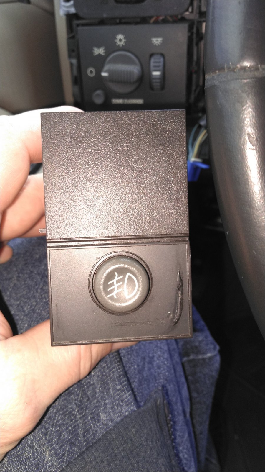

Howdy ,
So i have a 2001 tahoe with a burnt out foglight switch . I cannot find a replacement anywhere. it is the switch with just the fog light on it . i tried a different year replacement with a wiper control on it but the harnes that clips into the back does not fit .
Can i use these wires and hook it up to a plain old manual switch on my dash ?
Has anyone else found another year model that will fit the 2001 harness ?

By burnt out, do you mean the bulb or the complete switch gave out
T
THOMASRGRUAB
Aug 26, 2020
the entire switch is bad , i hooked up a test light to the small harness that clips into the back of it and i have power going to it so the switch is bad .

You can go to https://www.gmpartsgiant.com/ to look up part numbers for your truck.
GM #15714113
https://www.ebay.com/p/657783736
Search by part number and see what you can find.
