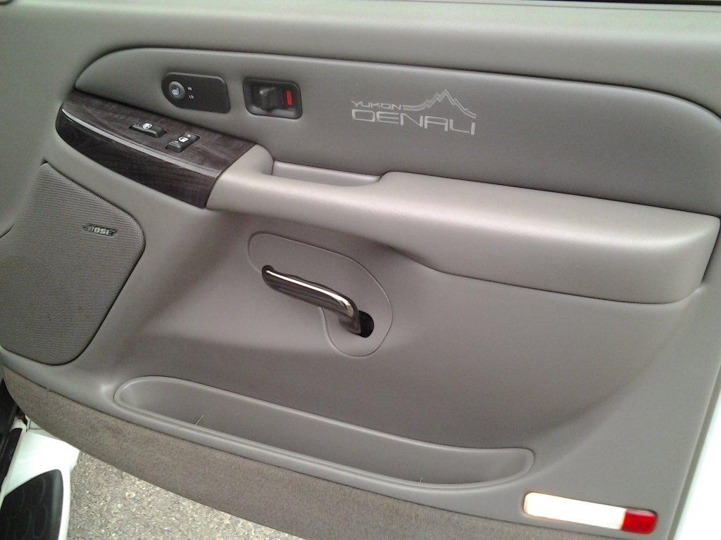

Just to share, when I went to pull the door link/stopper at the junk yard, I noticed that it said RH/RR on it....for right-hand, right-rear. The truck was missing the driver's side rear door, as were the other three Tahoe/Burbs in that yard...the did all have passenger rear doors though.
Since I could not find another truck with the driver's rear door still attached, I went to a 2nd salvage yard, found one, removed it, paid more for it (not a Wrench-A-Part yard)and then getting in my truck compared the two parts and slapped my forehead...when you turn it over, on the bottom side, it says LH/LR on it.
Doh!
So yes, it's the same part for both sides...you just have to turn the part over and not be a moron like me.

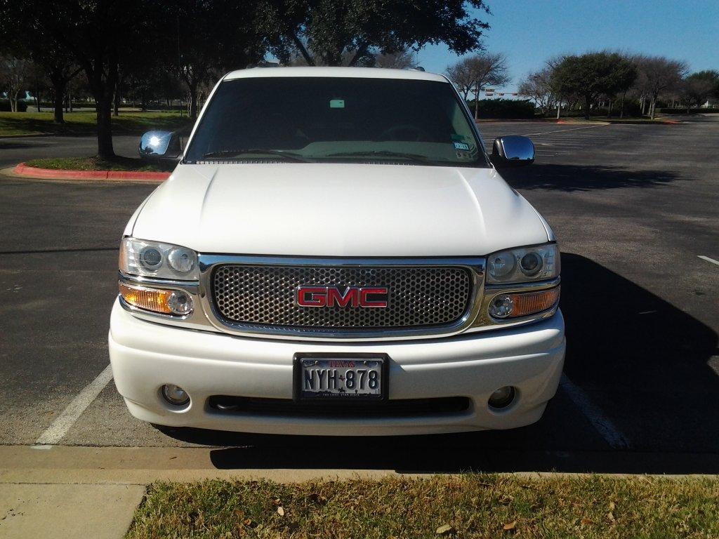

I just went and picked up the Denali from the paint guy. Second time's the charm, front bumper looks MUCH better, and makes the hood and fenders look that much worse!
Now the fun begins. Supposed to be a gorgeous weekend, temps 60's to low 70's and sunny.
Got a window tint appointment tomorrow morning to tint the front door glass to match the rest of the side and rear glass. Then will be scraping that mess off the hood and fenders, and the stickers off the tail gate glass, followed by a LOT of bug and tar remover on the lower body, and then a big all-over bath, followed by a LOT of waxing and polishing. Then the interior detail, plus want to installed the polished mirror covers and detail under the hood.....plus scrub the RWL tires....and on and on.
We'll see how far I get.....
Here are the "before" pics from my work parking lot just now. My buddy Truong had borrowed my tow dolly, so bringing it home. Could not even tell it was back there. :)

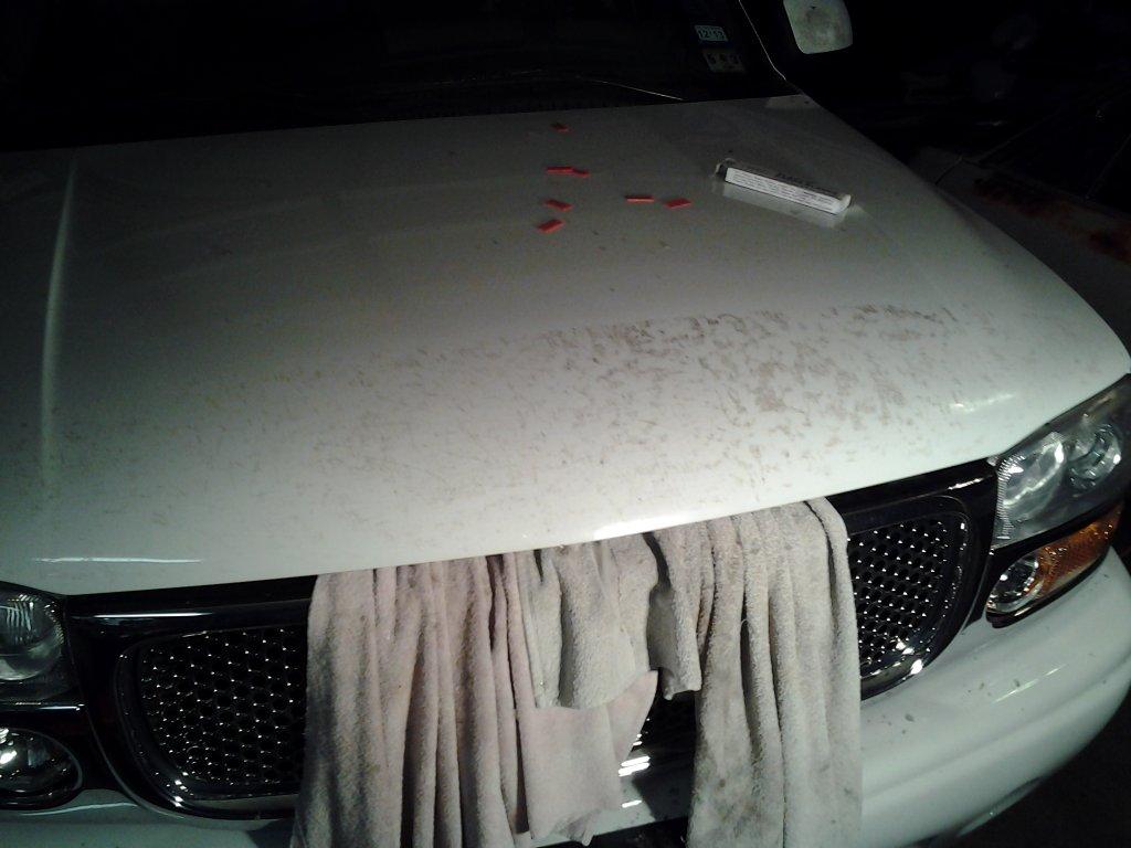

First off, I removed all the wood on my '89 Olds Custom Cruiser wagon a few years back, and would have done that job again rather than removing the cracked Clearbra from this Denali. It was that much of a nightmare...
Got home at 7pm and had to go grocery shopping, so did not start on the Denali hood until a little after 9pm. I finished this morning at 4am...no joke. I had to get up for the window tint appointment this morning, and I'm walking zombie now. The tips of my thumbs are numb from the plastic razor blades, and my shoulder and arms are so sore I almost can't lift them. :no: Lord what a pain in the rear!!
On the upside, Jonathan and Lily helped me for a good long time. Had the stereo on and the kids were singing along. I'm really proud of them both, they really worked hard. Joseph however came out for 5-mins and decided this was too much work and went back in the house. Oh well,at least I had two solid helpers.

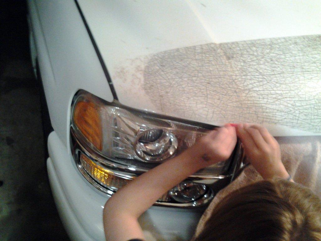

I started the project by spraying the Clerbra down with Tire Wet. Read online this slimy stuff helps. Then after working on it with plastic razor blades for an hour and only getting pieces off the size of my pinky fingernail, I sent Lily for her hair dryer. HEAT IS THE KEY HERE!
This is after an hour and a half....

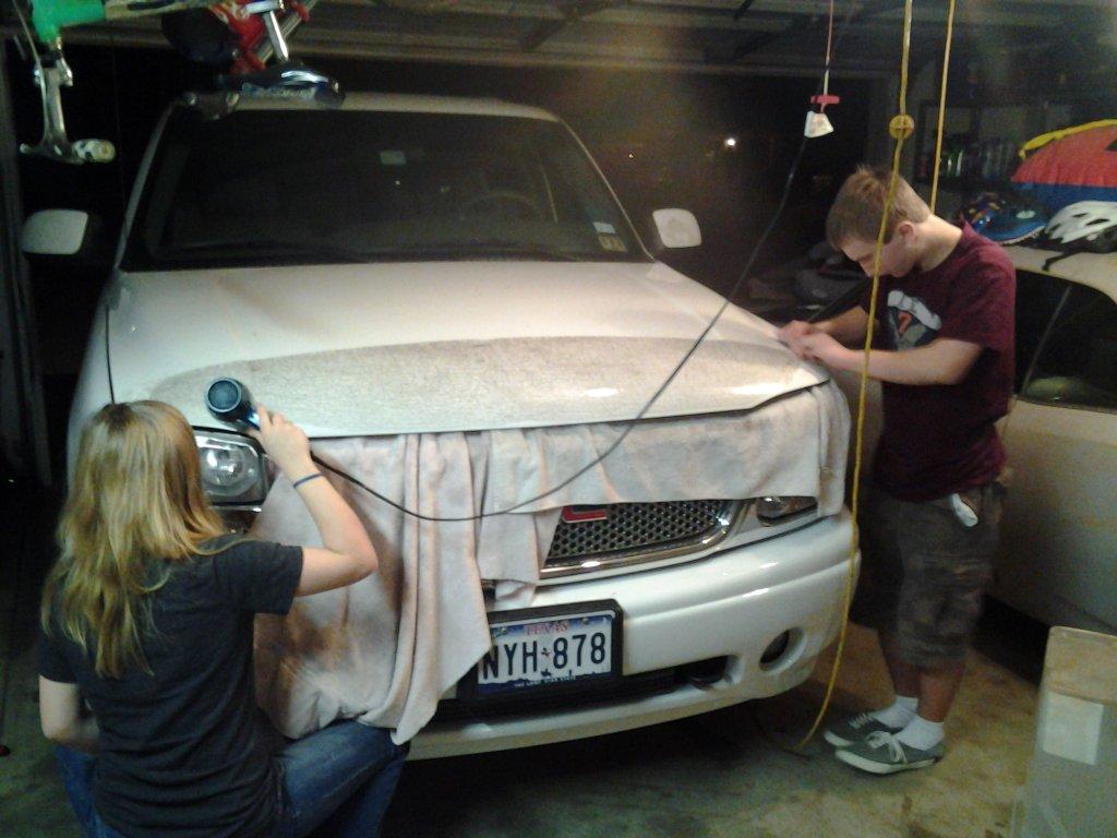

Using the hair dryer and getting small areas really hot, were were able to finally make some progress. Worked great until the hair dryer caught on fire...no joke....smokey mess, killed it! And scared Lily off too... Oh well.
So next I got my pole-mounted halogen work light, which gets lightning hot, and we used it to heat small areas until they were smoking, and then scraped off those areas and moved on.
Lily was out there with me from 9-11:30, and Johnathan lasted until 1:30am. Johnathan was determined to get all the plastic off the hood before he went to bed. He worked on the driver's side and I worked on the passenger side, and we met in the middle at 1:30. HUGE help, I owe that kid!

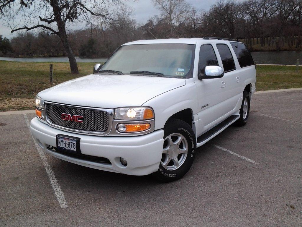

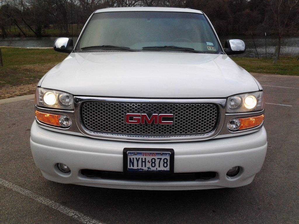

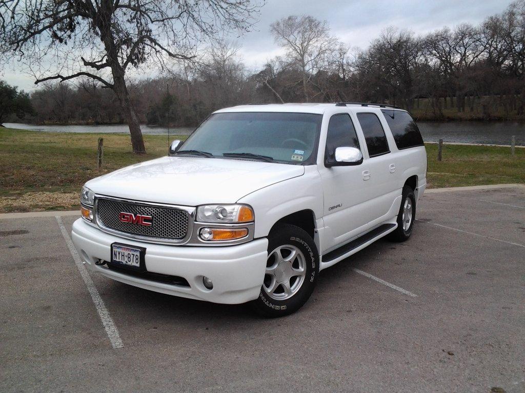

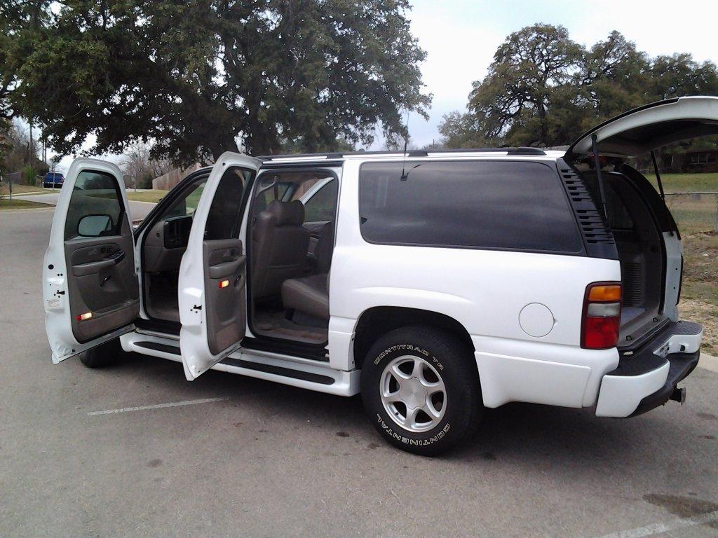

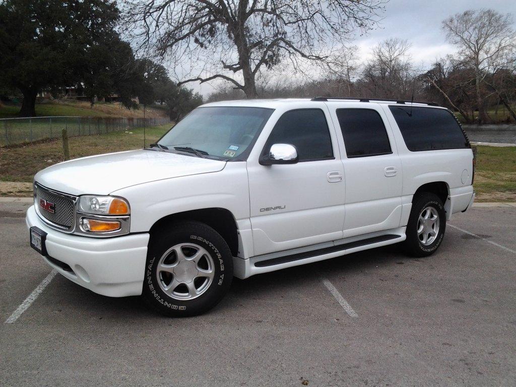

Wanted to share my "basically done" pics of the Denali from this morning.
I spent all day yesterday on the truck (and all weekend basically). Cleaned under the hood, then bug and tar remover on the lower body (tar on white paint SUCKS to get off!), then compounded, waxed, and touched up the paint. It's like detailing a house...

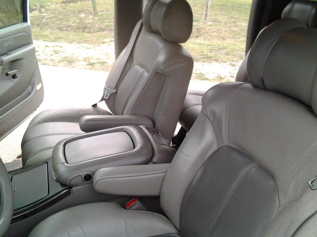

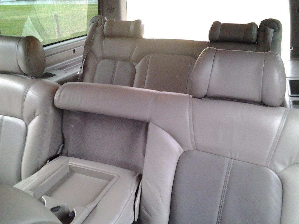

Inside I scrubbed the carpets, cleaned every interior panel, then first cleaned and then conditioned the leather seats. It smells WORLDS better inside now.
Anyway here are the Glamour Shots from this morning. It's a really nice truck. My wife comes home from Colorado today, and I'm picking her up at the airport in it. She's not seen it since we bought it....I'm hoping she freaks out over it. It looks a LOT better now. :D
I like the oval exhaust tip. Need to put one on the black Suburban
Interior cleaned up really well. Still have a little work to do in here, want to replace one panel on the driver's seat and need to touch up the grey trim on the console, but other than that it looks nearly new now.
The underhood looks a lot better. I almost soaked all the plastic with Armour All...but every time I do that it just sucks up dirt and dust, so I left it dry. It's spotless though.
I'm really happy with how well this one came out.
