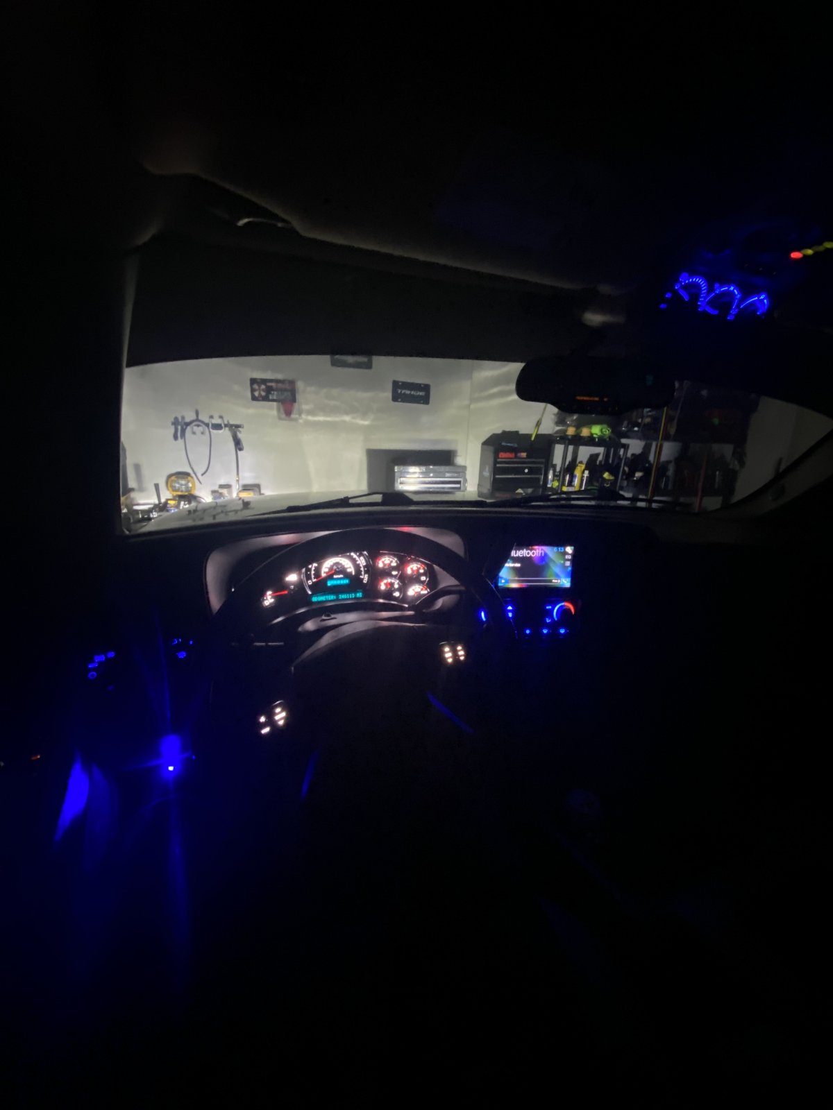

I did a full led install on mine. How I check everything is take a square battery. Small one like for smoke alarm. Forgot the volt. But hook 2 alligator clips to it then touch it to the board I worked on to see if it lights up. Like touch them to the pads. U can troubleshoot that way. How I did all mine. The blinkers an stuff are on different paths
