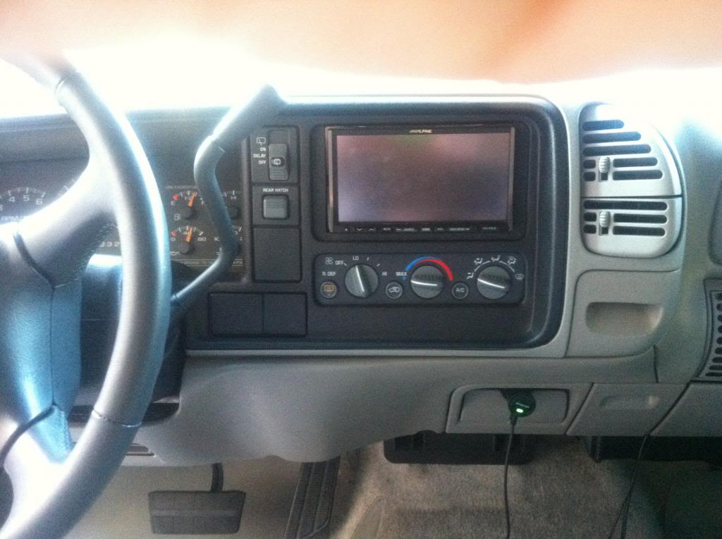

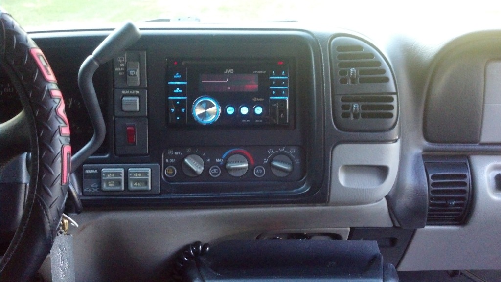

anyone know of any brackets that come pre-fabbed?
I got mine here;
http://www.thedetailss.com/95-99_CK_Double_Din.html
My install photos
Before;
After;
Donnie Yukonie
Yates Caretaker
Jul 31, 2011
5,127
164
They do for the 95-99 C/K Double Din Kit from the Detail SS , That is where i got mine and the Double Din and Hvacs moved down Is all one bracket . Im going to move this into the Correct section as I do believe he has a OBS .

99yukon, how hard was that install and didit reuire a lot of fabbing?
99_Yukon
Mar 21, 2012
168
Michigan
yes i do have and obs sorry i was just looking at the years haha.
Most of the actual "install" was fairly easy. Just screw in the metal bracket to the dash and install the radio on hvac controls. The fabbing of the dash bezel was time consuming to make sure it was straight and even with the insert piece. If you can manage to cut straight and take your time it is definitely worth it. A much better look imo.
