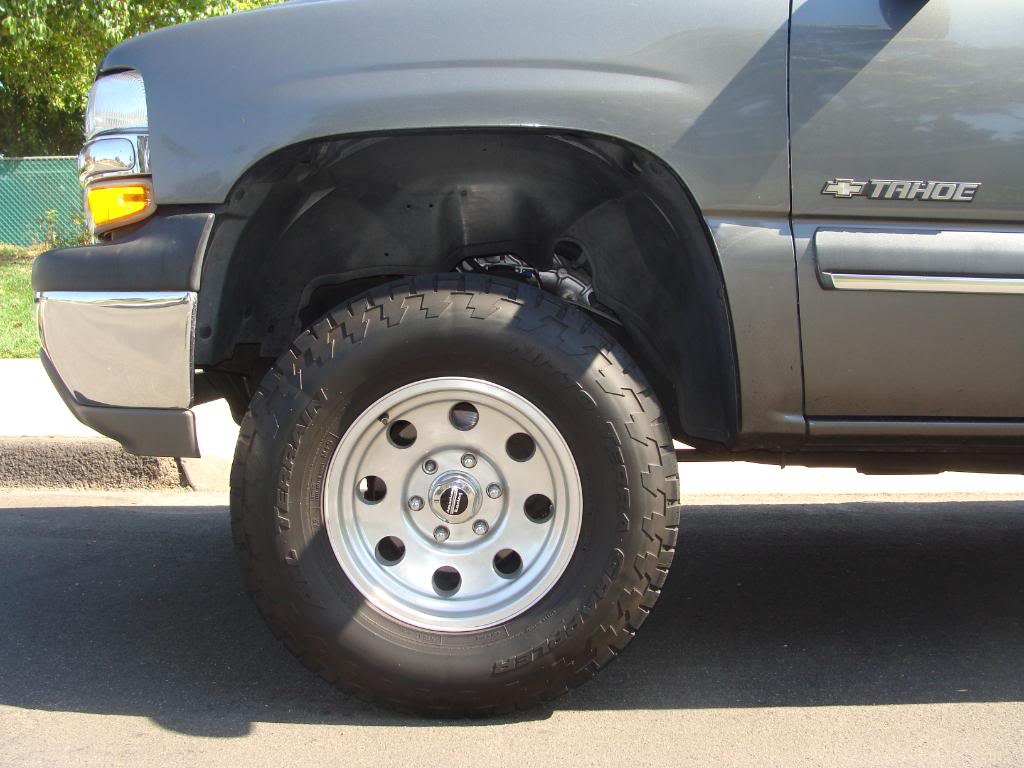

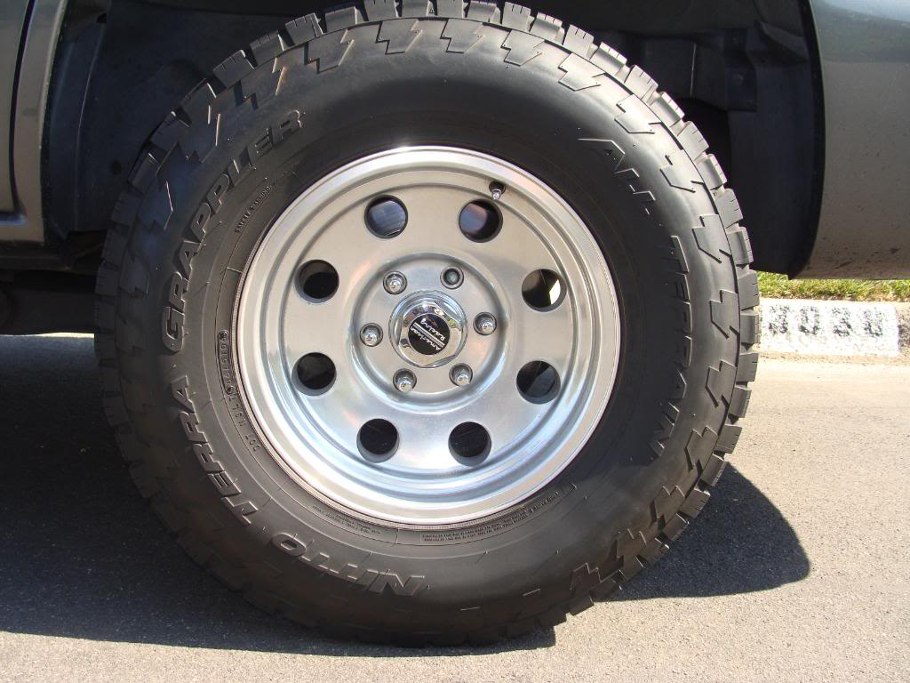

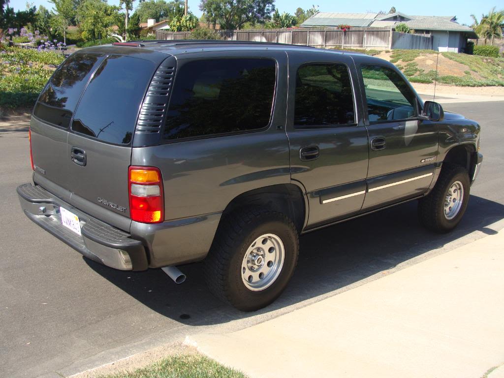

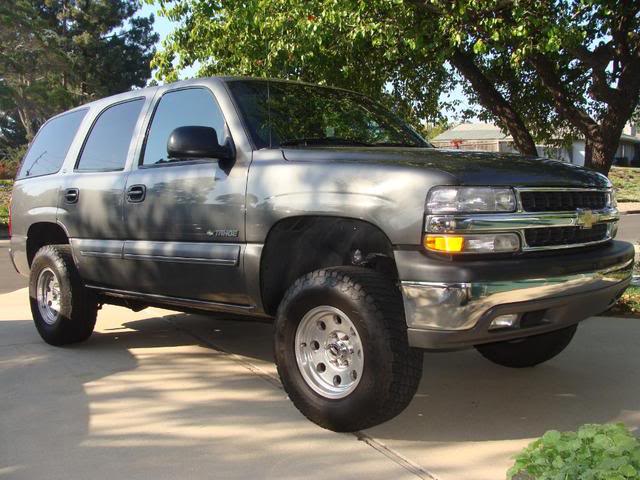

Thanks so much guys, its just that i was lookin at the 2" spacers on ebay, and it said for every 2" you only get about 1.25" of lift, i guess they dont know what theyre talking about , ill go ahead and get the 2's, i need new shocks bad, wioth the 2" keys up front and cranked torsion bars the front shocks are very rough, but im waiting to get new shocks until i get my 3" body kift too, to get the correct shock height size, im gonna get the bilstein 5100's when i get the 3" kit, i was going to run 35's, but after aquionsteve showed me that white z71 with 37's im very tempted lol, but im curious, how can they fit a larger tire on a stock rim, compared to my aftermarket 16x8's, arent the stocks 16x7.5 or 16x8 as well? could i fit a 37" on mine or just stockers?.....also i dont think these sizes are legit, i have 265/75/16 right now and they said they are 32.5", i measured them theyre barely over 31"....so are 37's really like 36"? man i have lots of questions, sorry guys you prob hate me ...but i did take pics, maybe that will make up for all my lip flappin' heh

The stock rims really help you fit the bigger tires. 35s are pushin it with stock rims. Stick with the 33s and youll be happy. BTW no pics of the truck yet?

Right after i posted that last night i tried uploading my pics 3 times!!! and everytime it said there were security errors..i emailed the site administrator and explained what happened, ill try again when i get home from work GRRRRRR, aquino, im doin the keys/spacers/3" BL, and going to try and fit maybe 315/75/16, if not ill do 305/75, BTW i dont want to give up my american racing 16x8 just to fit 1" larger tire on stock rims, heh, aint worth it that much to me

youll fit the 315s fine. People run them with just 3"BLs. You got another 2"s of room under there with you keys and spacers.

My **
