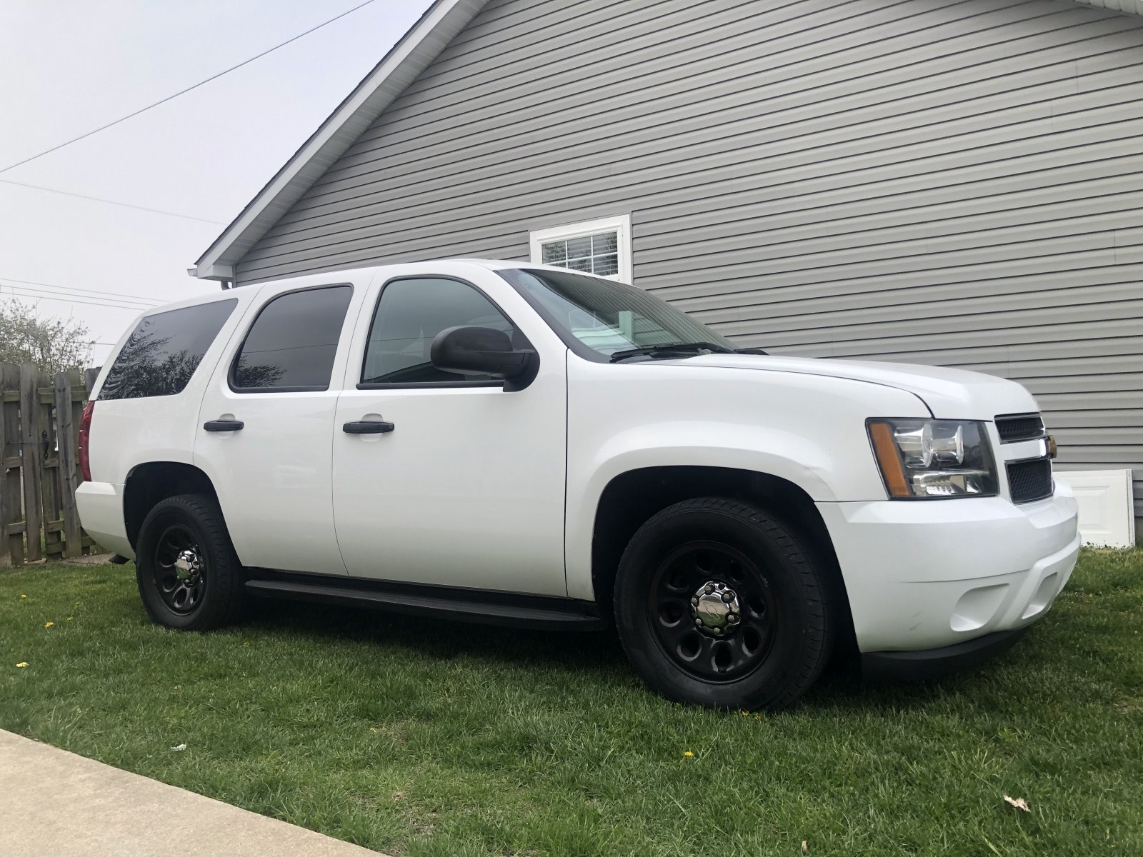

Hello everybody, my name is Jacob. I am new to the Tahoe world, as well as forums in general. So if this was posted in the wrong place, my apologies. Posted it here because I have questions about everything in general. I recently bought a 2013 PPV Tahoe. I also just bought a new engine for it as well. Current stock 5.3 has a flat spot in the cam and with what I'd like to do with this build, it financially made sense to go this route.
-Current setup is just a stock 2013 PPV Tahoe with DOD/AFM Delete (picture below)
-I am putting a brand new lm7 5.3 gen 3 in it. It has been completely machined, balanced and blue printed.
-bored and honed to 346 c.i.
-block deck has been milled
-ARP rod bolts
-balanced crank
-meiling high volume oil pump
-sloppy stage 2 turbo cam
-new hypertuenic pistons
-rings gapped for boost or nitrous
-main studs
-fresh bearings throughout
-.02 main bearing clearances
(sloppy stays for now until I put a BTR stage 4 in)
I am looking for any advice in general regarding preventative maintenance during the engine swap I will be doing in 2-3 weeks. As well as what type of exhaust you guys have found performs the best. Anything I might not think to do since this is my 1st Tahoe/ 1st build. I will definitely take pictures & videos during the swap process to keep you guys updated. Thank you everyone, I hope to hear from some of you soon!

This will be an awesome build! Really excited to follow along! Heres a few things you will need to figure out with the motor swap.
-Tuning because with the cam and bigger displacement the factory tune wont work.
-Air Fuel ratio gauge I suggest an AEM Uego because you can plug it straight into the OBD2 port and read ARF on HPtuners
-Your doing a gen 3 5.3 which has a different reluctor wheel teeth count. The gen 3 has a 24tooth and the Gen 4 like what you have now is 58 tooth. Pretty sure there is a sensor adapter or something you can buy.
-Knock sensor location for the Gen3 is in the valley cover where Gen 4 is on the side of the block.
-Exhaust is really up to you if you go turbo later then you want either dual 3" or single 4"
I'm sure I am missing stuff but this is what came to mind right away.

Thanks for the reply Dan. I'm definitely going to look into what all I need before I drop it in, so any information is appreciated! I wasn't aware of what you mentioned so that definitely helps.

Hello everybody, my name is Jacob. I am new to the Tahoe world, as well as forums in general. So if this was posted in the wrong place, my apologies. Posted it here because I have questions about everything in general. I recently bought a 2014 PPV Tahoe. I also just bought a new engine for it as well. Current stock 5.3 has a flat spot in the cam and with what I'd like to do with this build, it financially made sense to go this route.
-Current setup is just a stock 2014 PPV Tahoe with DOD/AFM Delete (picture below)
-ARP rod bolts
-balanced crank
-main studs
I am looking for any advice in general regarding preventative maintenance during the engine swap I will be doing in 2-3 weeks. As well as what type of exhaust you guys have found performs the best. Anything I might not think to do since this is my 1st Tahoe/ 1st build. I will definitely take pictures & videos during the swap process to keep you guys updated. Thank you everyone, I hope to hear from some of you soon!View attachment 244818
Update: It's a 2013 Tahoe, the totaled one we purchased for parts was a 2014, my bad on that. Not sure if that makes a difference or not.
