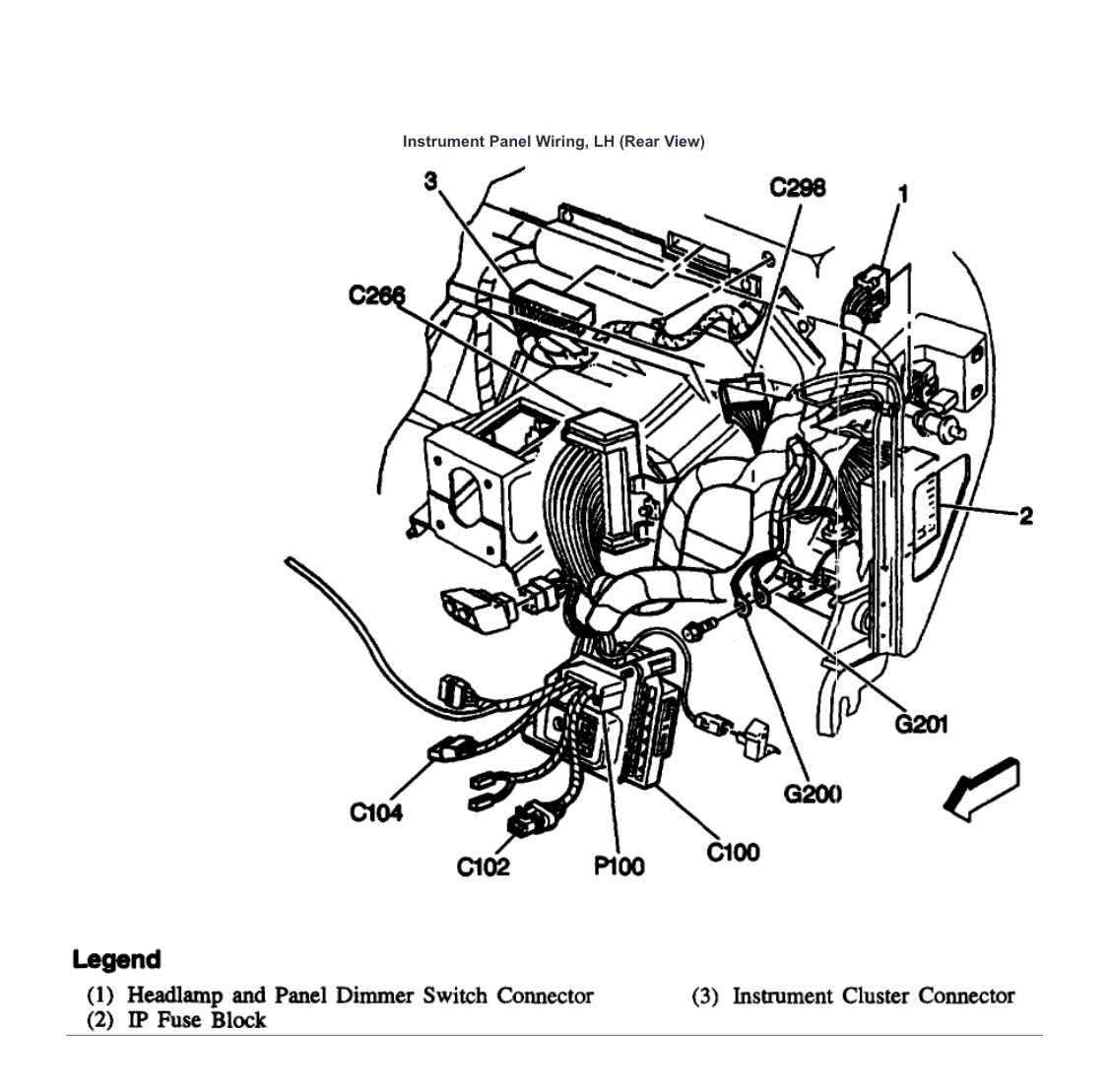

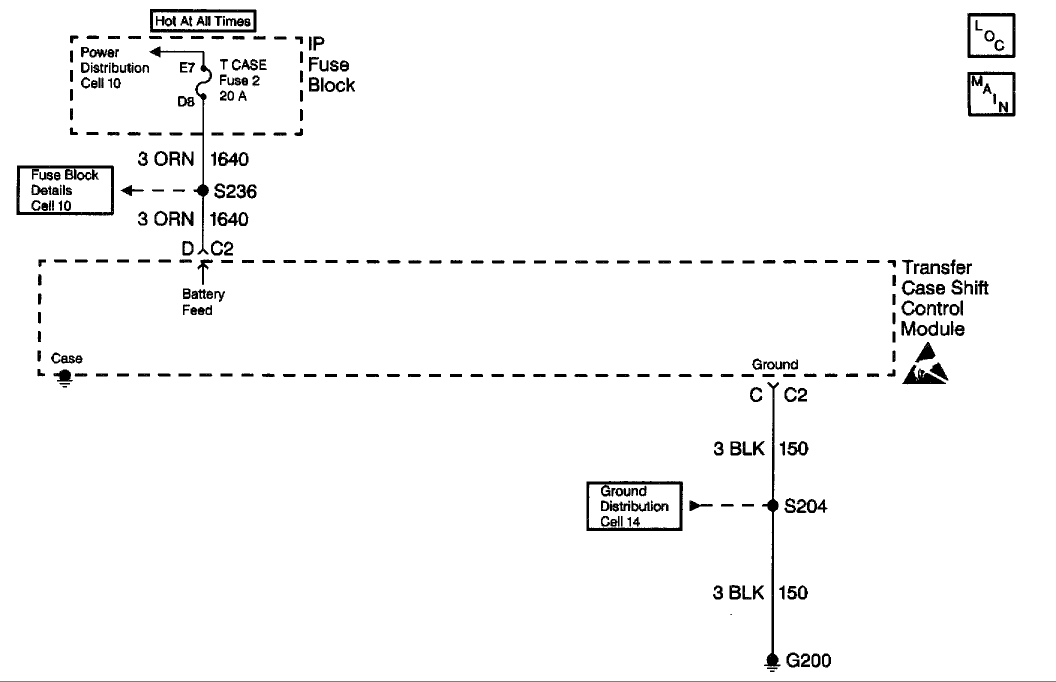

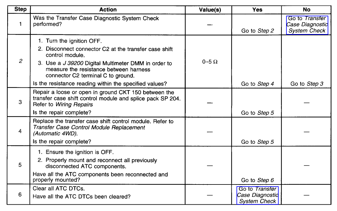

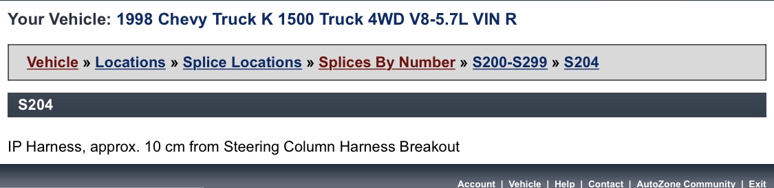

This is the diagnostic table for C0315 for a 98, maybe it will help. It looks like it points to a bad ground or defective transfer case shift control module.
Ground G200 is on the dash support bar kind of above the parking brake.

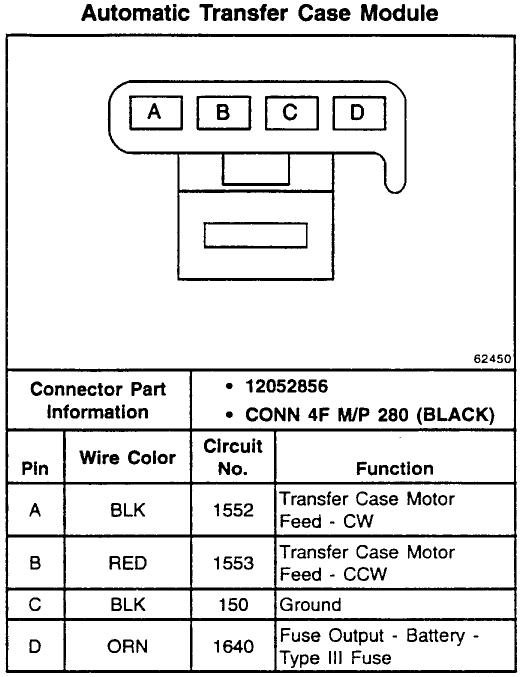

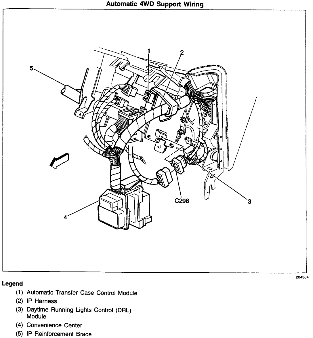

A few more to show where the auto transfer case module is located under the driver side dash...
