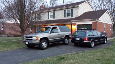

Hi,
After a 6-month search, I Found and bought Winston my new 2-door Tahoe.
Pretty much a stock 1999 2-Door Tahoe LS with 4x4 push button / 5.7L Vortech.
Winston's got 140K miles with a brand new remanufactured transfer case and 20K on the transmission.
Wife isn't too happy - nevertheless I have little maintenance history on the car and need to spend money for "must do" upgrades from stock and preventative maintenance - ALL To Save Money Down The Road.
Question: What upgrades should I do - for example is the stock Vortech setup efficient of should I change the injection or distributor mechanisms? Pics am in Northern VA - should I go ahead and get a rust protection sprayed on - what do you recommend?

If it runs well and you are saving money.....leave it alone. Rust protection is never a bad thing.
Nice truck and welcome to the forum.

Nice rig. Looks like we will both be coating frame this year. Had same problem w/wife. Let her have the garage to park, she'll get over it.
