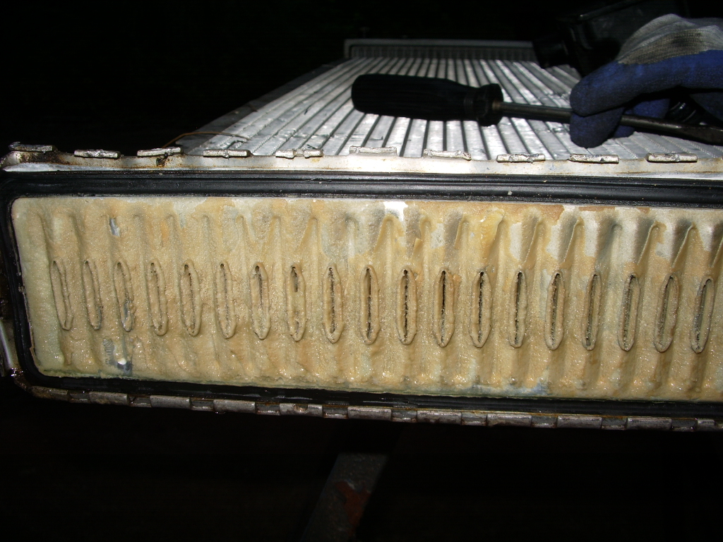

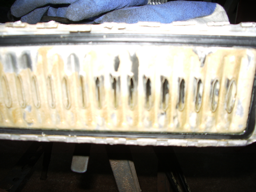

My Tahoe has stopped over heating...I changed (in order) thermostat, waterpump, anti-freeze, pressure cap, clutch fan, radiator. And the winner is...
top 7 rows of radiator
bottom 7 rows of radiator
dam thing was plugged up bad, and I had flushed it at 95,000 miles.
