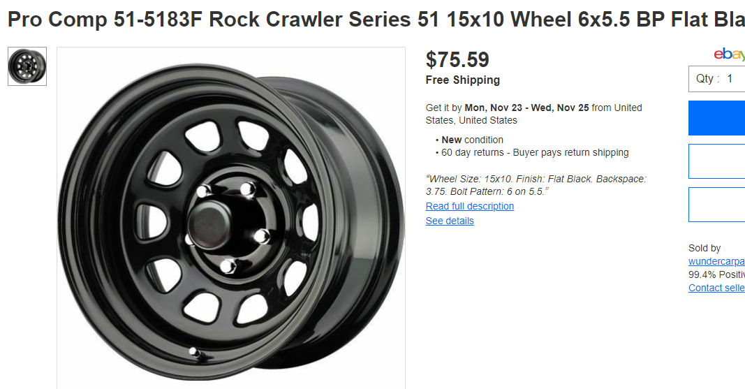

Would it be possible to run 15 inch wheels (Pro Comp in the picture below)with a 2" hubcentric spacer behind it? I keep hearing without the spacer, they dont fit. I plan on putting on a little 3" spindle lift on my 01 Suburban 2WD soon and I really like the look of the smaller rim/beefier tire combo.

Thanks, thats a pretty cool site actually. This question is more regarding just the wheel to the hub attachment. Even if I stick to the stock tire size after lifting the truck, will a 15 inch wheel bolt to the hub without any problem if 2" spacers are run. I could play it safe and stick to the 16, I just like the look.

both places i use for rims and tires say 15s wont fit your truck. you would need to push the wheels out a significant amount to clear the brakes most likely. then you would need large fender flares and you would also be adding extra strain you your bearings and other suspension components. that rim is available in a 16in and with a 3in lift you can probably atleast run a 265 or maybe even push a 285(33s). also difference between a 15 and a 16 with a big a$$ tire you wouldn't even notice. also a 10in wide rim is pretty big unless your planning a stretch look your going to need a wide a$$ tire to make those procomps not look ridiculous. with a 16x8 i would run 285 75 16 and they looked pretty big and most of the smaller shops hated to see me pull up. steel rims and a 285 75 is a heavy freaking tire.

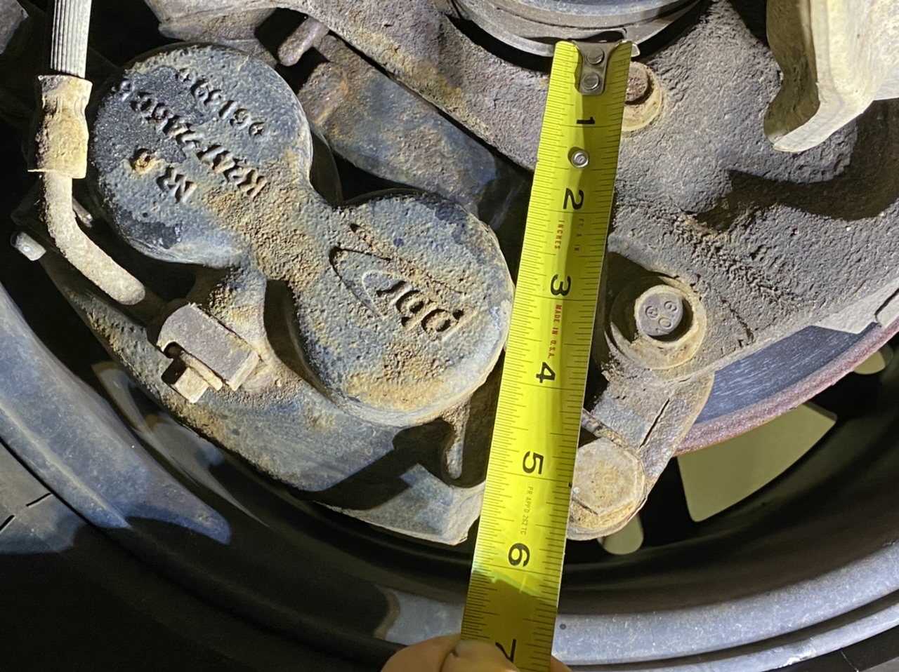

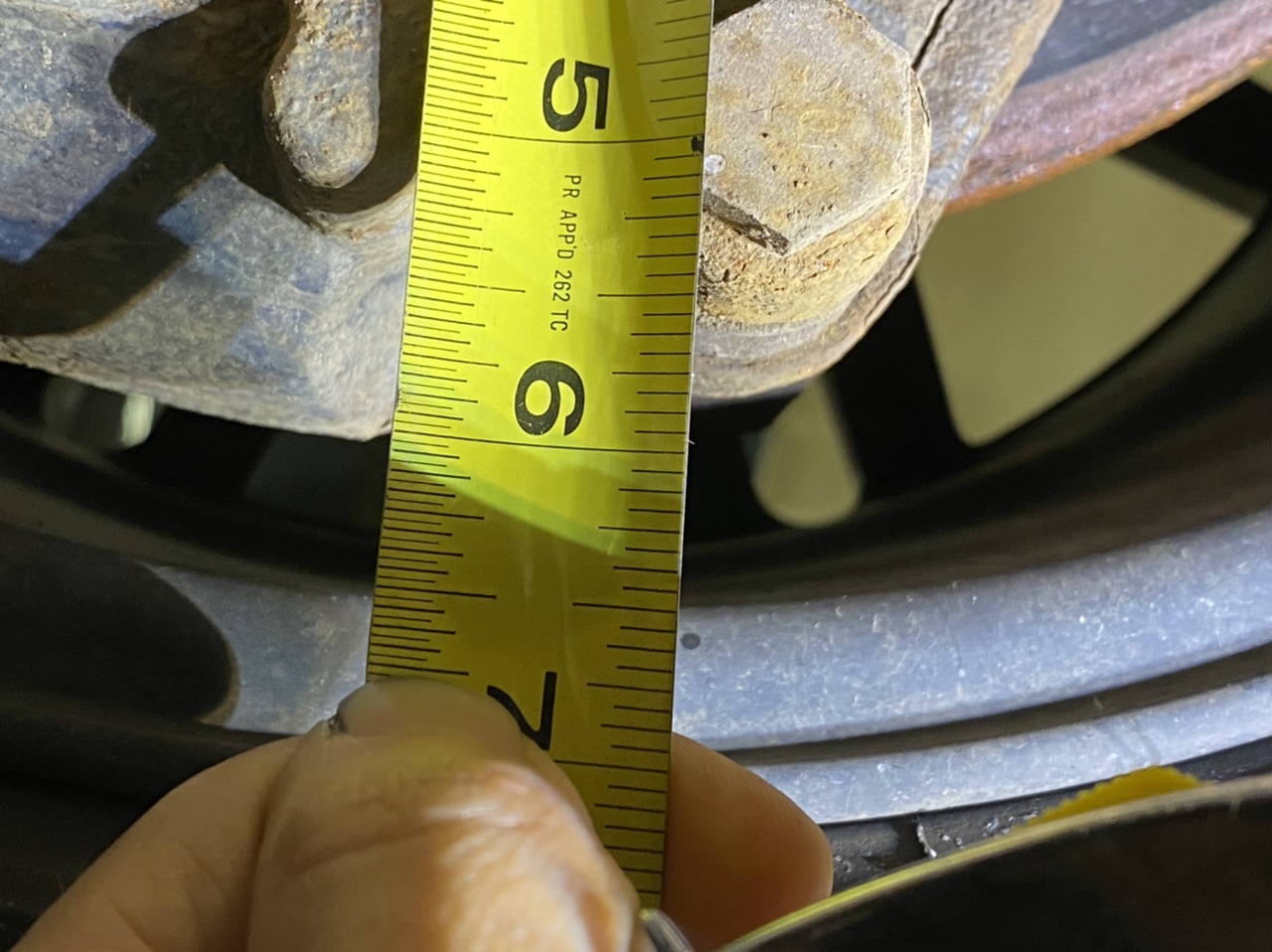

Here’s what I’m working with on the 2007 Yukon Denali and 17” wheels with a positive offset and 2” spacer...
From the axle to the end of the caliper is exactly 6” (doesn’t look like it in the photo, but it is).
Leaving only 0.5” till it hits...
I believe my offset is +20 mm (can’t remember exactly and I forgot to look) and with 2” spacers the calipers are still in the wheel. I reckon those wheels would have about the same offset?
So it all depends on how large your discs and calipers are and how far your calipers go out from the axle.
Hope this helped.

Like Drakon said...you’d need a significant negative offset to clear the calipers.
