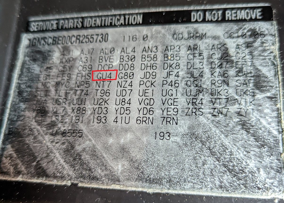

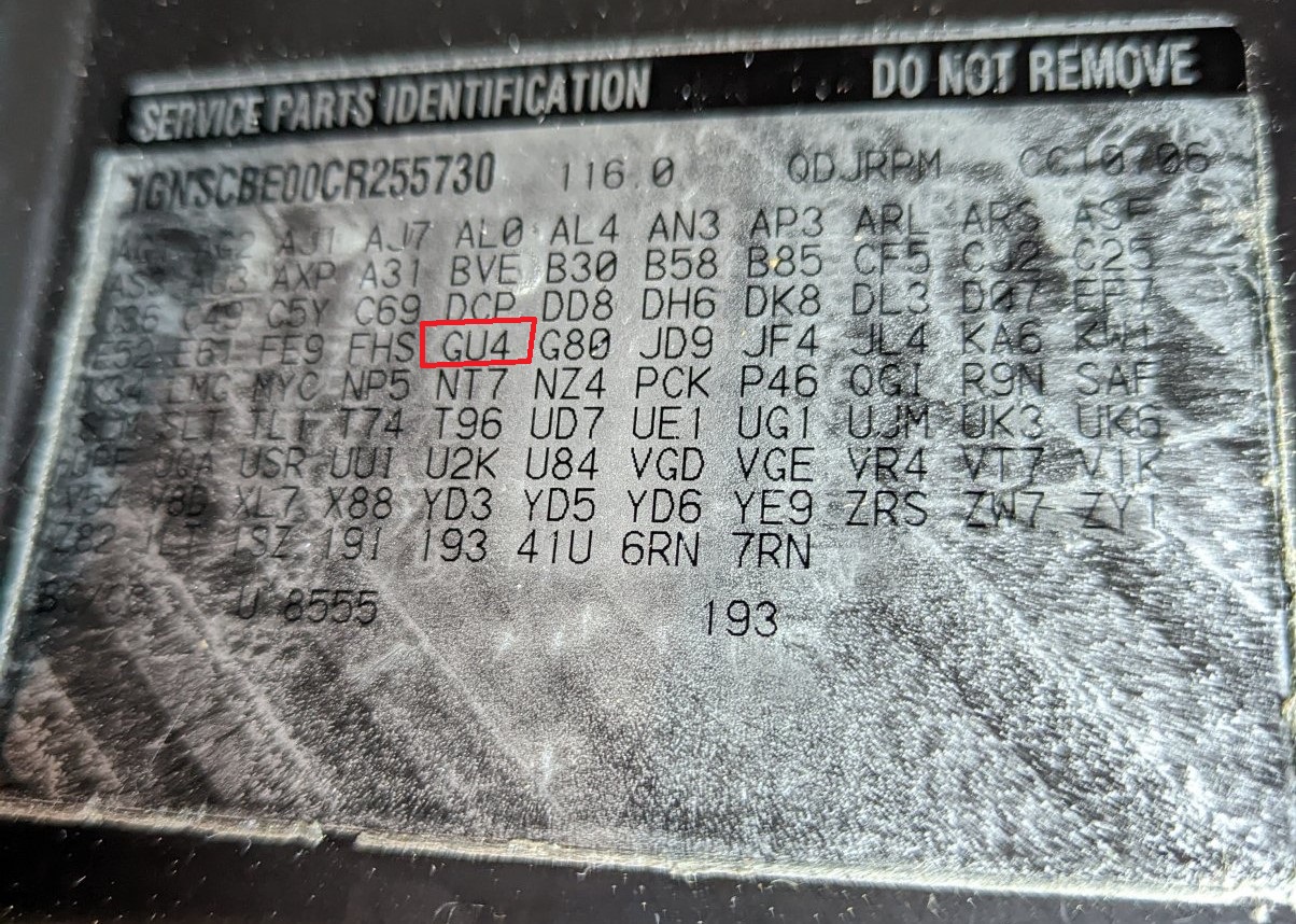

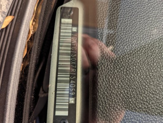

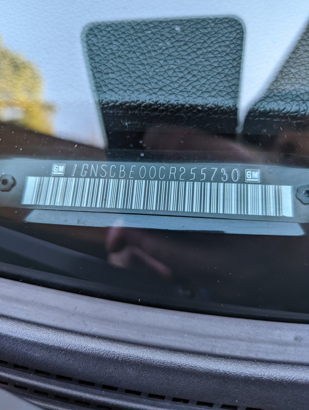

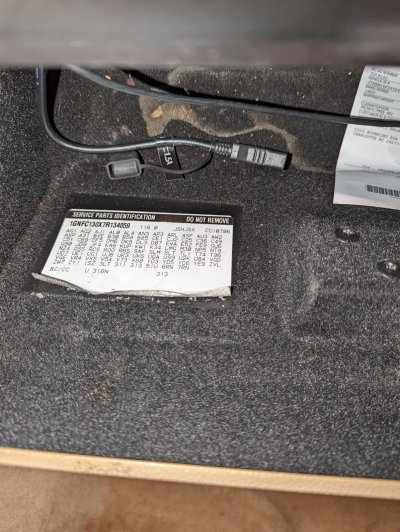

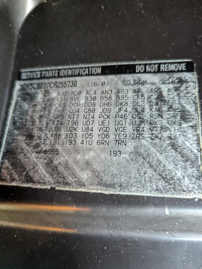

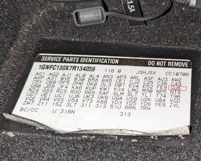

I don't see the G designations. Attaching both the '12 '07 glove box information in that order. Also, I use a Range adapter so it stays in V8 move. What is the "tune" option for gearing?
The 07 will pin you in your seat, the 12, nope. Mpg is about the same. 17.5 hwy on there '12. Would think mpg would be better on the 12.
Thanks!

Your 2007 likely had 3.73 rear gears and I don't think you could get that any more with the 6 speed. The later ones feel more held back to me also, not sure if they did that for fuel economy or longevity of the driveline. Get a tune and it should help that feeling.
Tune?
21,322
30,319
A tune is where a guy goes in and makes changes to the programming of the engine and transmission for better performance and durability based on what you want.
The older truck has 3.42s and the newer one 3.08s. The engine in the older truck does not have VVT, it runs a single pattern camshaft and to me anyway, they "feel" more powerful. Now get a BlackBear tune and put 3.73s in the 2012 and you'll think the 2007 is the old 2012! LOL
