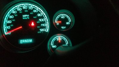

that white on the tip end means the engine is running hot. is it at 212 mosut of the time?
I have had it since November and it has never gone over the midway 210 on the gauge. I wonder if the Hybrid starting more often due to the auto shutoff in traffic could cause that.
i dont think so the water pump only runs with the motor
has the thermostat been replaced. might be stuck open since mine seems to retain the correct temperature .. even with extended period of autostop. .
should be a tad passed the 210F mark at all times when autostop.
have you checked with a code reader to see if it has a pending
P0128 code
P0128 code
I will have to give it a more critical look and see if it goes a tad past. Could I get that code read at an auto parts store with their reader. I do not have one?
snapped a photo in auto stop
edit it
auto stop worked when it was below the 210 spot... but as each day goes on we are still learning how it works
at which point it works etc...
edit it
my understanding is that there are 2 water pumps one that runs on the engine and an electric one for during autostop. That is why there is an extra coolant reservoir under the hood. My autstop has worked with the temp as low as about 170
