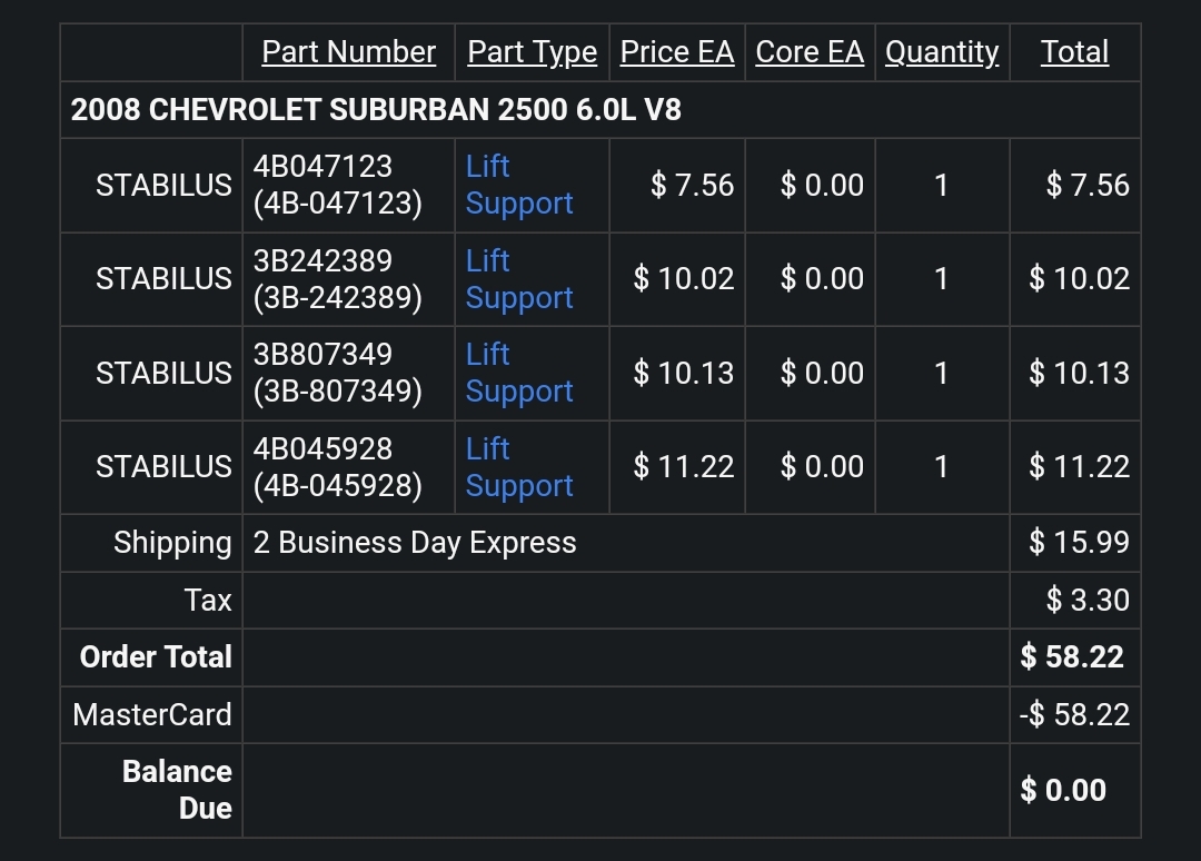

Order the struts for the glass while you're at it. They're cheap. Here's my order from last year - $60 for all four struts from Rock Auto. Stabilus brand - the top name.
