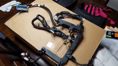

Aint no reason a dadgum car seat should have this many freaking wires in it!!!!

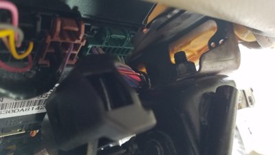

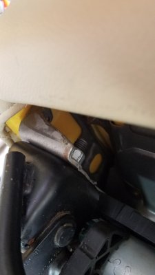

The bad thing is, you CAN'T buy one with out power seats!!!
I did find out if your remove the two 15mm nuts on the front end of the cushion side, the frame pivots down giving you full access to everything underneath...or if you don't remove the seat it would probably tilt back.
