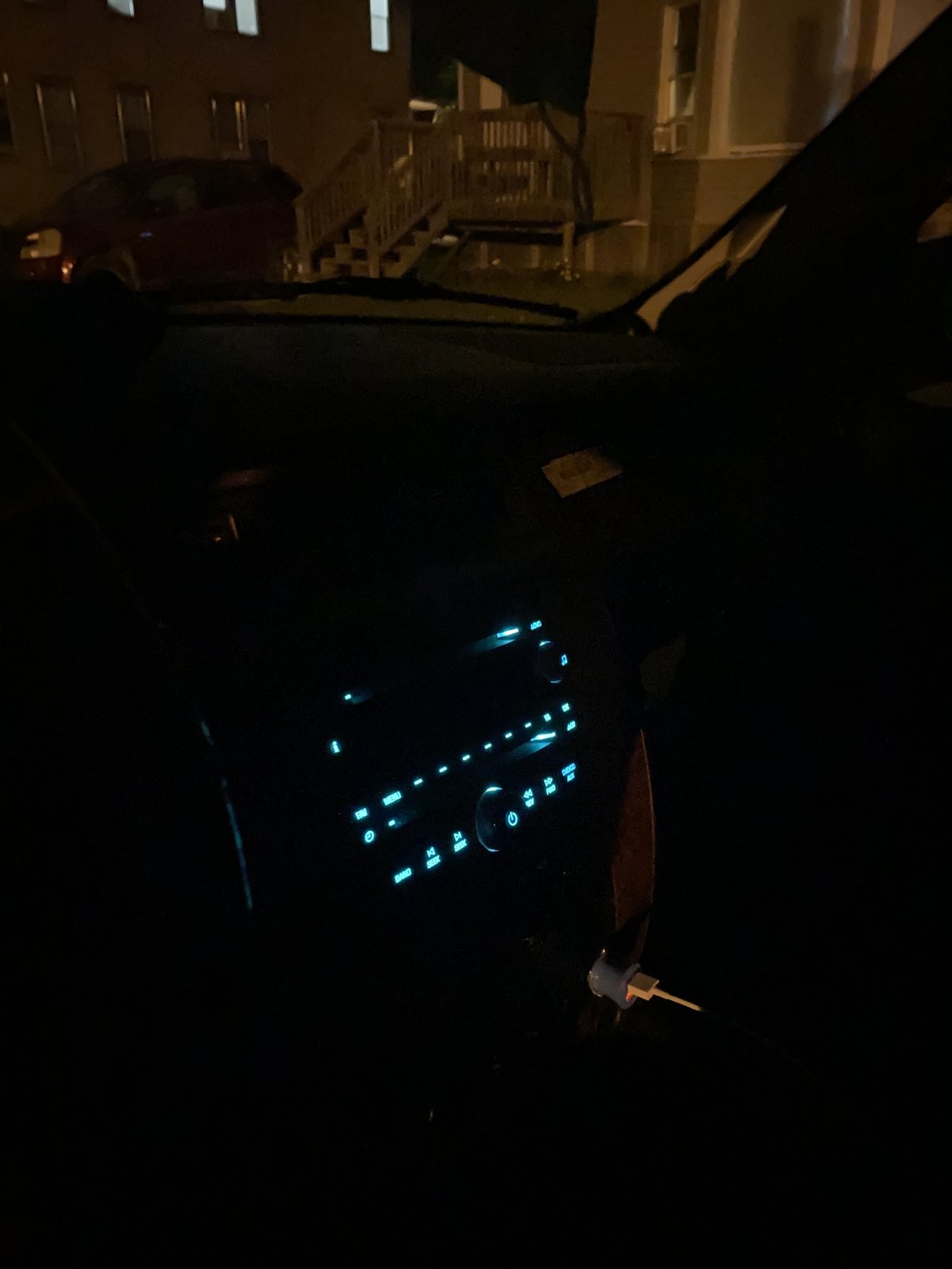

Could you just maybe pull the fuse rather than pulling the battery every time? Having similar issue where my lights on my radio won’t turn off when the stereo shuts down with the car, everything works but the lights just stay on
