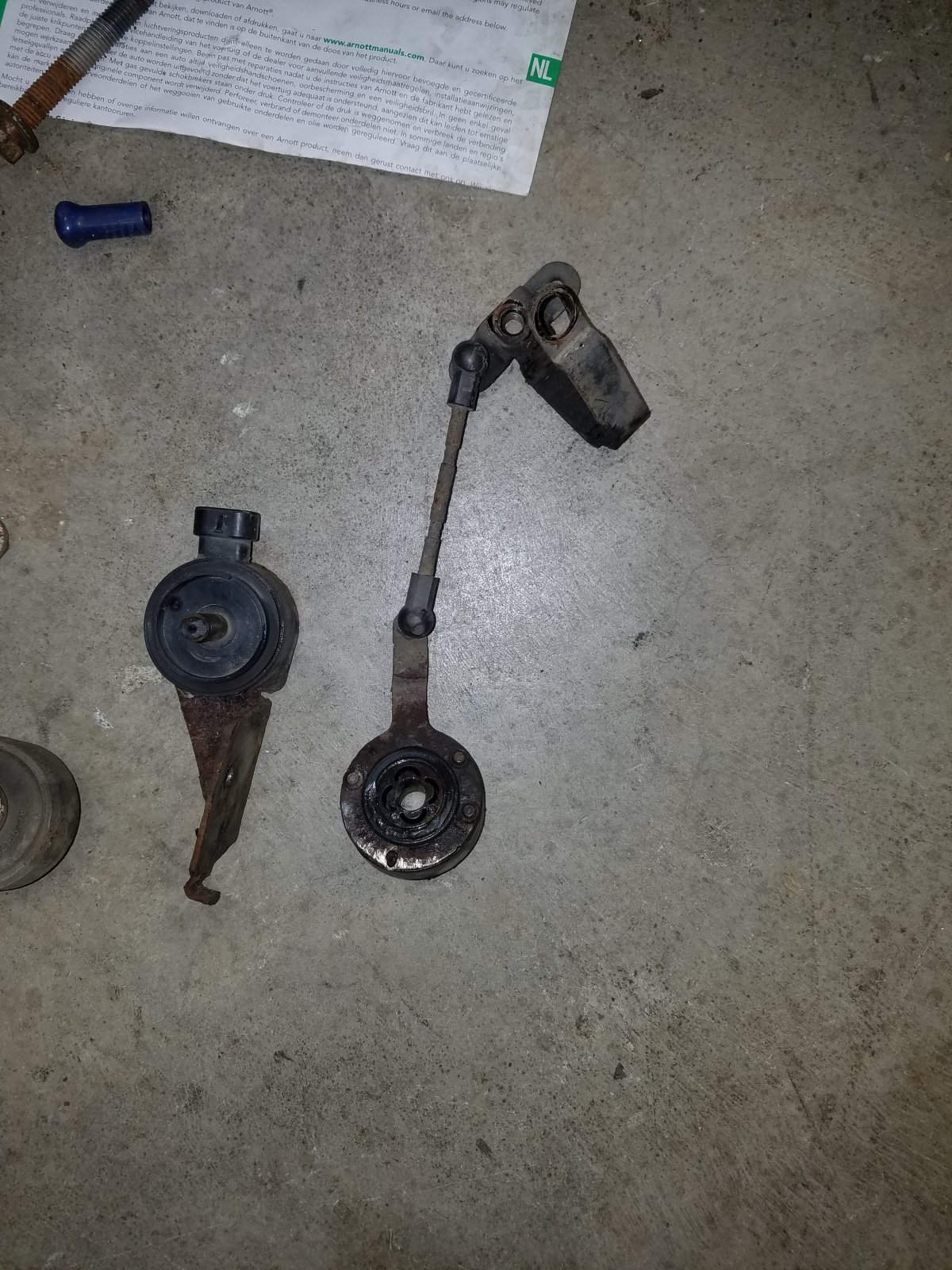

Remembering that it wasn't as easy as I thought I pulled the left rear wheel. Something swinging there caught my eye. Hm. Part of my ride height sensor dangling by its little rod.
I pulled out the fender liner easily (getting good at that too) and took the remainder of the sensor out. No time to get a new one right now so I looked at it and figured out how to hold it together with a couple of washers and a small screw. I quickly wadded up a paper towel and shoved it into that secret pocket. I supported the axle and blew the bottom bolt out, then I figured out how to use a deep well 1/2" drive socket on a ratchet and reached it around onto that bolt at the top comfortable in the knowledge that I wasn't going to drop anything into that pocket. That went well as did changing the spring and reassembling everything including a(nother) new compressor.
