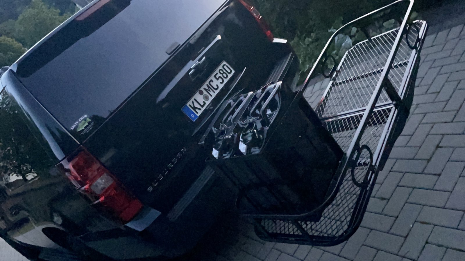

Hi guys ! I am planing a extensive road trip with my 09 suburban, going from Germany through Russia and eventually all the way to Kazakhstan and back, I was hoping you could give me some tips on how to prepare my truck for this adventure in terms of preventative maintenance etc.
It has currently 106k miles on it, this road trip would add about another 6-8k miles through rough terrain
im planing on taking as many spare parts as needed, as parts availability will be more than limited on this trip.
I’ve already got myself a hitch rack that’s going to carry 4 jerry cans of 20 liters and 2 spare wheels.
any tips ?
