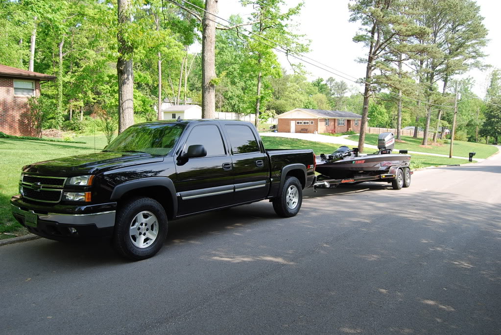

here was the Z-71

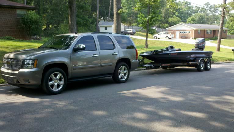

and here is the new Hoe
I'd like the stance of the Hoe to be about the same as the truck...help guys!

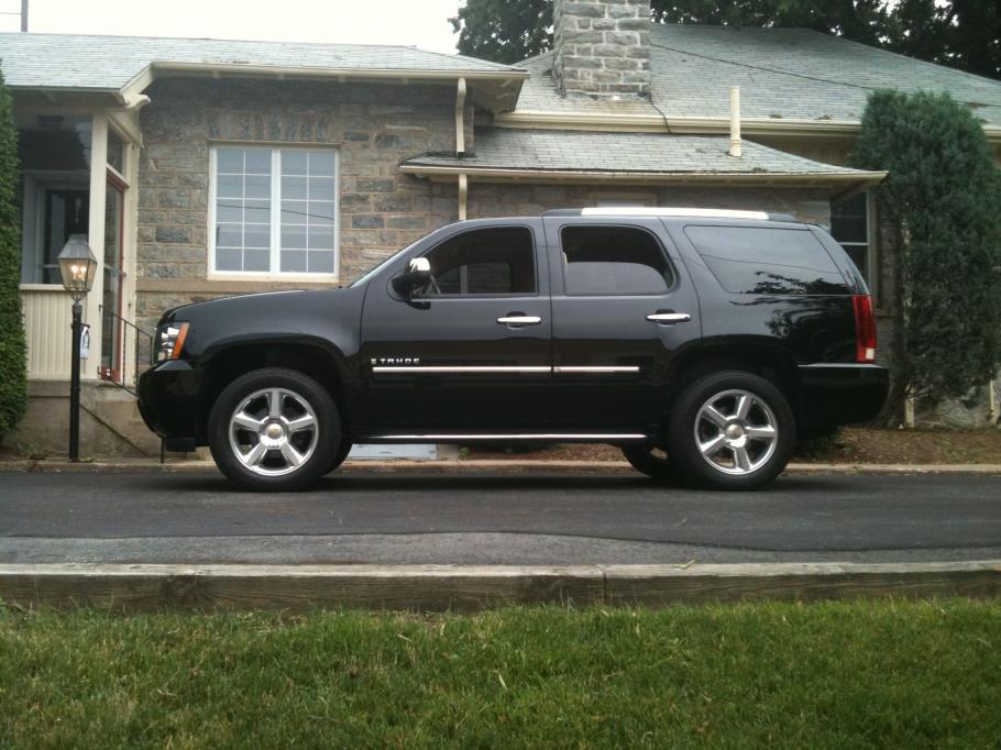

Anyway, here's my truck leveled with the RL front kit:
