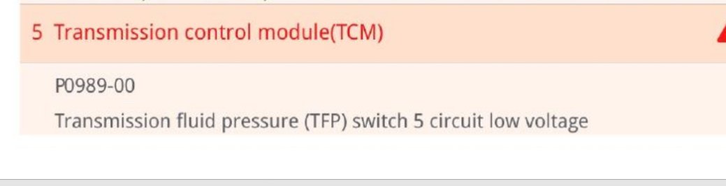

Can you elaborate on those things to do to attempt cleaning? We are getting just the one code PO989-00 which is low voltage on
Campie
May 23, 2025
139
65
Sorry, low voltage on switch 5.
I don't remember specifically, that was a long time ago for my brain!
I might have been referring to the Service Learn Adapts function. Clean fluids ought to clear up the problem. If not, the TECHM or valve body could be rebuilt on your kitchen table and the transmission does not have to come out. Those parts are accessed through the pan.
Brain fog is clearing... I think we summoned Nick's expertise in another thread, didn't we? He's forgotten more than I know about transmissions.

Yikes… That looks like a lot of work! I will watch the videos! We don’t have any problem shifting, driving or towing. It’s just that one code. I’m not knowledgeable enough to know whether the code is a constant or occasional. It’s at the shop now and they are going to investigate the transmission fluid. Drop the pan changed the filter and the fluid 11,000 miles ago, but I don’t know when or if there was a code before that because I didn’t have a scanner then. Lots of fun stuff!
