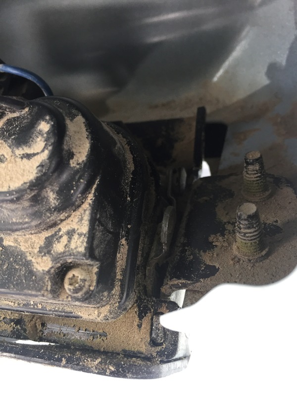

My hatch is standard hatch no auto lift gate, so my hatch just suddenly stopped working. After pulling the rear hatch panel off I knew there had to be a way to open it manually (see pic one)

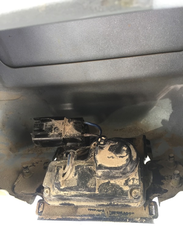

That little notch on the right there is the manual lever. Push forward and it releases the latch. Second pic shows it as a whole unit not so close.
Again on the right or driver side of the hatch. These picks are looking at it from underneath the hatch so it's backwards.
Looking at new stuff can I just replace the electrical part or does this whole piece get replaced?
