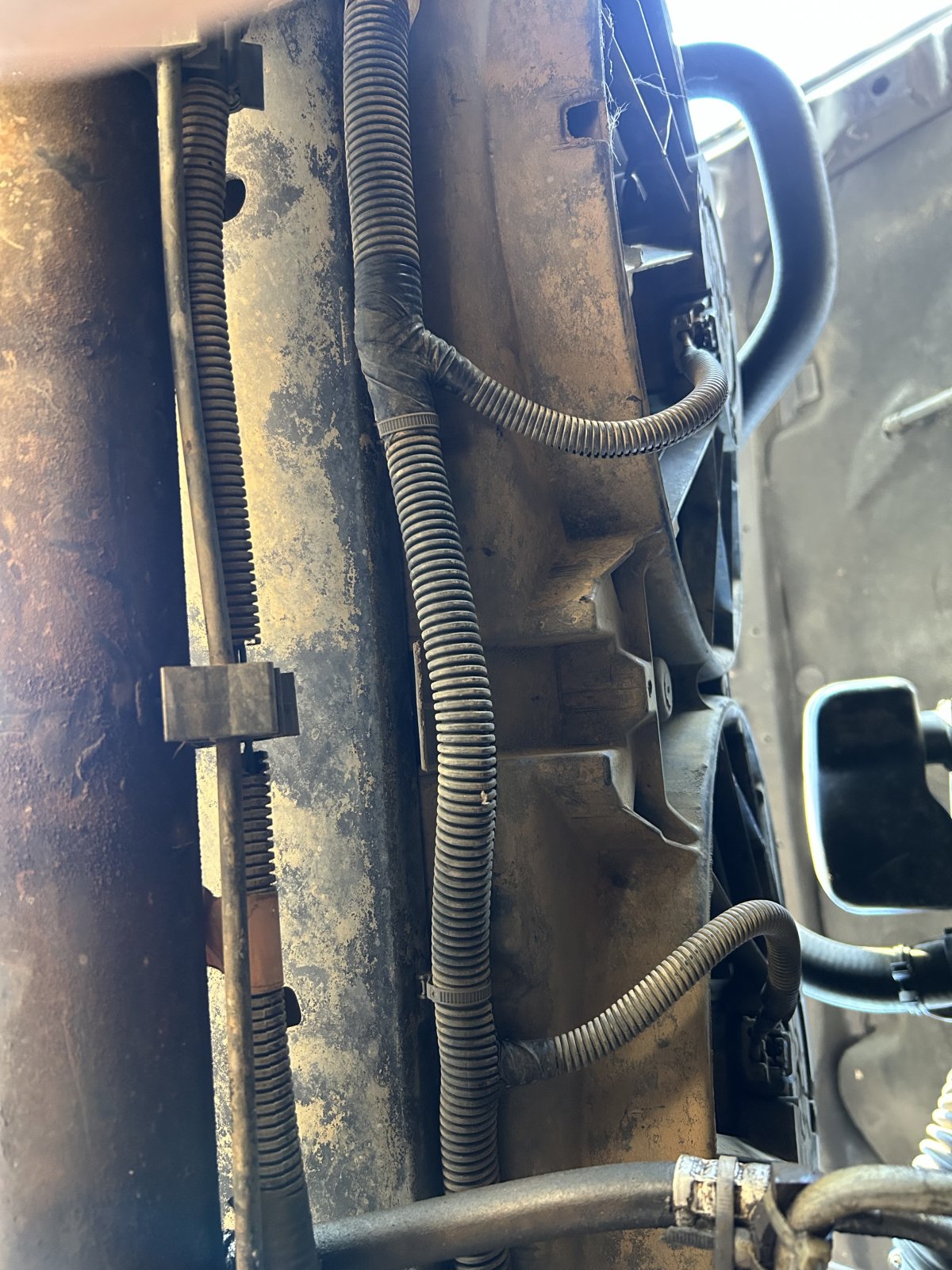

Looking for insight on swapping Tahoe headlights to Yukon. How do I get the headlights to work without the correct connector for them? Have everything else pretty much done except headlights. Any info is much appreciated

Should be able to just swap out the wiring harness for the headlights it should have the same plug that plugs into the main harness under/around the radiator

Ok ima crawl under there and check it out

Get the tahoe end and cut off yours and splice it in. Thats all that's needed if bulb types are the same.

Bulb types different. The harness for the headlights and other miscellaneous sensors comes straight from the fuse box. I got one from a Tahoe and I got it all figured out
