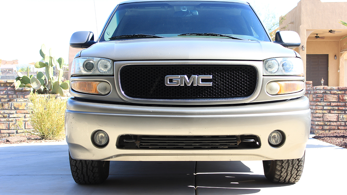

If you’re talking the truck, yes that’s the plan.

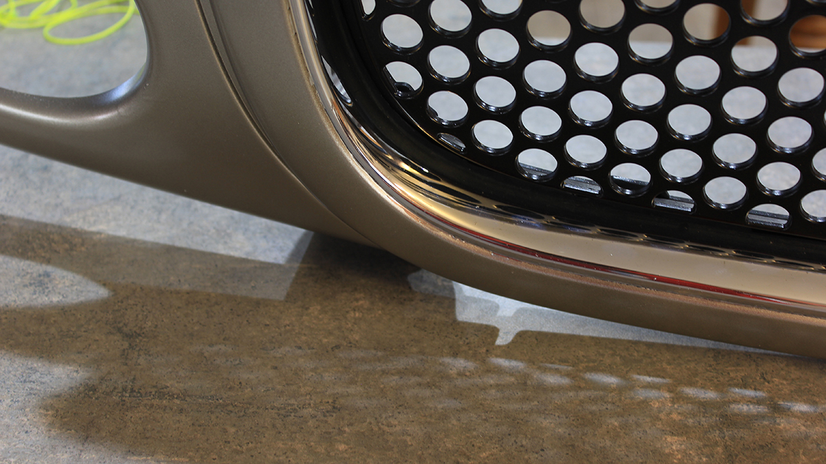

Going to fix the billet grille that’s loose and paint the grille surround. Either all black, or leave the chrome ring like on the obs that guy with the sbm denali did. Now it’s black and blue with a stripe.
Just like this but in black.
Looks awesome, way better than all black.
