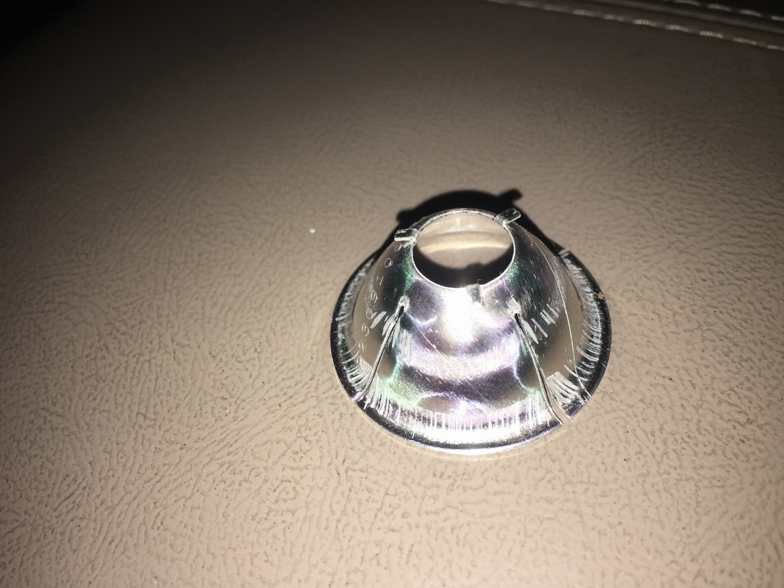

Had to bend the tabs flat then just worked them in from the back, then inserted into the housings.
Way brighter, definitely use the reflectors.

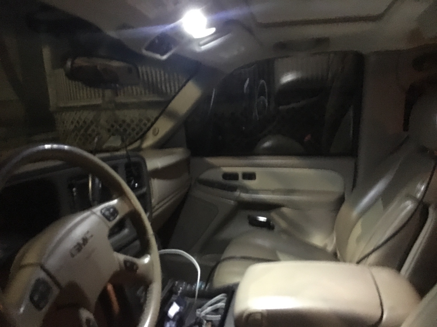

Did the map lights and courtesy lights today.
Gotta order festoons for the dome lights, even though I read like 40 times they needed 42mm festoons I still thought they were 194s.
Looks dumb when the lights come on and the front is 6k and the rears are yellow.

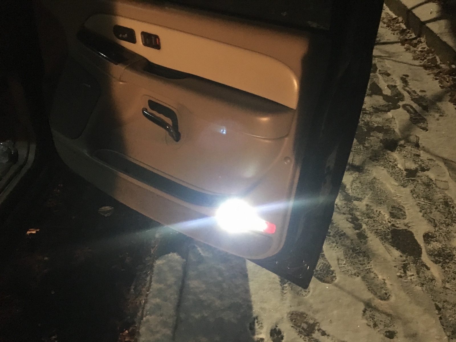

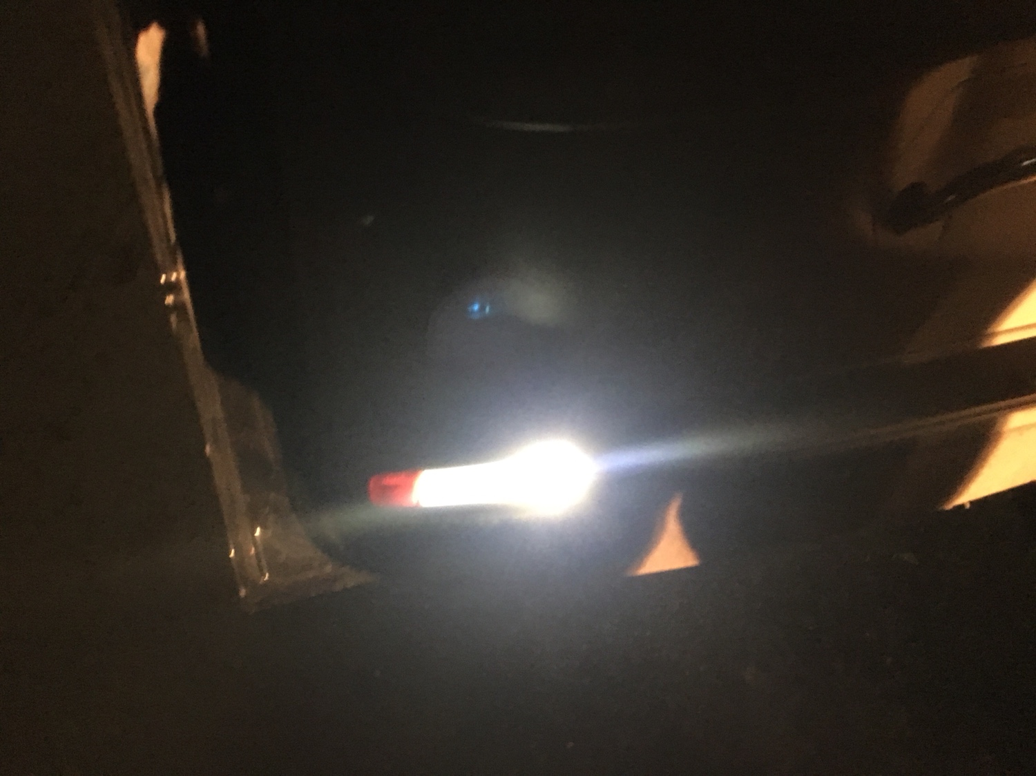

How did you do the courtesy lights in the door?
Popped them out with a flathead screw driver. I gently pried from the red side end, because the other end has tabs on it.
One it’s out, you kind of just wiggle and pull on the black plug, and the bulb and plug come out of the housing and you can remove the bulb from the connection.
I had to shave a little off the opening in the housing because my leds are kind big. There was a very fine lip that a razor blade shaved right off.
Then I just worked the bulbs in, connected the plug again, and reinserted them into the doors.
