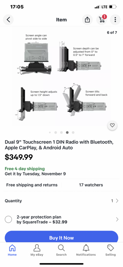

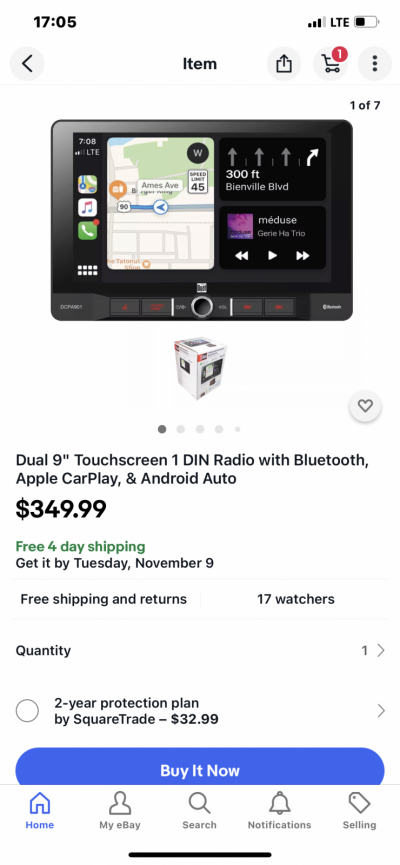

Also this is the radio I’m planning on installing in the tahoe to get away from the stock head unit so maybe this will fix my issue also does the non Bose have a factory amp or is it just a plain radio set up from factory

EDIT: just saw your post i assume you do not have bose. IF you do not have bose, you will NOT have a factory amplifier. Your head unit install will be pretty straight forward.
