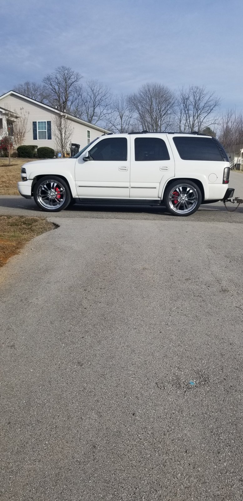

I have mcgaughys drop spindles. Stock keys turned down. The rear I have crown 4 inch drop coil. Spohn panhard. djm rear links and control arm relocation brackets. Had beltech sp shocks just went to bilstein 4600 . Like them better. Except length of rear shocks. and I have 305 35 24
