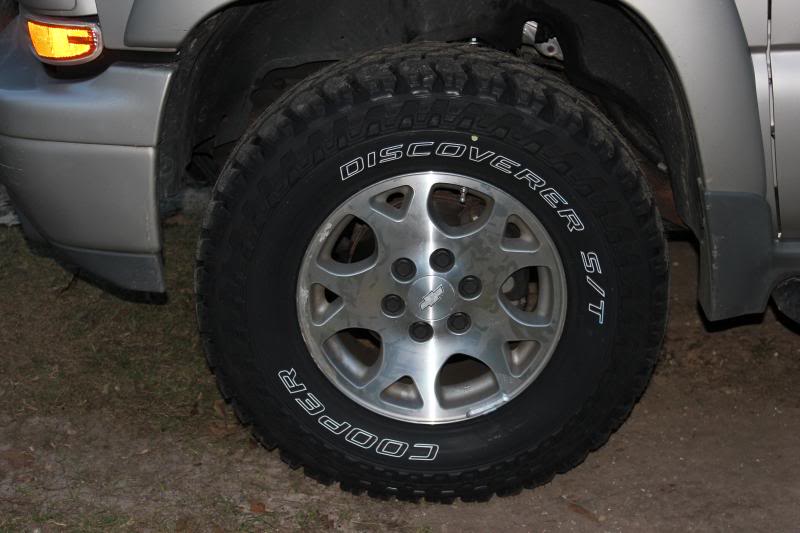

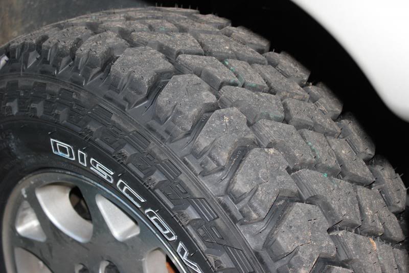

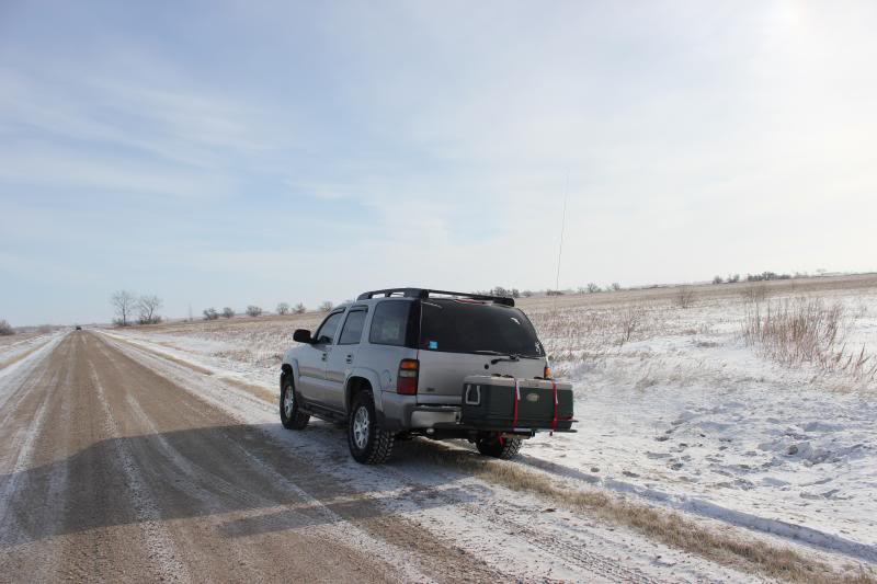

OK, finally put my RC level kit on with shocks. Keys in front, but I didnt add the 3/4" rear spacers as I figured I wouldnt need them for the tires. Went with Cooper ST/Maxx 285-70-17's, for now. The fenders sit right at 37" but I'm still able to get 39" when the keys are maxed out. I have 1.5" rear spacers on the shelf and will go in when I wear these tires out. BTW, I love the tires. Awesome off road traction and a slight hum on-road. Rides smooth as silk, no balance issues at all. Did a 3300 mile trip to Grand Forks AFB North Dakota just after Christmas and the tires performed perfect in the snow and ice. Daytime hi was 16 below and night time got down to 31 below. I ordered 1.5" wheel spacers that will widen the stance. They should be here in a week or 10 days. Here are a few pics.
