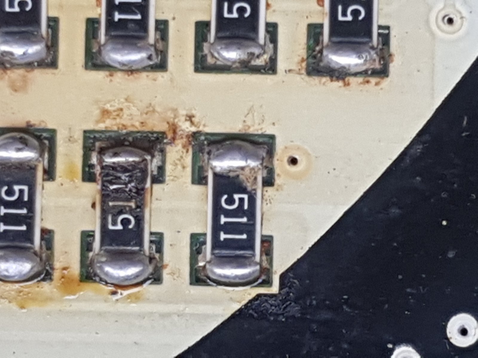

2. Just took the Circuit Board (see image) and hook it up back in the harness plug. NOTE that with only bare circuit board in my hand and connection pins bare without any slot for plug, the plug might connect both order (Up & down). so i made sure that I plugged it in the proper way, for me the grey part of the harness plug stayed on TOP.

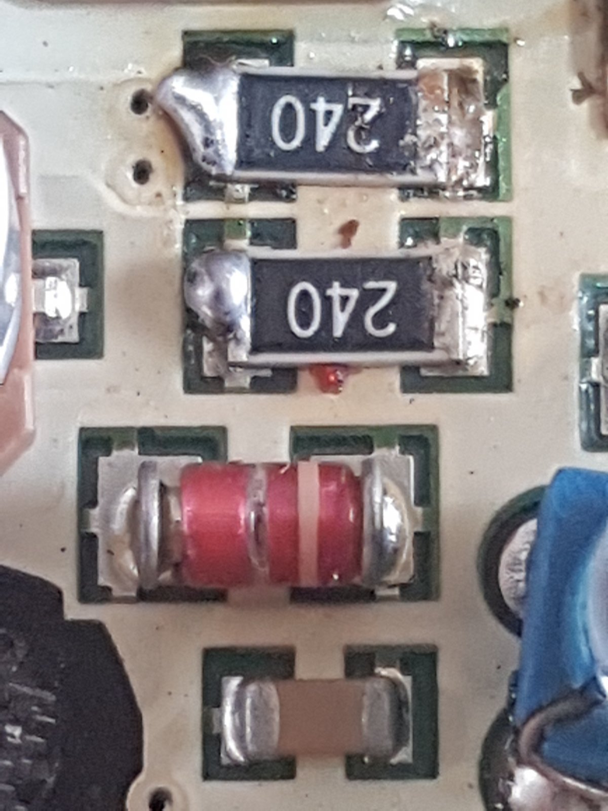

3. With ignition in "ON" (I actually started the car) I gently pressed the circuit board components (mainly rectangle resistors with numbers like 511, 240...etc..) with a non metallic object (I used the eraser side of a pencil). Within seconds I found the culprit resistor. (The panel came to life briefly by pressing the resistors 210..see small red circle in the pics) These resistors get pretty warm during operation and over time the solder develops cracks and hence intermittent loss of continuity which becomes permanent over time. In my case they were the 2 resistors marked 210 (see picture with red circles).
4. I Re-soldered the two ends of these resistors with a soldering iron with a good quality soldering iron with a pointed head and good quality solder. I have limited experience of the soldering process. My soldering didn't look clean (Sucks...Yukk!!) like original but it did the job. All you need is continuity to the Printed Circuit Board (PCB). I took care not to overheat the resisters or circuit board by soldering iron.
5. I also re-soldered few other resistors as mentioned on various other websites. (see picture with red circles)
